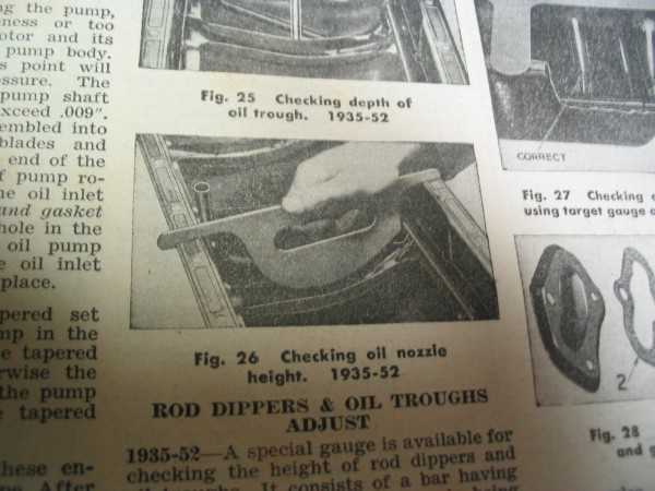

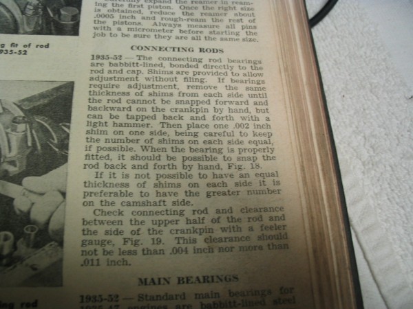

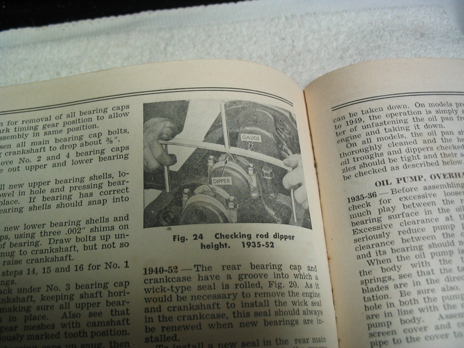

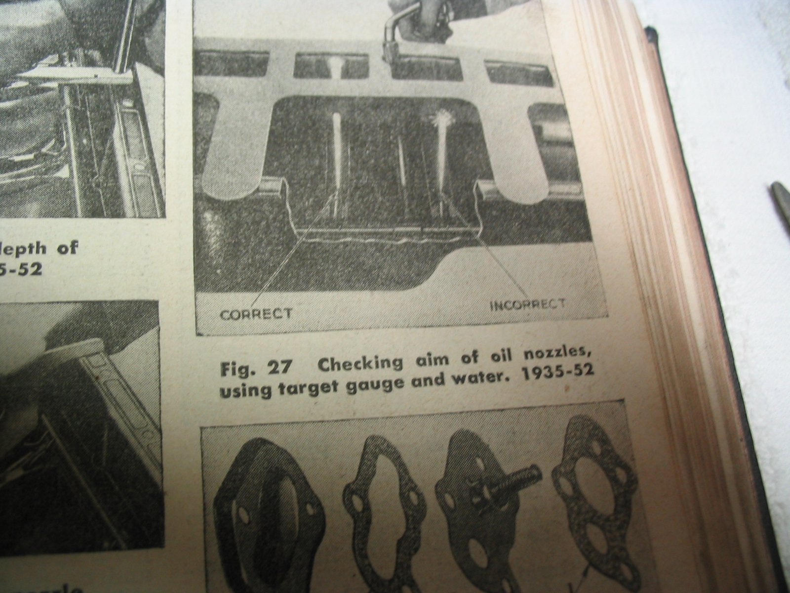

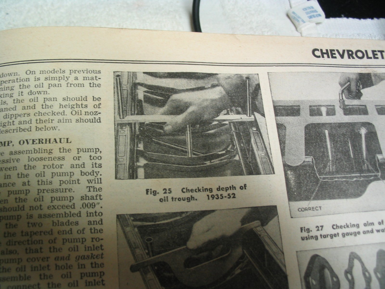

John, I have a lot of experience with the Chevy 216 and insert rod bearings and the stock ones. It still uses a low pressure oil pump.The biggest problem on the 216 is to get the oil spray pipes targeted correctly to spray oil at the dipper. I had to borrow a targeting tool and never found one for sale. With the Model T engine and inserts if you don't use a oil pump you won't get enough oil flow for the inserts. If you use a pump you might as well drill the crank for pressure to the rods fed from the mains, it's not worth pluming for rod spray like a Chevy 216.

Kevin,
Do you know how many degrees of the crank rotation the oil spray set up would hit it's target of the dipper? would it be more than the oil dip of a T ?

Frank, I don't know the target info in crank deg's of rotation, the spray hits the dipper a little before BDC above the dip tray that fills with oil, and would hit the bottom of the rod a little after it leaves the dip tray. The targeting left or right is the more important than up or down a little off so that the dip tray fills with oil on the rods up stroke.
- Posts: 144
- Joined: Sat Jan 26, 2019 3:12 pm
- First Name: Herman
- Last Name: Kohnke
- * REQUIRED* Type and Year of Model Ts owned: 1914 Roadster, 1922 Coupe
- Location: Clare, Iowa
- Posts: 132
- Joined: Sun Jan 06, 2019 6:30 pm
- First Name: Kevin
- Last Name: Matthiesen
- * REQUIRED* Type and Year of Model Ts owned: 1926 Coupe, 1921 speedster, 1925 TT, 1916 Exp
- Location: Madera California
Re: INSERT ROD BEARINGS--LONG TEM REPORT?
Thanks Herman for the pictures.
