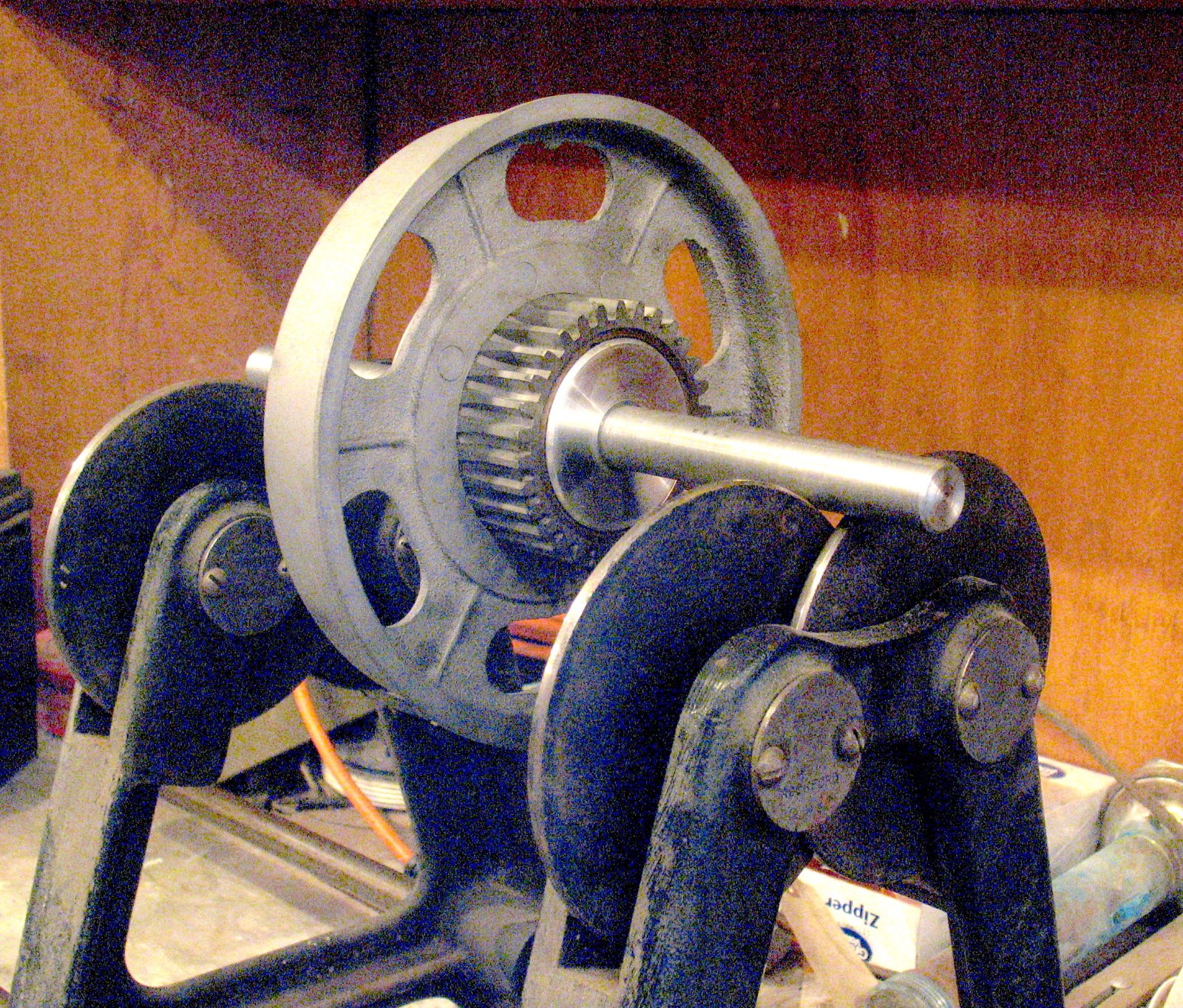

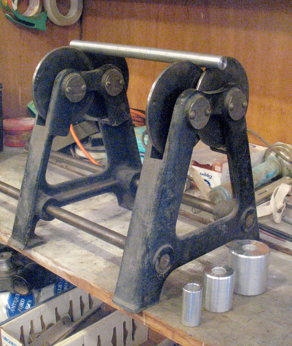

Post by Steve Jelf » Tue Jun 18, 2024 11:34 pm
I bought mine off a trailer for $90. I love auctions. :D

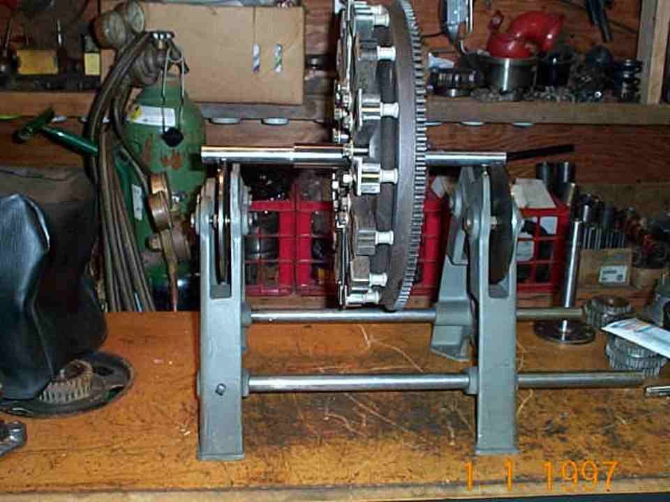

If you use two transmission shafts as your mandrel, The required clearance drops half the diameter of the shafts, so you likely only need 7" of clearance.
One of those balancers would be nice. I made mine with a piece of heavy steel channel for the base and four steel uprights carrying two 14" power hacksaw blades as straight edges. The back edge of the blades was ground down close to a knife edge. The flywheel is mounted on two transmission shafts. The whole is set up level on a benchtop, and the flywheel allowed to turn as it wants. My godson put one of my balanced flywheels on their special dynamic balancer once. It took I/8" deeper in the same 1/4" hole I drilled to make it better, so I was pleased with that.

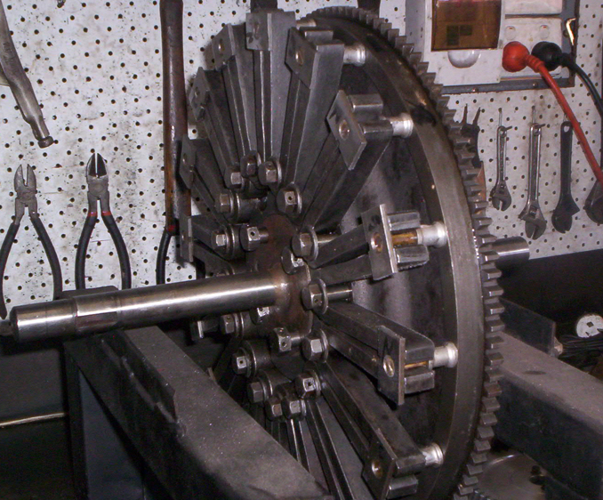

Finding one would be nice, but like Allan, make do with what can be made from scrap.

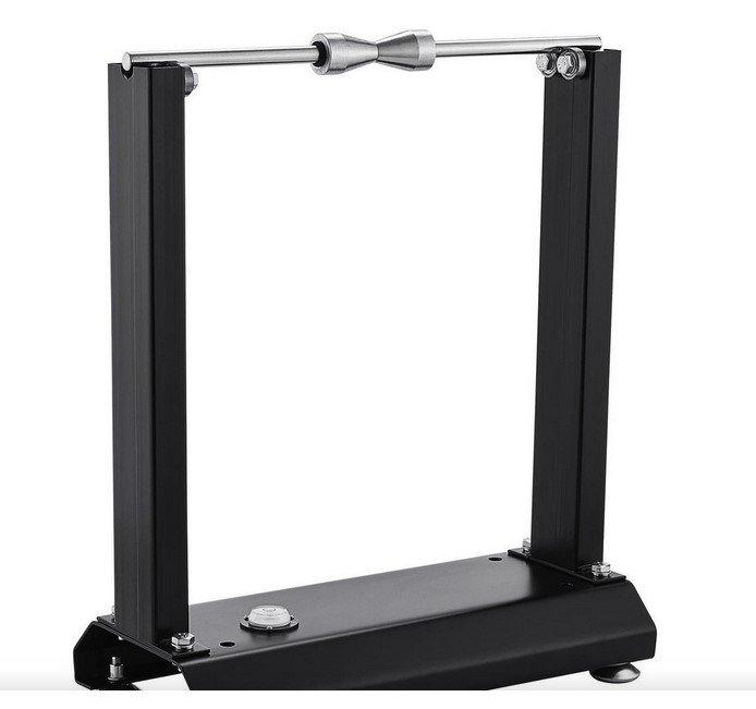

Has anybody tried this one from Harbor Freight? Its only $44.00

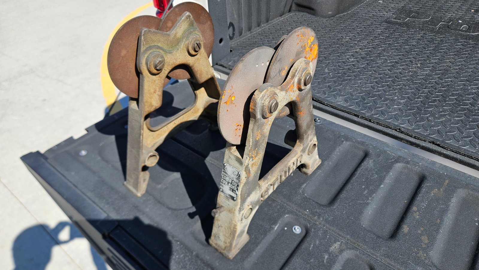

Success! I was outbid at the silent auction, but the buyer is a friend of mine and he sold one of the balancers to me for $50. It was a great deal and will accept up to 21" diameter.

John, Id steer clear of the HF unit. A guy I know purchased a balancer with small whels and it doesnt have the sensitivity you need.

I have used the Harbor Freight one for balancing transmission drums.
I haven't tried a flywheel yet.

Mark yours is made by the Stuhr, the top name in static balancers. The price of new ones is thru the roof. You probably know that already. Mine is a knock off but works ok. It takes 1/8" diam steel ball bearings. Changing them out increased sensitivity
