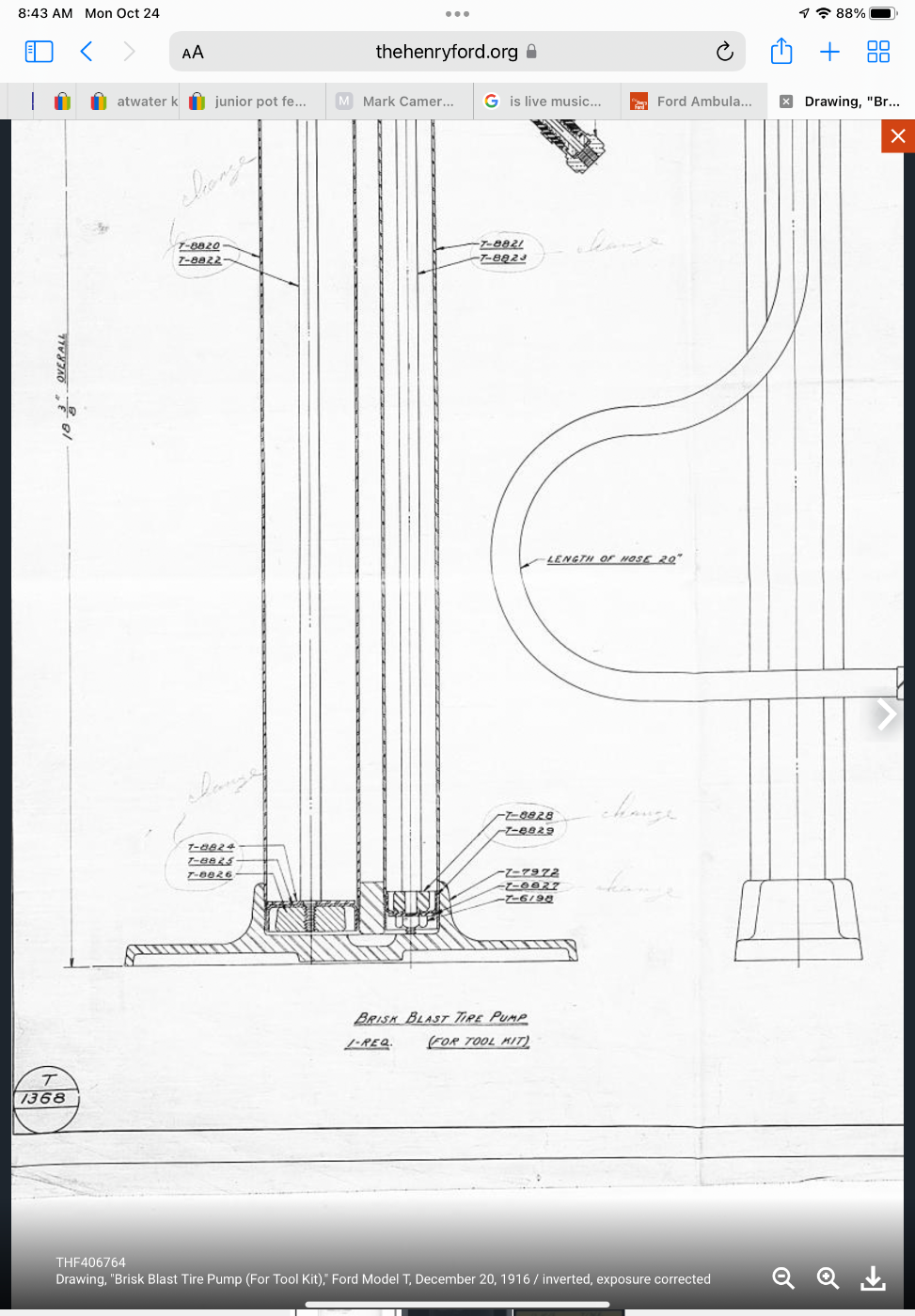

Ford used the Bridgeport aoelis pump until 1915 when the aoelis improved model began to appear in the parts books. The improved model is marked as such on the top and is assembled in a slightly different manner than the aoelis model. The “Brisk Blast” pump was also supplied by ford per blueprints i have found in the ford archives. Ford specified that these two-stage pumps needed to deliver 60 psi of air pressure. The earliest aoelis pumps had varnished handles and brass plated top and bottom castings. The lower casting was painted red after 1909 and the later improved models had handles painted in red as well. I was told years ago that aeolis was the name for the greek god of wind. Not sure if thats true.

The brisk blast documentation was a surprise to me as well. We often assume that what is shown in the parts book illustrations is the only model used and it is often not the case. Brisk blast pumps have a 45 degree outlet for the hose so are not the ones used in the parts book illustrations. I may have dated the use off the improved model from a factory numbers document rather than a consumer price list of parts. The factory number books tend to carry much more detail. The single tube pumps may have coincided with the introduction of balloon tires which require much less inflation pressure.

Post by 1915ford » Wed Jun 19, 2024 10:14 pm
See photo of factory blueprint.
