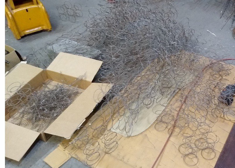

So, I tried to take the mattress & box springs, steel only, to the scrap yard a year or so ago and I was denied.
Then I got the idea to repurpose it as a seat - that looks like a fail.
Problem solved...cutting it up to stuff the springs into some other scrap metal container and be done with it. I'm sure there is a word for that but it's no longer a mattress.

If I dump out the plastic bag mine are stored in, they would come out in a clump like that photo!
