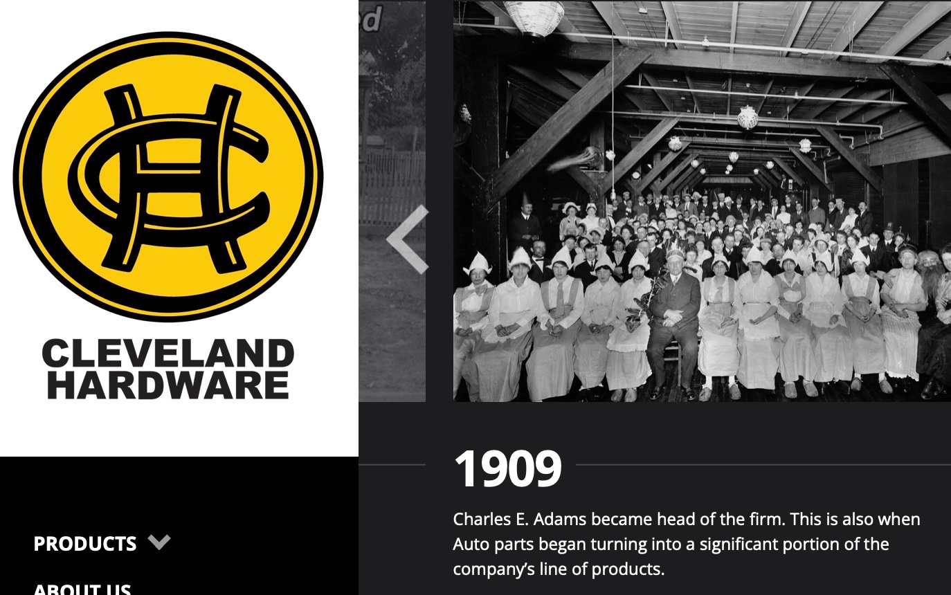

While Daisy is a March1914 build, the left hub is a 1910-13 variant. Also, cast with a "GHC" Logo... CH? I tried doing a search but came up empty....anyone confirm? Possibly a Cleveland Hardware??
The right hub being a later "Ford" marked hub.

That early hub with wide threads can be suspect to cracking so inspect carefully.
Yes the forging mark is Cleveland Hardware
Company still in business, other info from post by T. Boggess.
