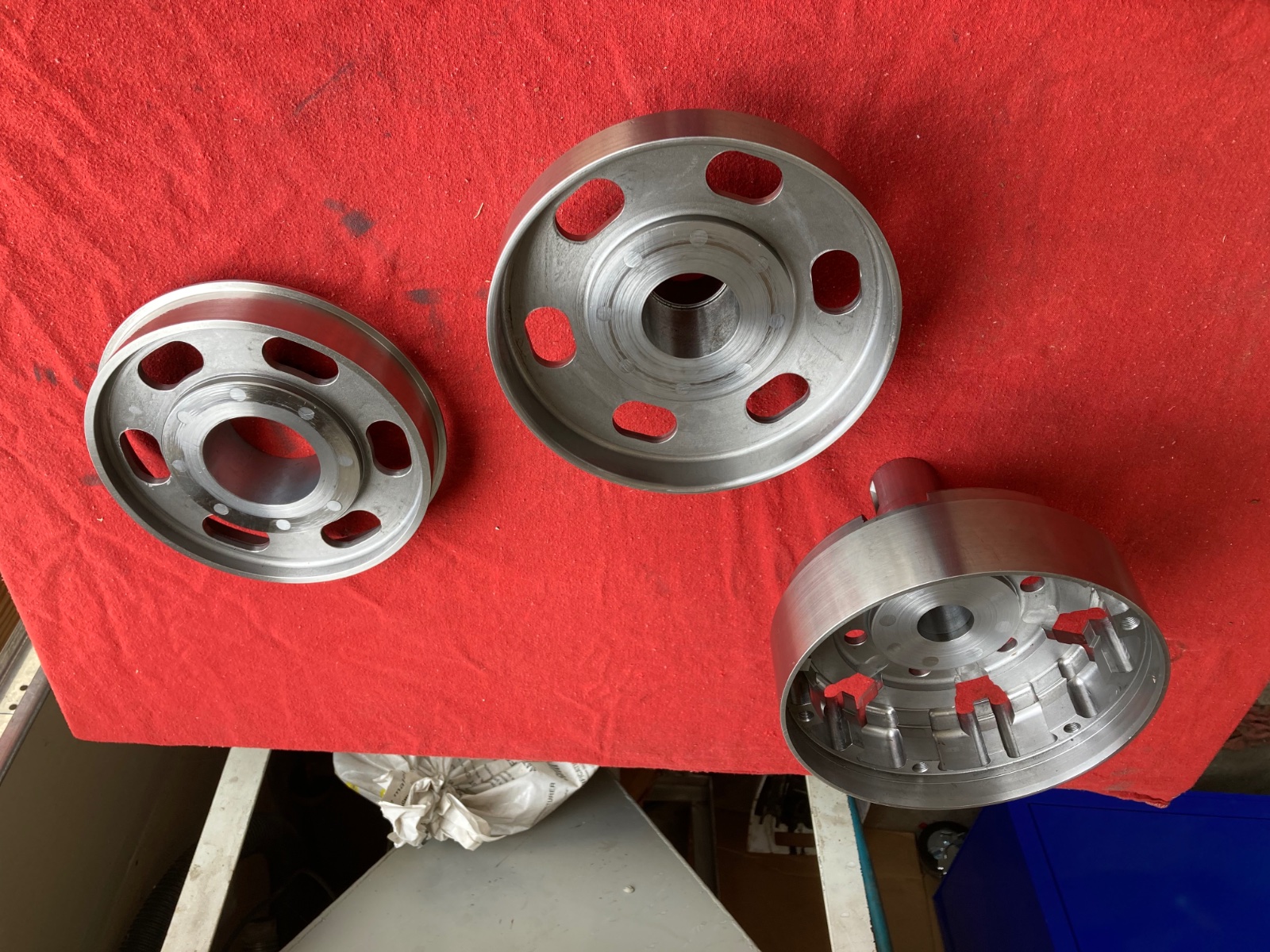

Just received my new drums from Dave Nolting. They are pretty sweet.
Andy
Andy

I almost made a big mistake of buying new high priced drums when I learned of Dave Nolting drums. Took a big hit cancelling my oreder and switching over but sure glad I did.
Great drums and great value providing great performance for the last 3 years with Kevlar bands. Thank you Dave!

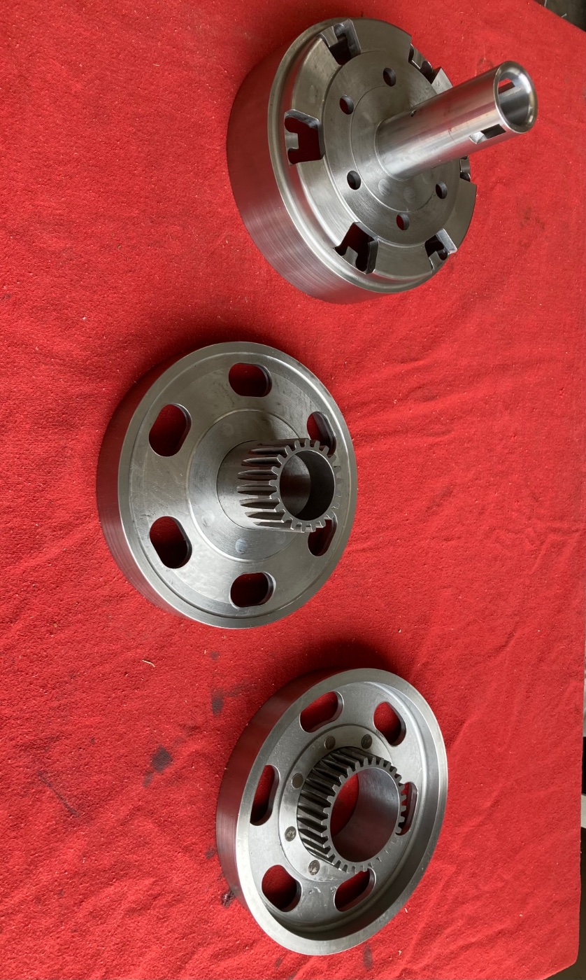

In the process of putting together a complete transmission from Dave. All new parts from the Scat crank flange, to the u joint. Changing to needle bearings nine gears and new pins. This is the second set of drums from Dave in another car and the quality is superior. I highly recommend his drums and also the main trans shaft he produces. Good price as well!

Yep, I went with Dave's percision made Trans shaft as well and very pleased with performance and value. Don't waste your money on over priced alternatives in MHO.
