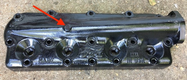

This image was posted a while ago of a low style Reeder head, the Reeder heads are easily identified by the round casting sprue on the top.

For your viewing pleasure.

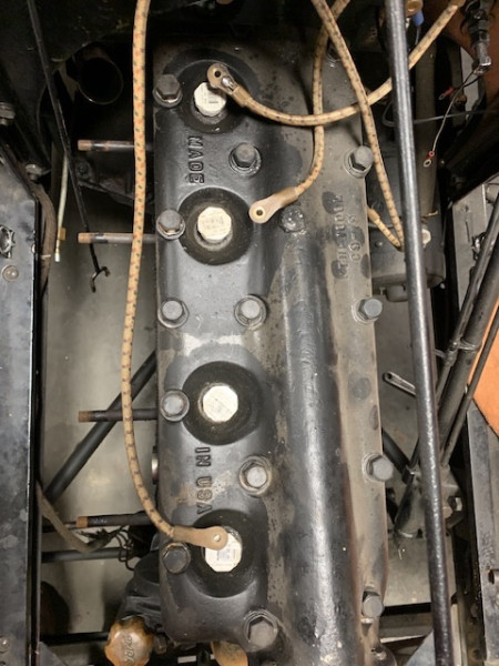

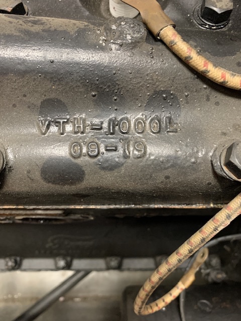

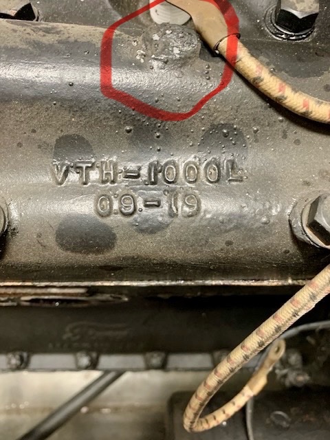

I just worked on a High Reeder Head that did not have the REEDER around the water outlet.
