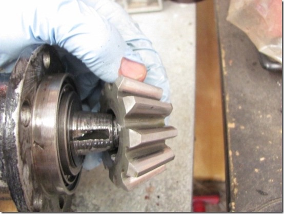

Have removed an 'adjustable' version, and didn't reuse it, as the adjusting shims (shown hanging ) really just push the pinion gear off the the taper of the drive shaft to obtain some mesh. IMO the shims meet no real need.
Gear worn shaft from being loose, note shims over the modern bearing.
IMG_7981 (600x450).jpg (110.26 KiB) Viewed 2448 times
Prefer to use without shims, can assemble easy and fit ring and pinion regular way.
