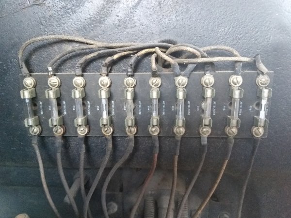

Fuse picture Model T_resized (1).jpg (61.88 KiB) Viewed 2155 times
Photo #1 Ten circuit period after market fuse block.

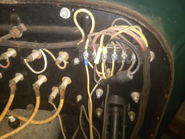

# 2. Inline 20 amp main fuse connected to yellow main power lead going to battery side of starter switch. Much easier to get to without crawling under the car on tour or pulling the floor boards in the dark. Makes it easy to disconnect battery from non starter circuits when working on the car.

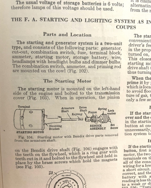

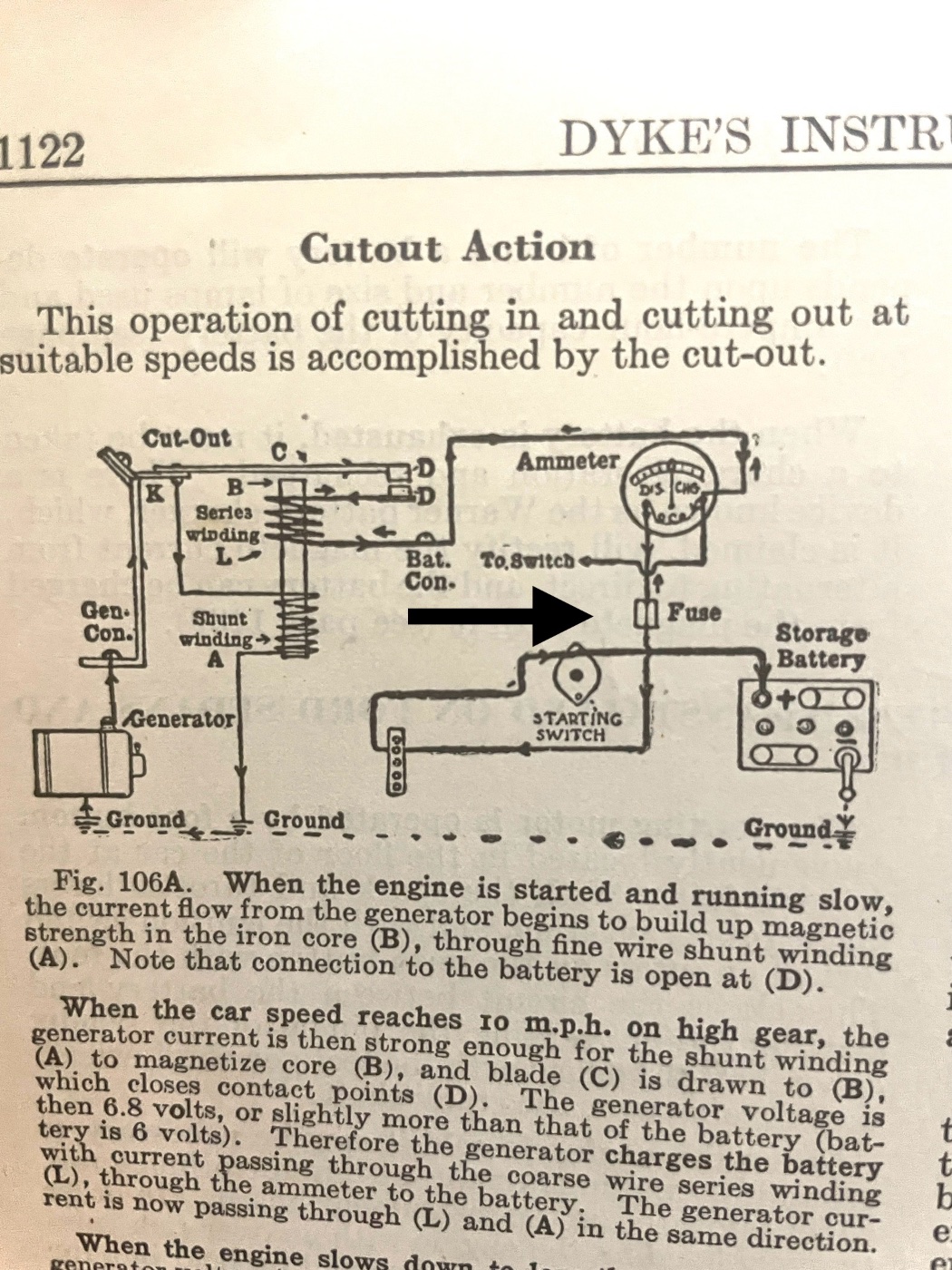

Seems according to Dykes Automobile Encyclopedia the first application of the Fred Ames 2 unit starter and generator used a fuse! Perhaps when Ford got going on this system the fuse was eliminated, but reason today is to add one for safety sake. ;)
