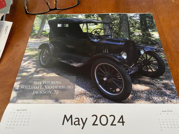

Post by Will_Vanderburg » Tue Jun 25, 2024 5:02 pm
I painted this car with a foam roller. But..,that’s the look I was going for.
William L Vanderburg
