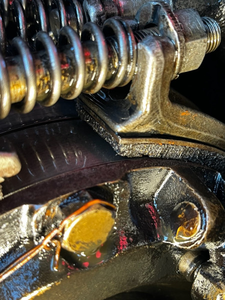

Came across this picture of questionable material used for band lining...... Woven textile, kevlar, wood, modern auto trans molded ???????
Lining material ?
Lining material ?

Pretty sure it ain't Kevlar. I'm voting for wood even tho I've never had any experience with wood bands

Looks like there might be a faint glimmer of a few copper strands… that would make this Model A brake lining. Word on the street is this stuff is hard on drums. Others may have personal experience…

Looks like caterpillar band lining material that was popular in the 1970's.
Felix Graves promoted this and sold to several people. My 21 RPU is running this

Kevin, same thought, looked like brake band material to me

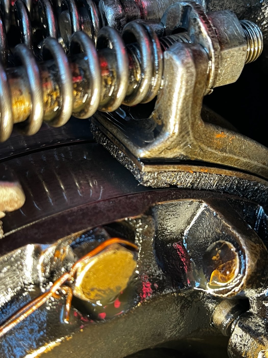

All three bands as found

With what appear to be angled saw cuts on the edge, I would guess it is an oil soaked wood band. I don’t think such saw cuts would exist in softer band material. Also, the lack threads or frays indicate it is not any kind of woven material.

That brake band looks mighty thin...I'm assuming your plan is to change 'em all out anyway and just wanted to show these first.

I ran some of that hard bonded lining back in the 60's. Its was hard on the drums. I changed to Kevlar when it came out. I still have the set up on a shelf. I have not had success removing the bonded stuff from the bands.

You can probably get a pan big enough to hold all three bands and get a gallon of strong solvent such as MEK, Acetone, or Xylene and pour it over the bands and just let them sit until the linings fall off. Covering the pan to make it as air tight as possible would slow the evaporation of the solvent.

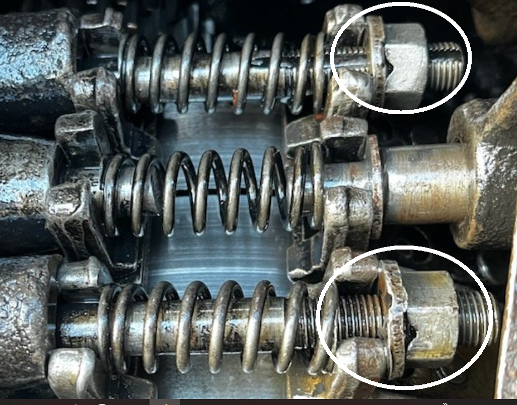

Did you do this while checking the bands or was it already that way?

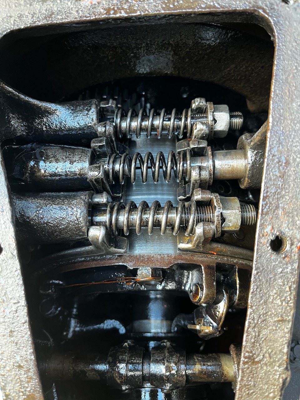

The picture shows what we saw when the inspection cover was first taken off

Obviously you need to address the non locking detent situation.

Previous owner did not know about the locked position of band's adjustment
