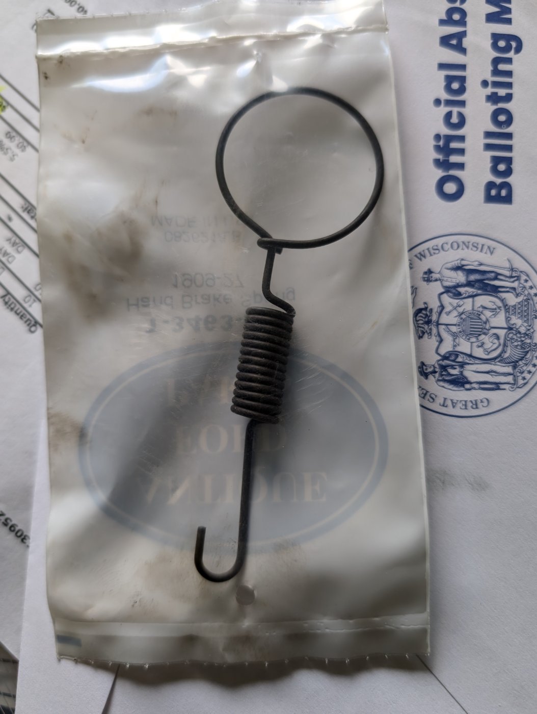

I got this spring. I thought I had a picture of where it goes, but I cannot find it.
I am not sure how it attaches to the brake. There is a hook hanging down from
the hand brake lever. Either the circle goes in the hook or the hook goes through
the other hook. But then where does the circle go?
I currently have a temporary straight spring with a hook at each end, with one hook
attached to the hand brake hook, and I have the second hook wrapped around the
brake clevis, but I know that is not correct either.
Thank you.

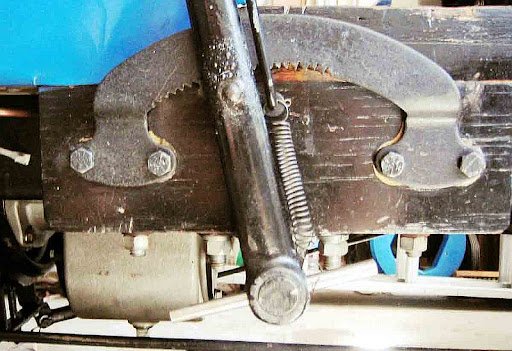

Post by CudaMan » Sat Jun 29, 2024 6:35 pm

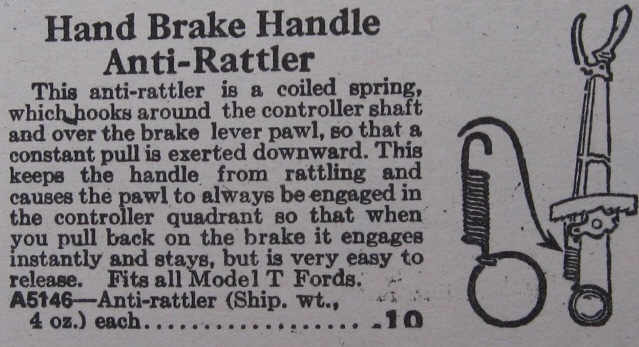

jiminbartow
Posts: 2478
Last Name: Patrick
Location: Bartow, FL
Re: Hand Brake Spring attachment???
Post by jiminbartow » Sat Jun 29, 2024 8:12 pm

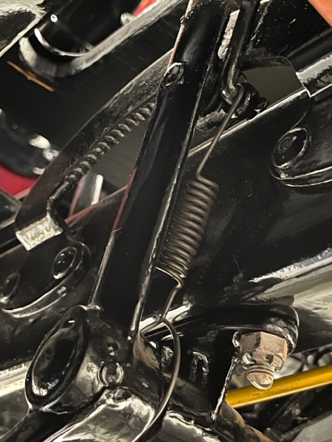

Post by Rod » Sun Jun 30, 2024 6:29 am

Excellent photo. Thank you all for all the help.
