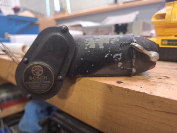

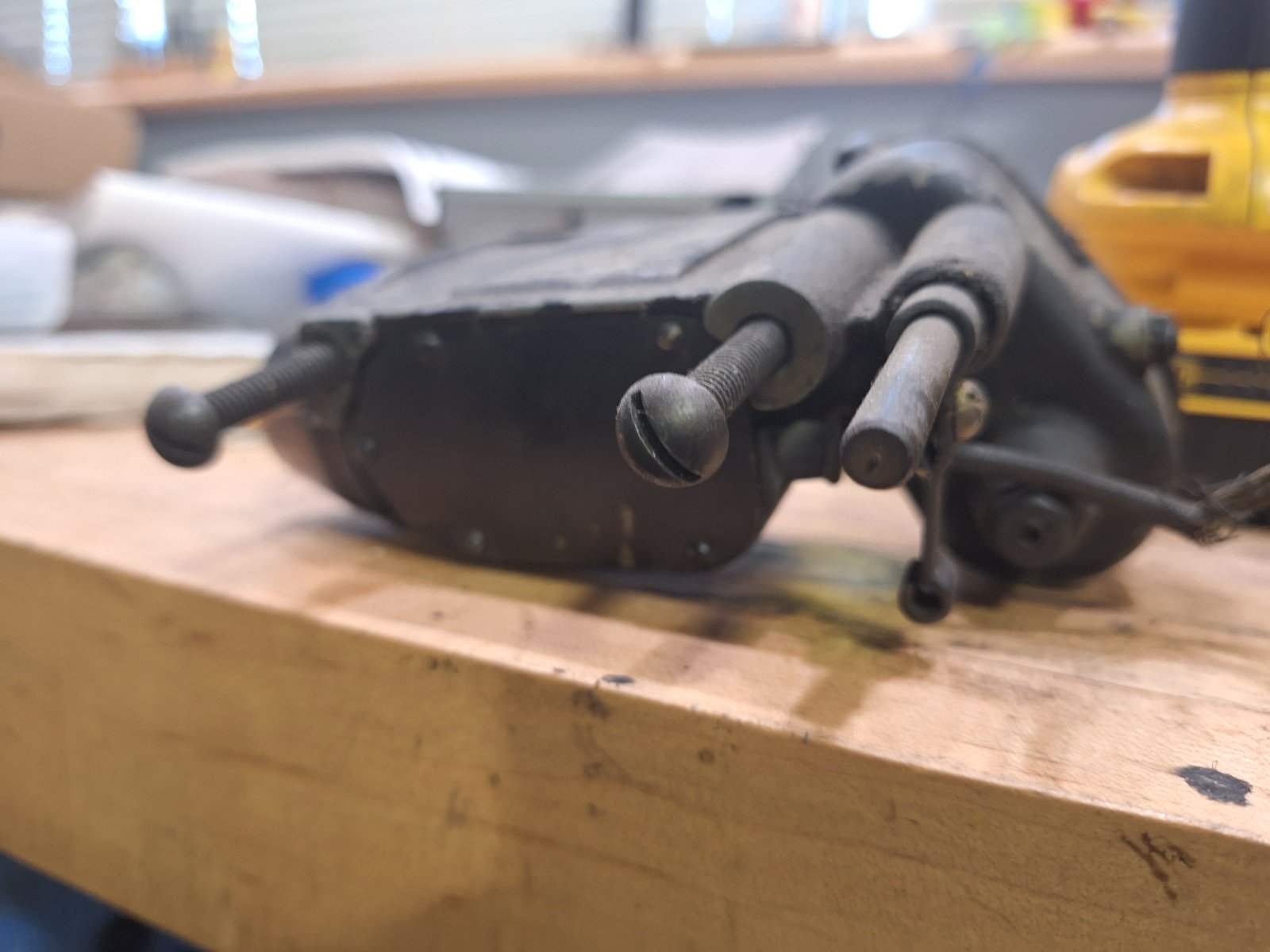

Yet another possibility. Bosch made a 6volt wiper for the Ts.

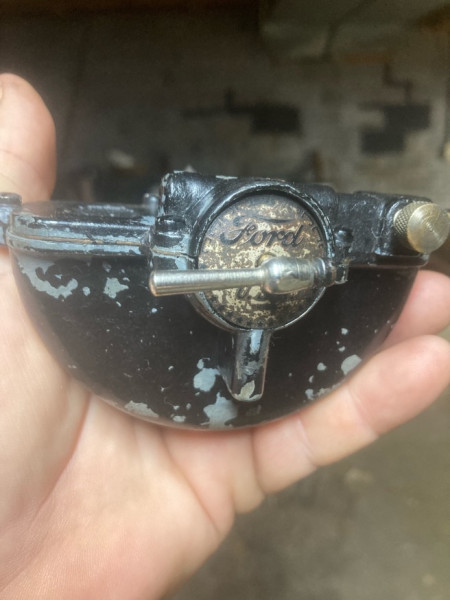

Original Ford 1926/27. I’m guessing this was a Dealer item? I’d love to get it restored and put on my 27 Roadster.
