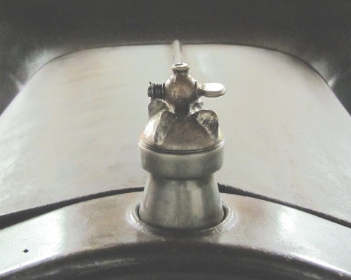

Got nice new nickle radiator cap that I hate to paint OD green for my WWI ambulance project. Have older painted cap that I would prefer to use, but someone has drilled a very small hole right at the top. Either to let off steam, or to allow air into the system or to mount something. Can I use this cap as is? Presume I can JB Weld up the hole if needed. But the fact that it has a hole already, I'm thinking about a small eagle or statue of liberty flag topper on the cap for parades.

More than likely someone drilled the hole because the overflow tube was blocked. If you are going to paint it, solder the hole closed or do as you suggested, add some sort of mascot to the cap.

Yes, the cap has to be snug with the gasket as Ford supplied, but better results to keep coolant in the radiator is to use a modern plumbing rubber seal for $1.78 at ACE Hardware.
Plug that hole or add something, if left open coolant will spit out that hole. Be sure to seal the stem of what you add with o-ring or gasket otherwise you will have spits and spots on the windshield or spits and spots of hot coolant splashed on your face at road speed. :shock:
