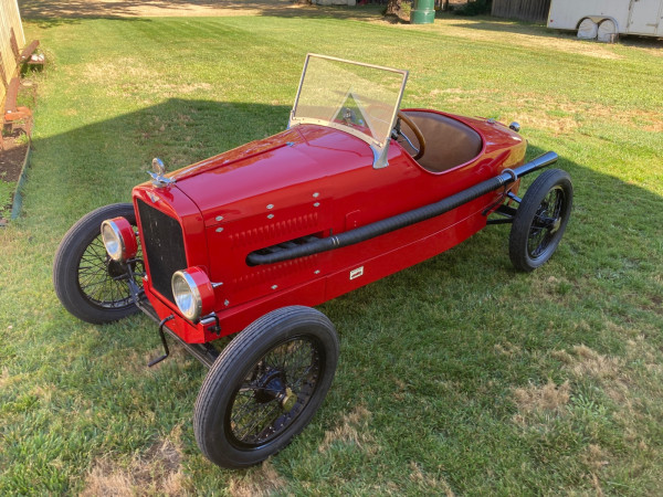

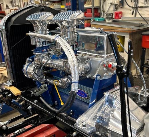

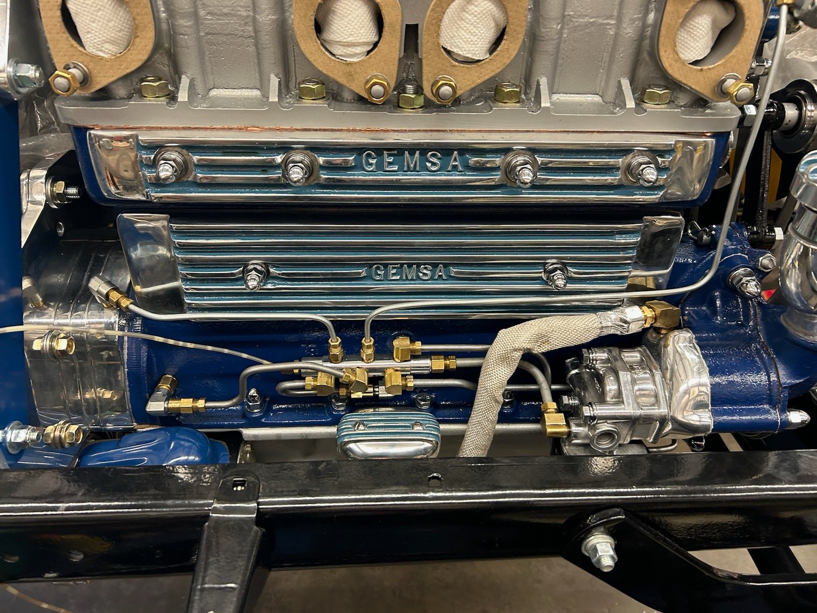

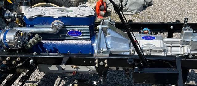

One of the many gone( as in off line not dead yet) but not forgotten Model T contributors put this together.
Again only sharing what is possible and not gonna debate like the 1909 T purchase.

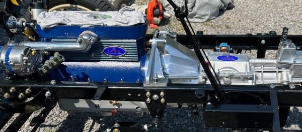

M1 real class,
Dry clutch using a SVO Mustang bell housing, clutch pressure plate, etc.
Tremec T5 transmission
Open driveshaft

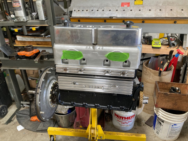

Engine block bored to .060
Skat crankshaft
Custom built A rods
Special pistons
1.5 go 1 rockers
Full oil circumference oil delivery to rods via mains, injection to timing gears, rear cam bearing, rocker arm shaft.
Shy of 11 to 1 compression
Anything modern is free game, ie, as long as no frame boxing, real steel body, engine block is T, front axle, rear axle housing, hubs, period correct wheels and hubs. 1939 rule book! Interesting history, no cut off date was ever listed! If you have the money to stuff, modify, etc let it go!
160 hp at 203 cubic inch displacement @ 4,400 rpm.
Frickin Wow factor!

I must agree that his talents are at the highest level among us mere mortals.
Posts: 903
First Name: Austin
Last Name: Farmer
Location: N.W. Illinois
Re: While you were bickering on the forum...
Post by 1925 Touring » Thu Jun 27, 2024 5:38 pm
Wow! That is really something!
big2bird
Posts: 730
First Name: Jeffrey
Last Name: Hausey
Location: Anaheim, Ca.
Post by big2bird » Thu Jun 27, 2024 6:02 pm
Orville Enaurht? Had a 09 or 10 with a pinto engine and c4 tranny.
tdump
Posts: 1430
First Name: Mack
Last Name: Cole
Location: North Carolina
Post by tdump » Thu Jun 27, 2024 6:11 pm

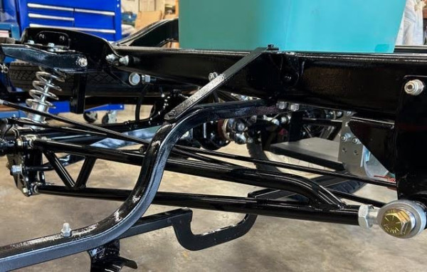

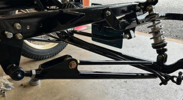

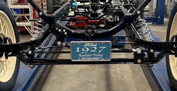

No boxing the chassis? How does it stand 160 hp??
But that is more like art instead of something you drive
Posts: 7309
Post by Allan » Thu Jun 27, 2024 7:36 pm
Beautiful work, a real eye opener, admirable in the extreme, but it is a hotrod, not a T, in MHO.
AndyClary
Posts: 910
First Name: Andrew
Last Name: Clary
Location: Usa
Post by AndyClary » Thu Jun 27, 2024 7:53 pm
Let’s not throw hot rod labels around.
Andy
Dan McEachern
Posts: 1512
First Name: DAN
Last Name: MCEACHERN
Location: ALAMEDA,CA,USA
Post by Dan McEachern » Thu Jun 27, 2024 7:54 pm
Post the dyno sheet.
Post by Norman Kling » Thu Jun 27, 2024 8:15 pm
Does that have a T rear axle assembly? What about brakes? That car would scare me.
RVA23T
Posts: 853
Last Name: C
Post by RVA23T » Thu Jun 27, 2024 8:33 pm

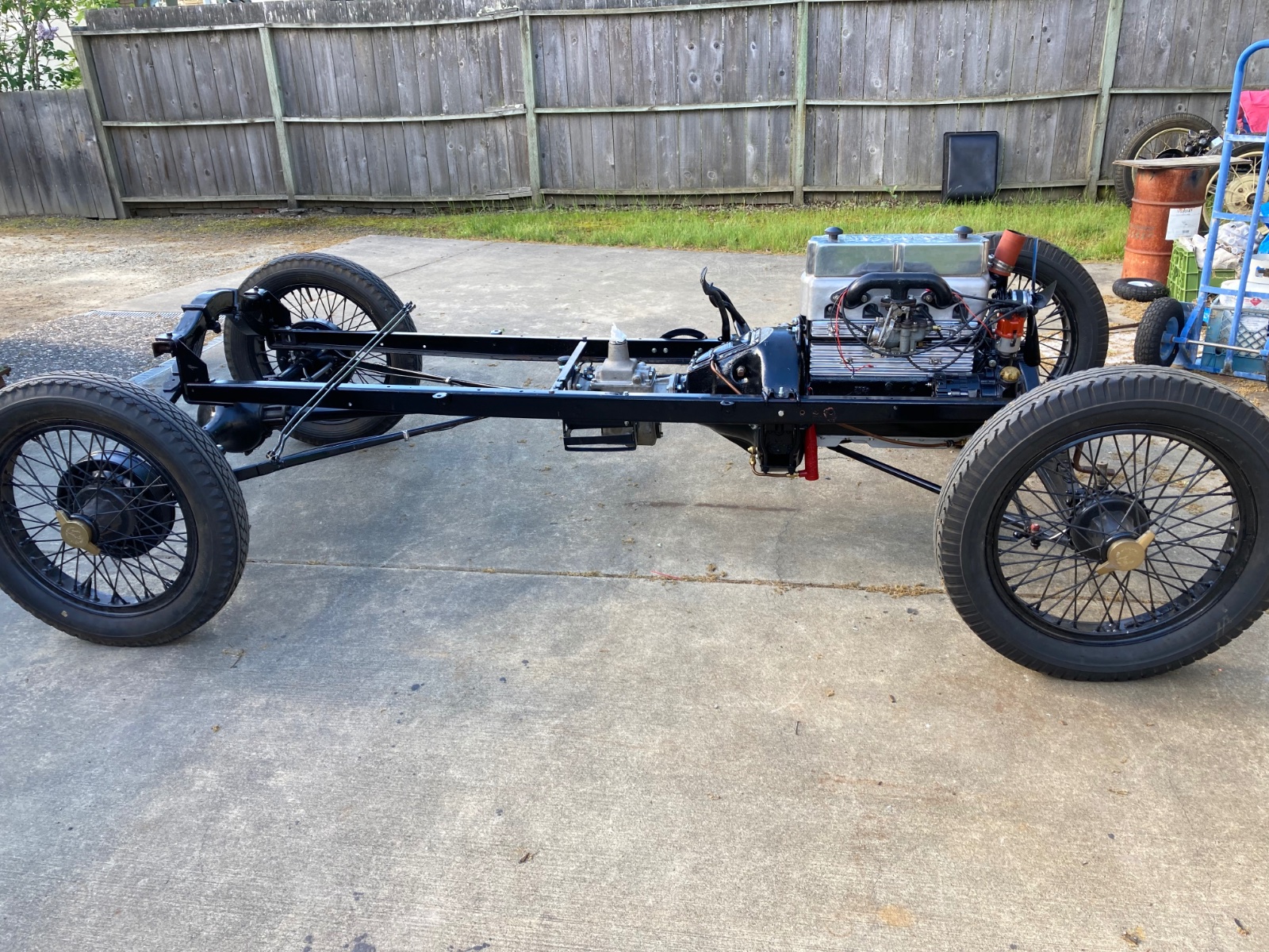

Beyond the drive train pics
Posts: 7309
Post by Allan » Thu Jun 27, 2024 11:26 pm
When a car is an assembly with numerous modern additions like coil over shocks and a Tremec gearbox it becomes a hotro in my eyes.. Had it had a Warford behind a T transmission and period Hartford friction shocks, then it could be considered a period speedster/race car.
There is nothing wrong with being a hotrod. Rodders do some of the best custom work seen, and this is a beauty to behold. I was not being derogatory of the car or the incredible workmanship. It just isn't a T anymore.
Kevin Pharis
Posts: 1656
First Name: Kevin
Last Name: Pharis
Location: Sacramento CA
Post by Kevin Pharis » Fri Jun 28, 2024 1:05 am
And pics of the broken crank! :lol:
Could be a good candidate for front brakes…?
Posts: 8675
Post by TXGOAT2 » Fri Jun 28, 2024 8:08 am
Scat crank.... probably massaged. I suspect that that T would be a pleasure to drive.
Susanne
Posts: 1119
First Name: Susanne
Last Name: Rohner
Post by Susanne » Fri Jun 28, 2024 11:39 am
Wow. Just... wow. I have to admit to doing a double double take on it... even WITH the modern geegaws on it, its a looker, no doubt!
You could probably come close to that using period components, but even IF it's a hotrod, damn, it's purdy! As in I certainly wouldn't roll it out of the garage for leaking oil...
I'm also curious how the unboxed frame handles the extra ponies...
