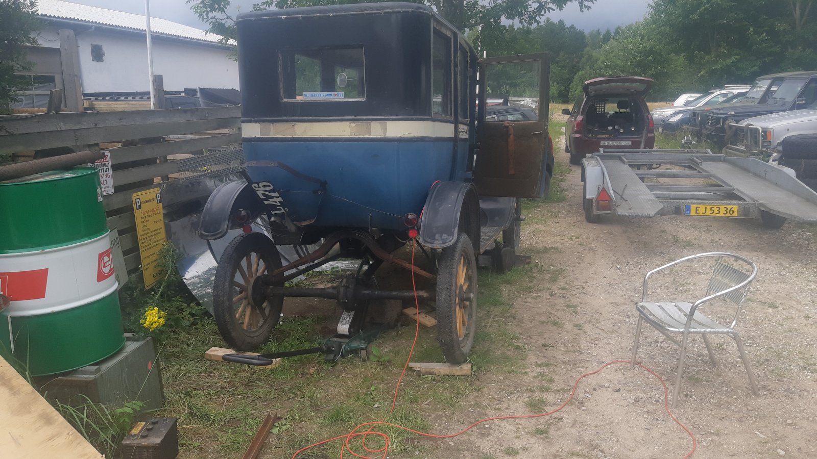

A loose hub damaged the key and made cracks in the axle and after some miles (hundreds) it snapped:
I've now bought a brand new axle and need to move the differential geat on the old axle over to the new.

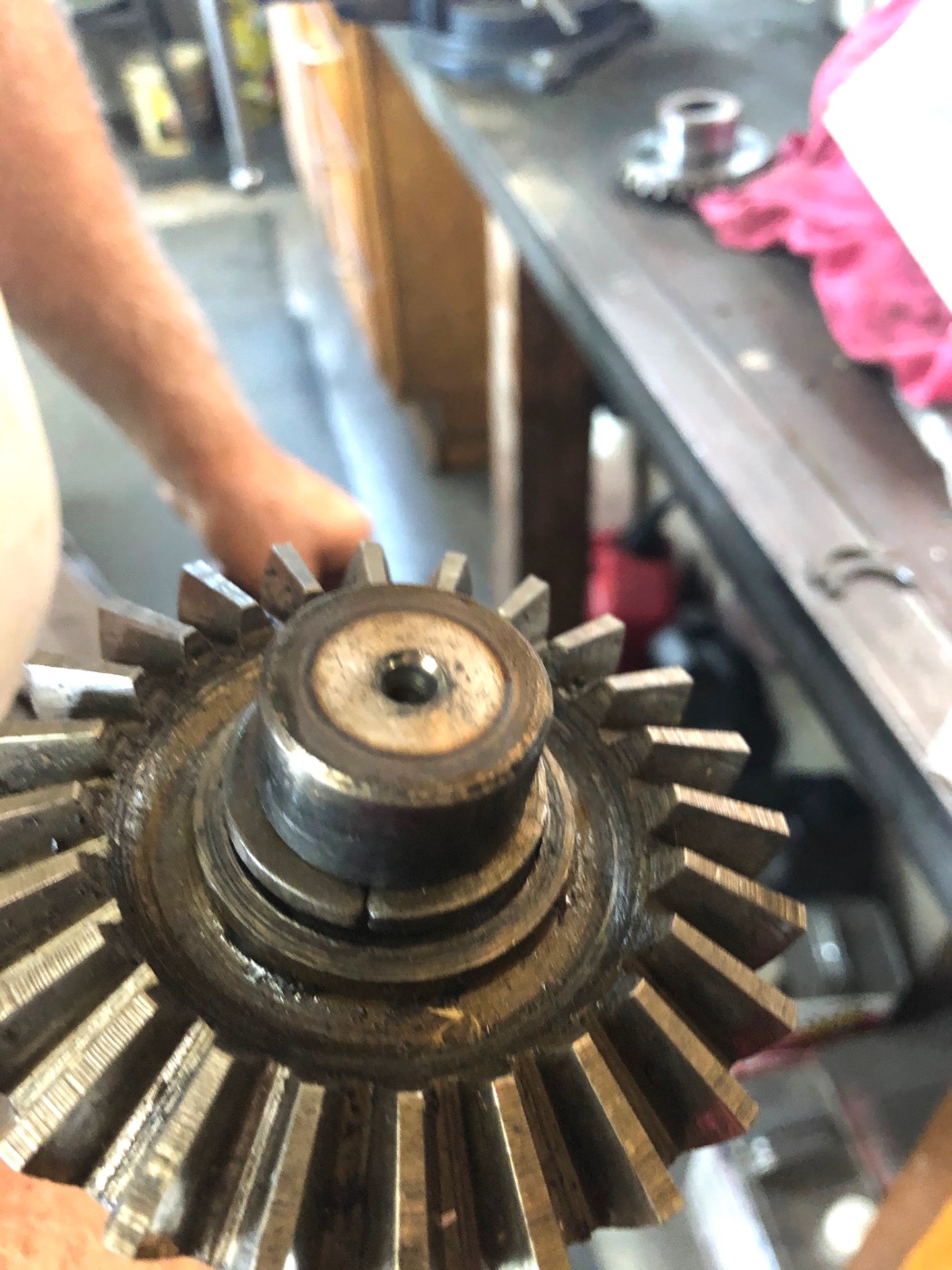

First you need to press the gear inboard to release & remove the split keys then press the gear off - installing is reverse of removal BUT I use a cage to hold the new axle captive while pressing the gear on.

Getting the gear off a bad axle is easier if the axle is cut about an inch outboard of the bearing land. That way it fits in a press easier and is way less likely to buckle under pressure.

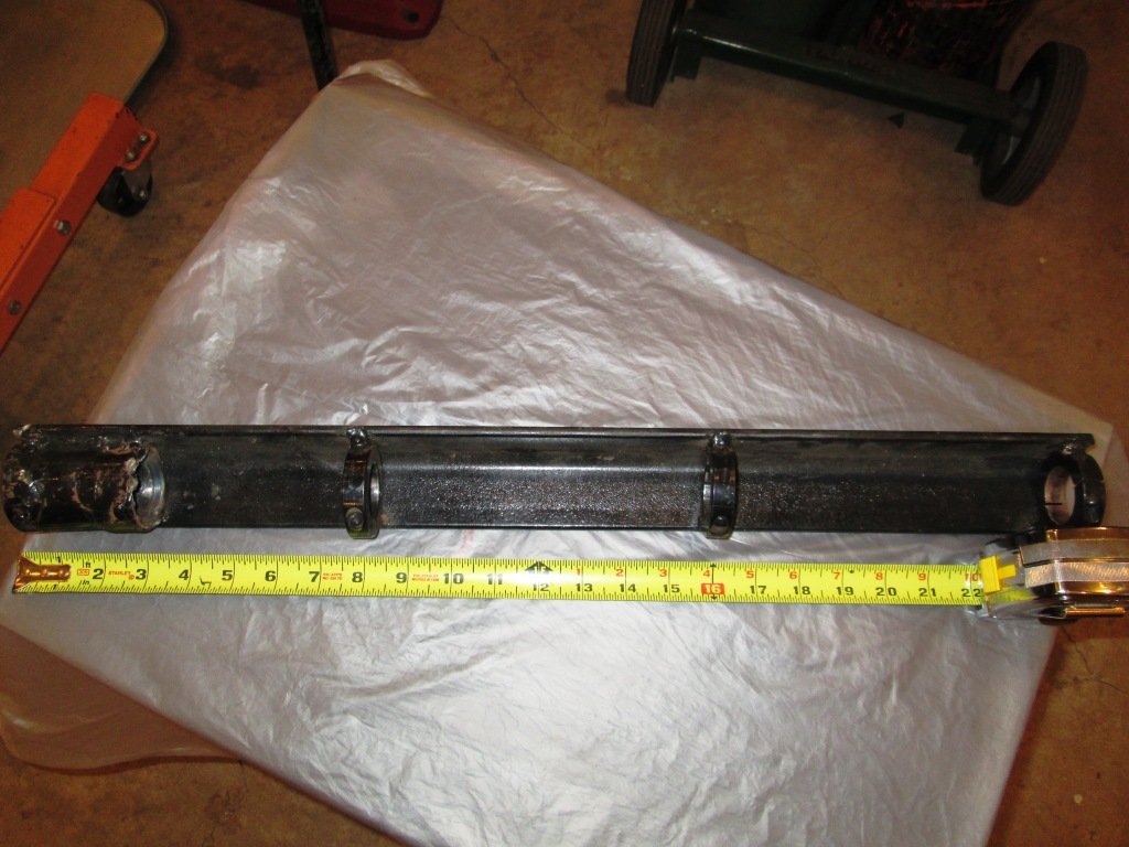

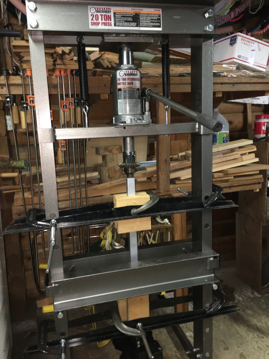

My cage pictured above has a hub taper welded into the bottom - I insert an axle shim at the new axle keyway position to assist in protecting the keyway.

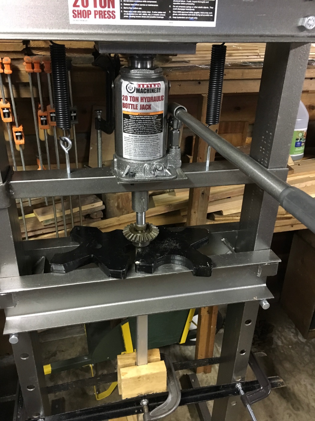

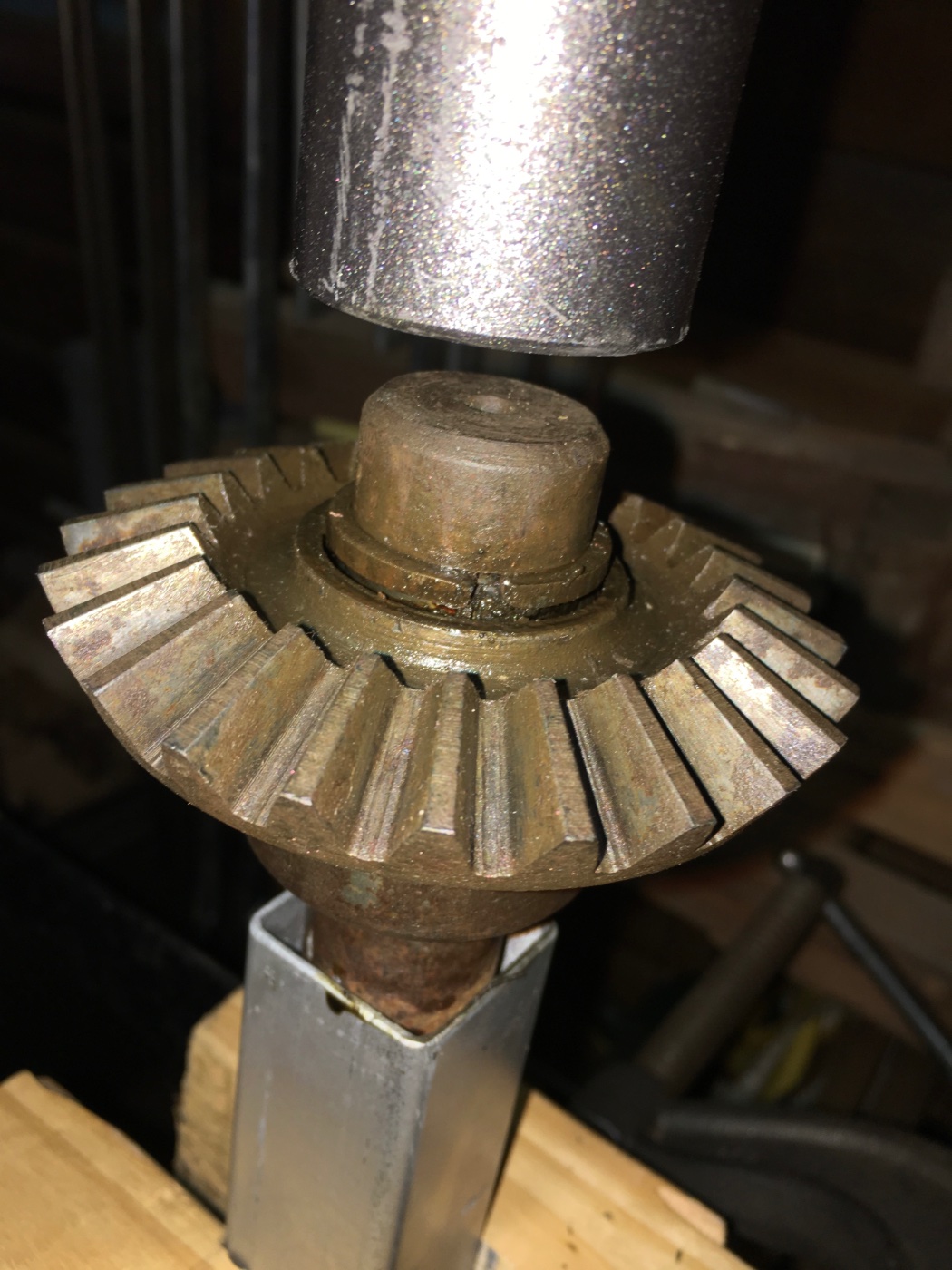

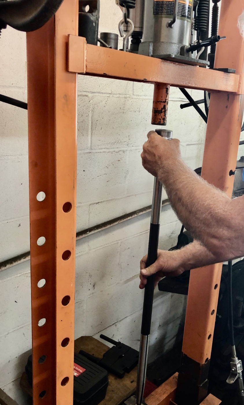

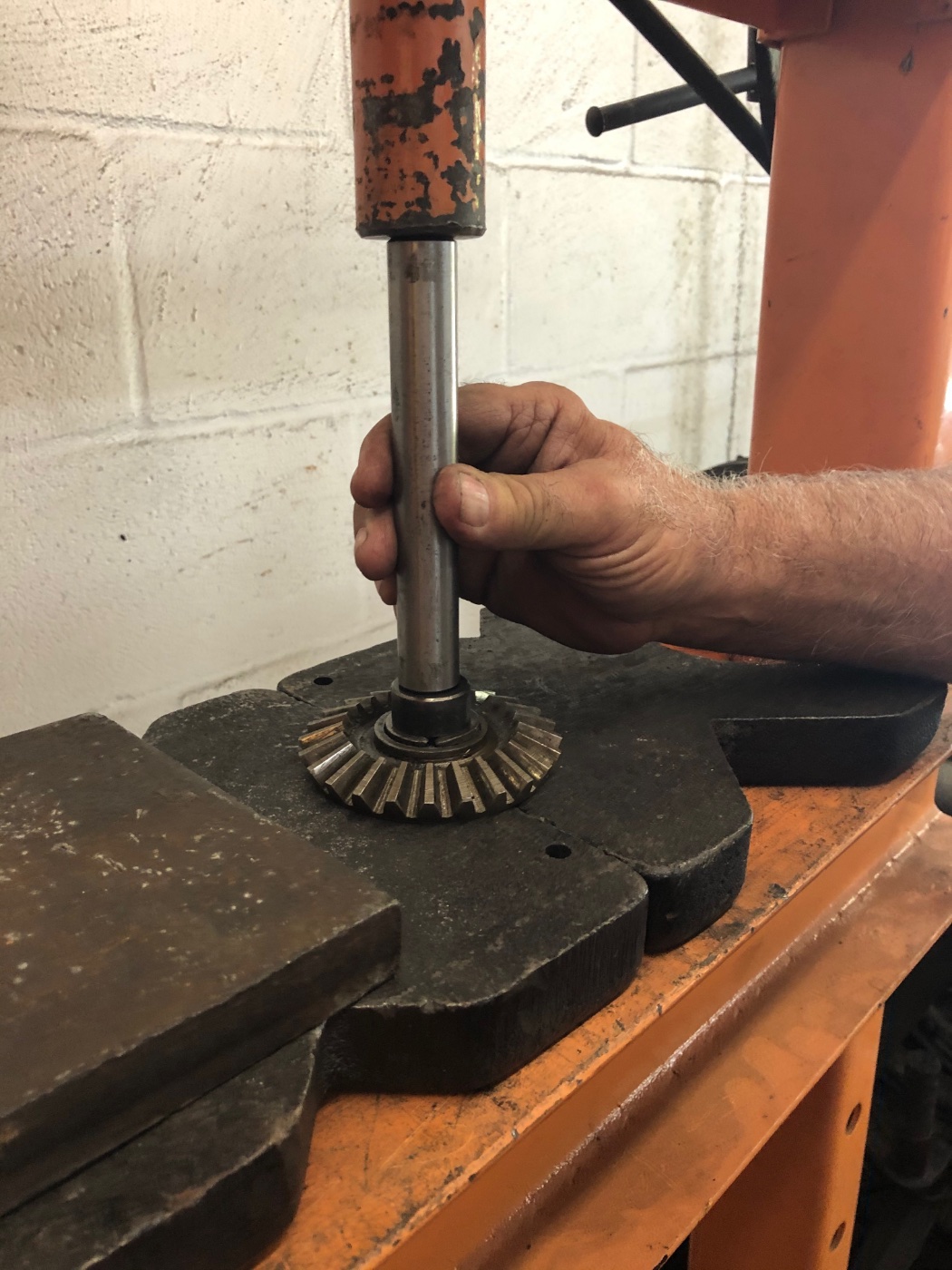

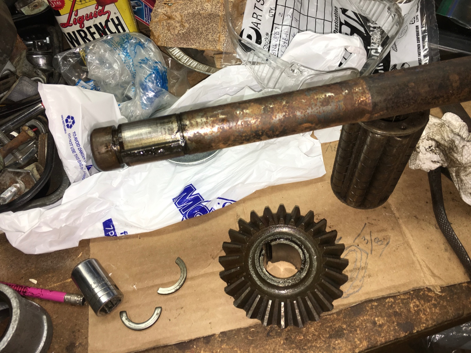

Photos to show the process of removing axle gear.
First push gear further on with a large socket. Take out the half circle keys. Then use a smaller socket to push out axle. Pieces separated. Note that I had to change my press set up for the different actions.
I use 1x1” steel tube clamped between steel cross pieces to prevent the axle from slipping out.

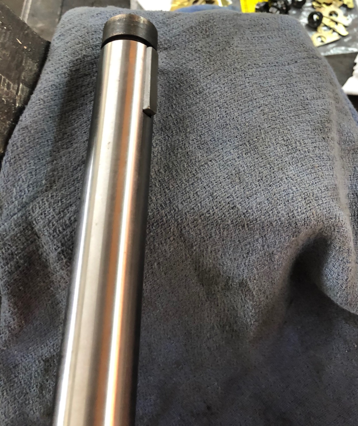

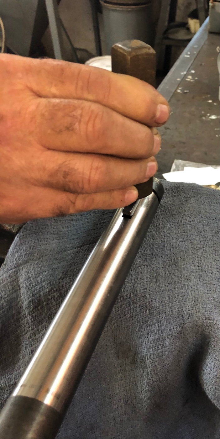

Isn't there also a regular key that goes in the axle to hold the gear in place, not just the ring keys? I have never seen one apart, so I am not sure of how they go together, except for what I have read.
- Posts: 5594
Re: Removing differential gear on rear axle
Yes, there is a substantial key for the gear.
- Posts: 4086
Fit key to axle shaft prior to placing gear. Be sure that woodruff key fits tight, tap in place.
- Posts: 7281
The key needs to be a firm fit in the axle. The fit should mean it needs to be driven in place as Dan shows. I use my vice and a pair of aluminium soft jaws to clamp it into the keyway. This keeps the key parallel with the axle and avoids any damage to the key which may be caused by a miss strike when tapping/driving it in.

When seating the lock rings in place, it's better practice to support the gear by the hub, instead of by the flange.

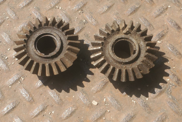

I posted just the loose gears in the forsale fourm few weeks ago

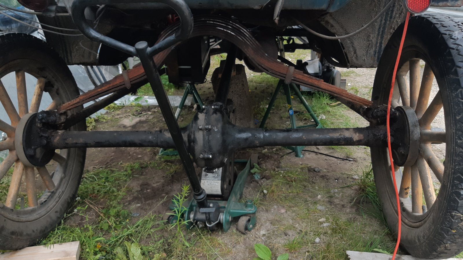

Differential assembled with new gear, one new axle and installed on car and sounds and drives well. All is good and "Korsbæk taxi" is back on the road after 2 years grounding.
Rearend with wheels positioned in place, car on high jacks - now the "fun" part to get the square bit into the rear of the engine
A look "up under the skirts" towards the gearbox end
It all ended well and me, my daughter and grandchild is now on the beautiful "Sunshine island" of Bornholm, ready to participate in the "Around Bornholm" together with 175 other classic cars (of which ahandful may be T's

What did you use on the bottom of the axle to prevent damage to the taper, the keyway, or the threads on hub end of the axle?KBurket wrote: ↑Sun Jun 30, 2024 1:58 amPhotos to show the process of removing axle gear.
Pieces separated.
- Posts: 5256
A large nut or castle nut backwards is enough. Face flush to the end of the threads.
An anti bend tube or pipe is important for the tough fits as to not bend the axle.

Thanks John, for the info. I'm going to make a cage/tube set up with a nut tack welded to plate welded/centered on bottom of tube.speedytinc wrote: ↑Sat Apr 12, 2025 8:20 pmA large nut or castle nut backwards is enough. Face flush to the end of the threads.
- Posts: 5256
I have a 6" square plate welded to a thick wall tube/pipe. Screw a nut on the axle.
Mark Nunn
- Posts: 1289
- Last Name: Nunn
- Location: Bennington, NE
Kent, my "cage" was a little simpler. I cut in half a 1"×1"×1/8"×48" angle iron. I put the two halves on opposite sides of the axle shafts with several hose clamps.

I made the jig yesterday, only difference was my bottom plate is 8" square. It worked perfectly! Both axle gears are pressed on and ready to continue the rear axle rebuild.speedytinc wrote: ↑Sat Apr 12, 2025 10:07 pmI have a 6" square plate welded to a thick wall tube/pipe. Screw a nut on the axle.
