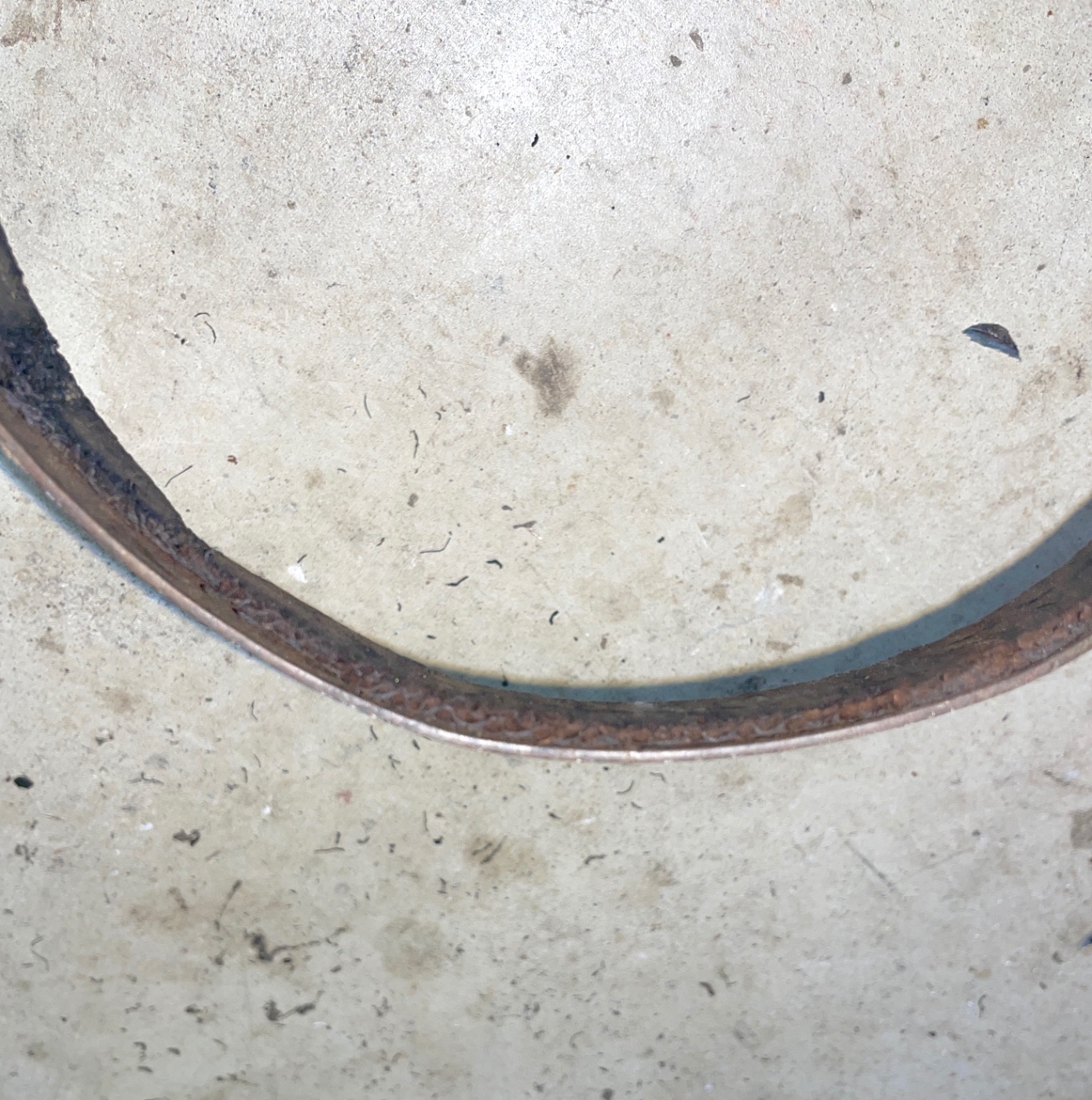

With Kevlar likely pretty fair, with softer linings and with wood linings, there is considerable grip at the bottom of the band on the drums.
Have removed worn bands with linings that usually show lots of wear right at the bottom of the band, so one would think that a gap of lining there wouldn't be helpful :?:

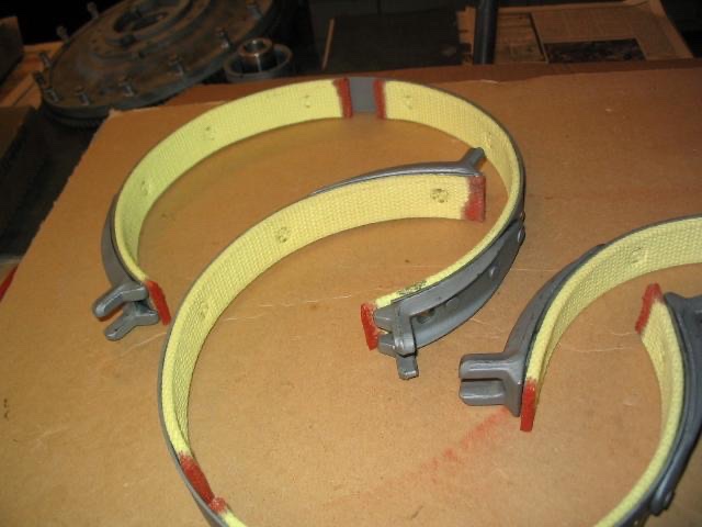

There were some period designs that used segmented linings, this wood version, but perhaps that is so pieces and not a full round wood lining had to be fabricated. And a soft lining in two sections for replacement ease, that has gaps too. Have seen hinged bands, with gap at bottom.
IMG_6615 (500x375) copy.jpeg (86.01 KiB) Viewed 1381 times
Might be ok to segment, but in seeing considerable wear at the bottom of full linings on bands, rather choice to me is stay with full circle lining on bands.

I have been splitting bands for years. Stole the idea from Herms transmission post. Originally to get short scandia usable with an appropriate amount of overhang under the ears.
I do this primarily for less experienced T drivers until I feel they can properly handle the less forgiving kevlar.
I have seen charred kevlar, so I do this now for the constant oil entering the bottom of the band. I do not cut a chunk off the kevlar band, I leave about a 1/4" gap @ the bottom & leave a bit more ear overhang.
"Fortunately" I have no feedback with either as the bands have lasted so much longer(?) I have not had to do replacements yet even for the inexperienced guys. That's all anecdotal, as I dont know how many miles are being driven. I have observed that if they dont break a drum from over adjusting Kevlar, the lining is good for decades.
I have not noticed significant band wear @ the bottom/center of unmodified bands. The worst wear has always been @ the ear ends to the point of needing relining, the middle is still serviceable.

Yes, same procedure.
With short Scandia the can ba a 1/2:" gap.
Be sure to glue the cut ends.
