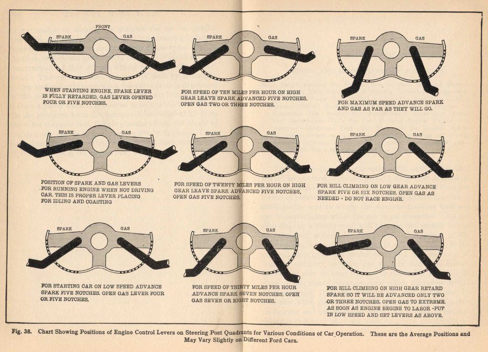

Ford published this guide for spark adjustment. I find it works for the most part. Seems like you normally pull the spark down about as far as the throttle, making little adjustments as needed.
The infamous spark/throttle chart is by Murray Fahnestock, not Ford (Page 432). Fahnestock is an excellent source of Model T information, until he isn't. I don't see any advice on when the chart should apply. In this case, I believe it may be suitable for driving on BAT, but some of the spark settings are irrelevant for driving on MAG. How many useful magneto settings are available on MAG? Three? Four? How many does the chart show? Six? Seven? When you're driving on MAG, I suspect your ears are a better guide than the chart is.
If I'm wrong on this (that did happen once) maybe somebody can explain why.

I stand corrected. I just looked at a 1917 owners manual and there is no chart. There is very little said except to advance the spark notch by notch until the engine seems to reach maximum speed but not so far as it starts to "knock." Not all that helpful.....

The retard/advance on the Model T is something that sometimes takes a little practice to get to that sweet spot, especially at high speed. I had the misfortune of experiencing a back fire and blowing apart the muffler. Too much advance is not a good thing as I found out the hard way. Don’t assume just because you may be driving 40 mph that you need the lever “all” the way down. Now I set mine approx 2/3 of the way down and the engine purrs as it should and have great power too! If your commutator rod is set correctly, you will get all the spark advance you need without bottoming out the lever. Anyone correct me if I am wrong.
- Posts: 8635
Re: Retard / Advance?
At best, the lever position is only a general guide. Wear of parts and adjustments affect the relationship between the timer and the lever, along with a great many other variables. I use the spark lever as needed to get the best performance and to avoid damaging myself or the starter when starting the engine. Once the engine is running, engine speed and load determines the best spark setting. Since both engine speed and load are almost constantly changing when the car is being driven, the ideal spark setting is also almost constantly changing as well. Generally speaking, when the car is moving slowly in High, such as right after making the shift from Low to High, the spark needs to be retarded. As the car gains speed, the spark needs to be advanced. This can be done with a flick of one finger. The cars BECM collects inputs from the behavior of the car and the sound and vibration the engine makes to program the timing to suit the operating conditions of the moment.

Sorry but I disagree with advancing the spark when just starting /idling. Incorrect AND the diagram shows nothing like that. You advance the spark when you increase the revs not at idle.

You are also correct. Charlie...... This spark is advanced with the speed of the engine, and the throttle is advanced with the speed of the car. When shifting into high, the spark must be retarded by half distance to easily pick up the shift into direct..,....,.. All the Artificial Intelligence postings must be ignored , and accepted as false, and used by practical application.

As I stated earlier, and I don’t know where I learned about it, but I’ve used the spark retard shift method for a long time. It’s the best system I’ve found.
