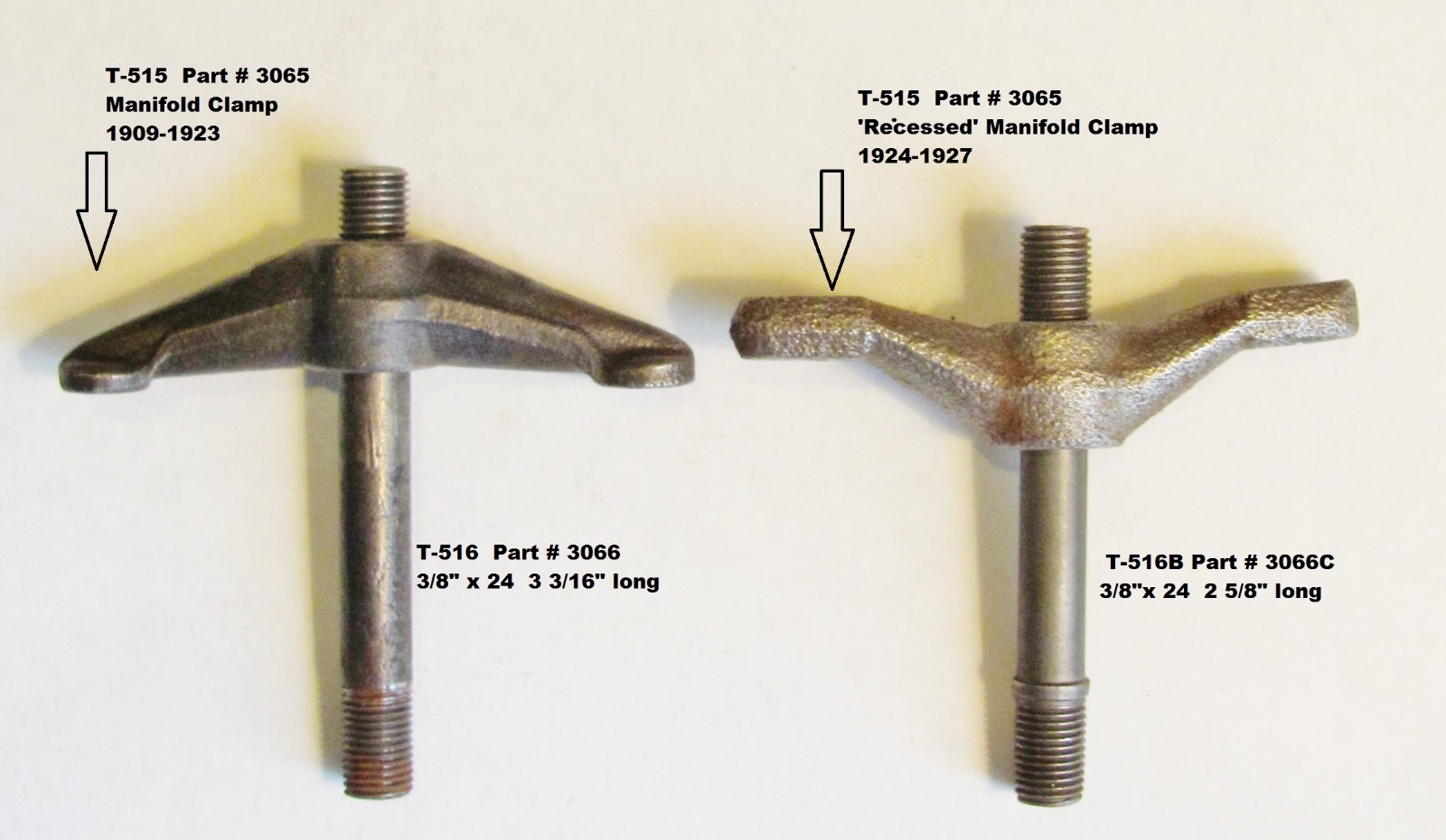

Evolution of 3066
3066/T516 was used on the 09-11 @3-5/16� long
3066/T516 (no revision but was probably 3066B) was used on the 11-24 @3-1/4� long
3066C/T516B was used on the 24-26 @ 2-5/8� (used with gull-winged clamp)
3066C2/T4882 was the bolt version used on 27 @2-5/8� from the bottom of the bolt head
As to source, the shown dates are based on Bruce best guess

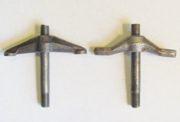

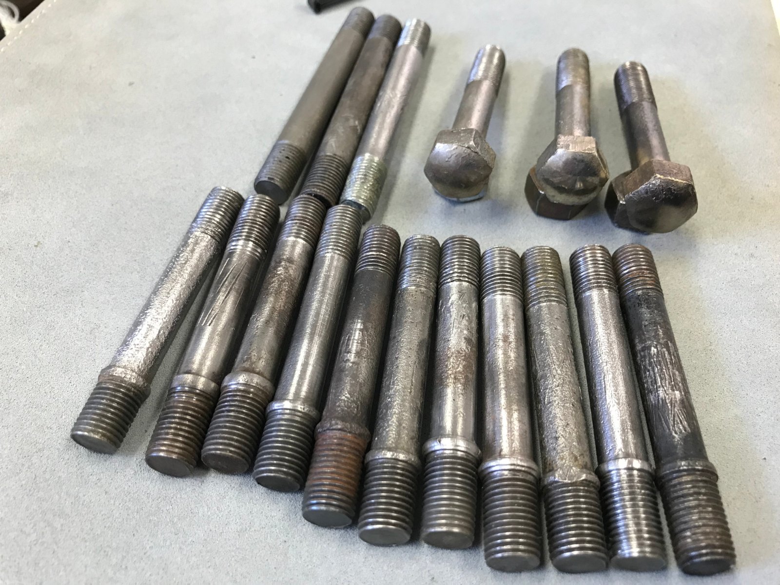

Here are original manifold bolts for the late T, nickel plate dome head.
And the two types of studs, the shorter stud for the '24 and later 'recessed' or butterfly clamps.
With the new style in '24 of the recessed clamp, Ford engineers designed it to also fit an early engine with the longer studs, just reverse the recessed clamp for a long stud.

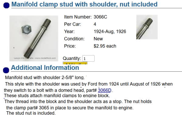

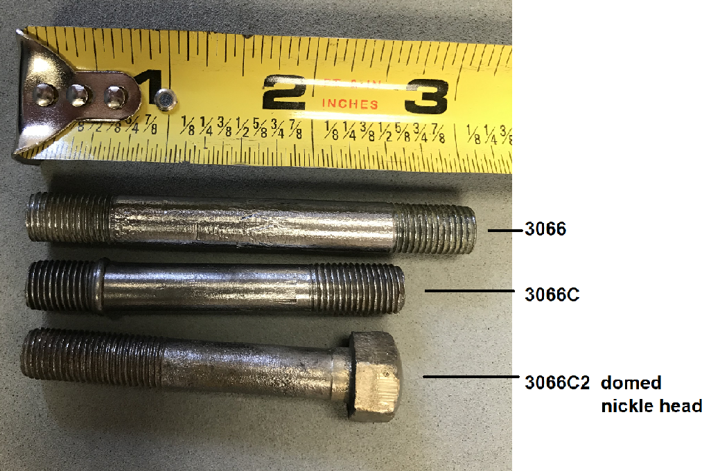

I have a setOriginal Smith wrote: ↑Tue Jul 02, 2024 11:33 amI am not aware of bolts being used. As noted above studs were used. The clamps can be reversed on some later types to fit different lengths.

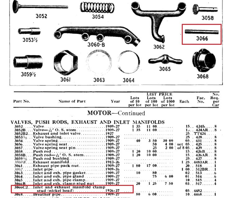

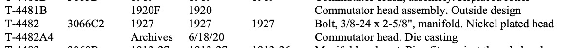

Should have pulled this screen shot from Bruce's C-D encyclopedia. Even gives the length that OP wanted
- Posts: 5587
Re: manifold bolt length
Maybe so Dan but it does list "stud" & the illustration shows the same !

With respect can assure you, the last manifold clamp fasteners became bolts with dome heads. Many '27s have these, have seen plenty.
The Factory Numbers are there for the nickel head bolt, so that is the specification.
Factory No. 4482 for the Part # 3066C2 Bolt, nickel plate dome head 2 5/8"
Factory No. 516B for the Part # 3066C Stud 2 5/8" for the new style 3065 'reversing clamp'
Factory No. 516 for Part # 3066 Stud 3 1/4" for the earlier clamp
Lots of times the illustrations in the Price List of Parts won't match as they can be earlier pictures, most times the newer parts may or may not be listed and without updated illustrations.
