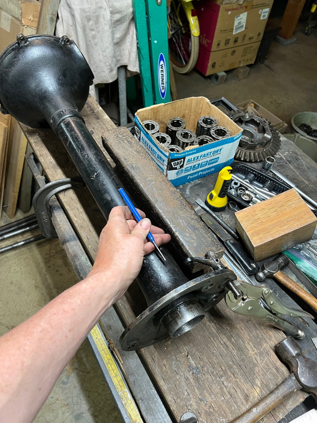

I cut the peened head with a sharp cutting chisel, then drill with an undersized bit, then support edge of cam arm on an anvil and punch it out. Bigger hammer if needed.
Example photos from recent effort on a small drum cam (two pins).
It’s much harder if axle is on the car.
