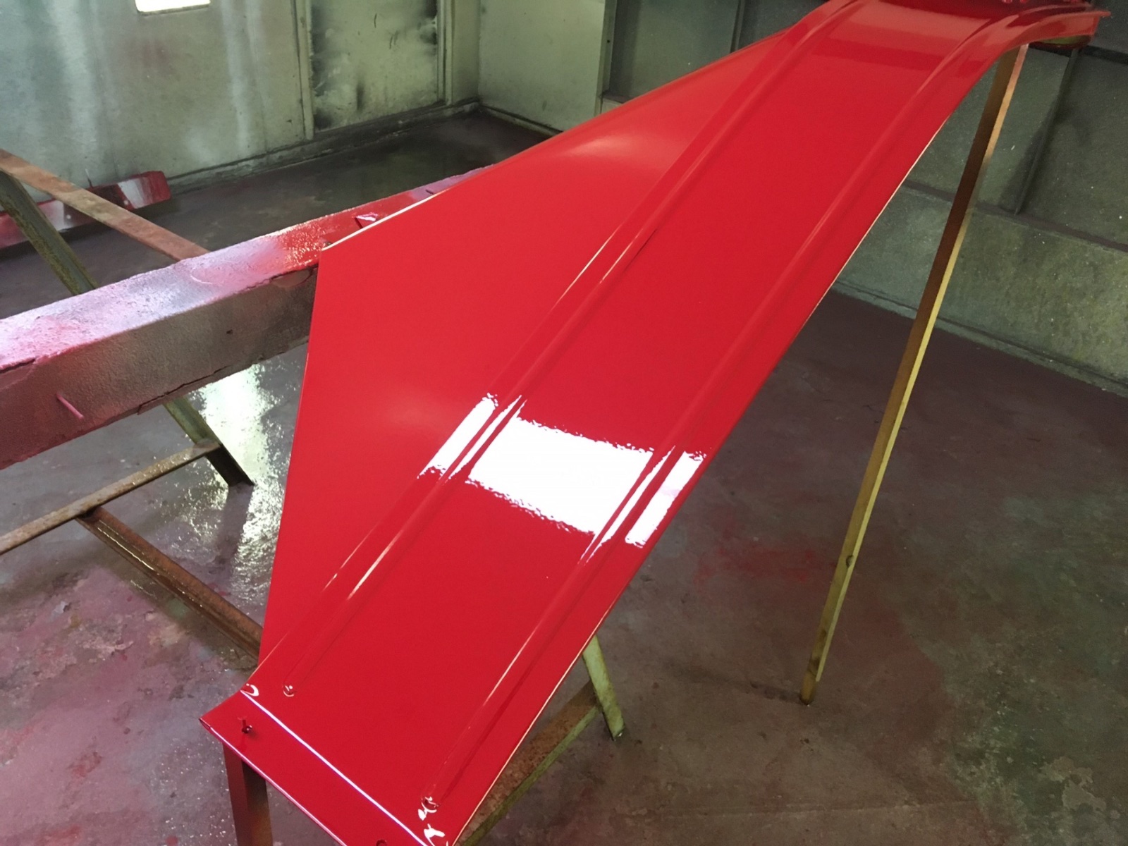

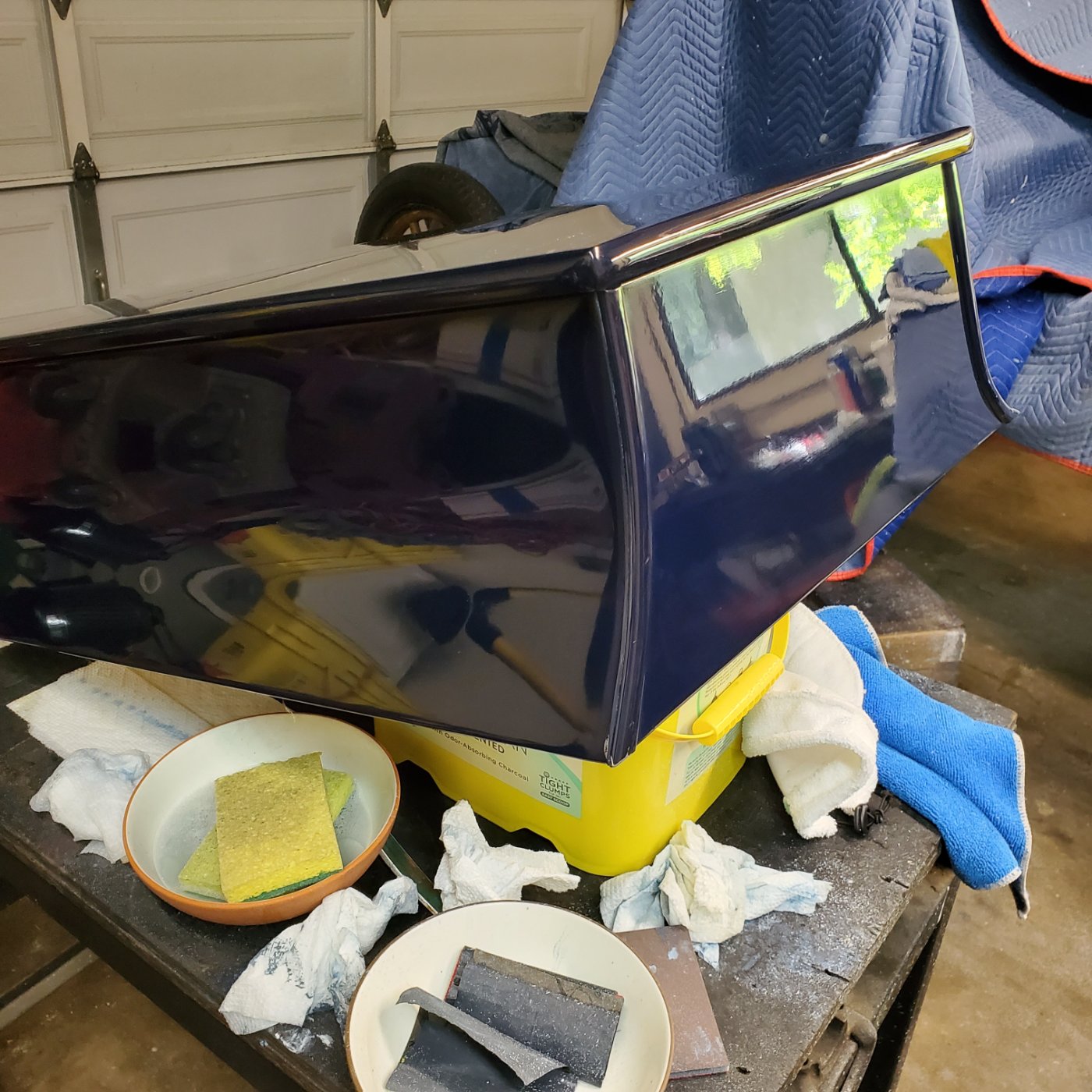

Impossible to avoid dust without a booth. I did all the stuff a nonprofessional would do. Made a visqueen booth, cleaned parts and supports with a tack rag, watered the floor and still got a lot of dust. The key to a good outcome is color sanding and buffing.
As an old pro told me years ago.
"Anyone can paint. Its what you do after painting that makes the difference."
