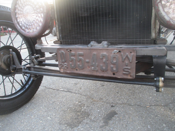

Post by RajoRacer » Sat Jul 06, 2024 9:32 am
Working on a friend's speedster, 4" dropped axle, lowered spindles, reversed spindle arms (for clearance), new pitman arm, all spindle bolts, tie rod bolts & front bearings all snug - problem is it's quite squirrely/darty at anything where over 20 mph. Will verify drag link length but this has me scratching my head ! 30" tires with 5-1 upper gears.

Steve, any chance it could use a Panhard Bar on it? We had a 'gow job' in the shop that was a white-knuckle ride that darted every which way. One of the main things we did to correct it was to install a Panhard bar to keep the axle under the front of the car. Maybe you could do something similar??
