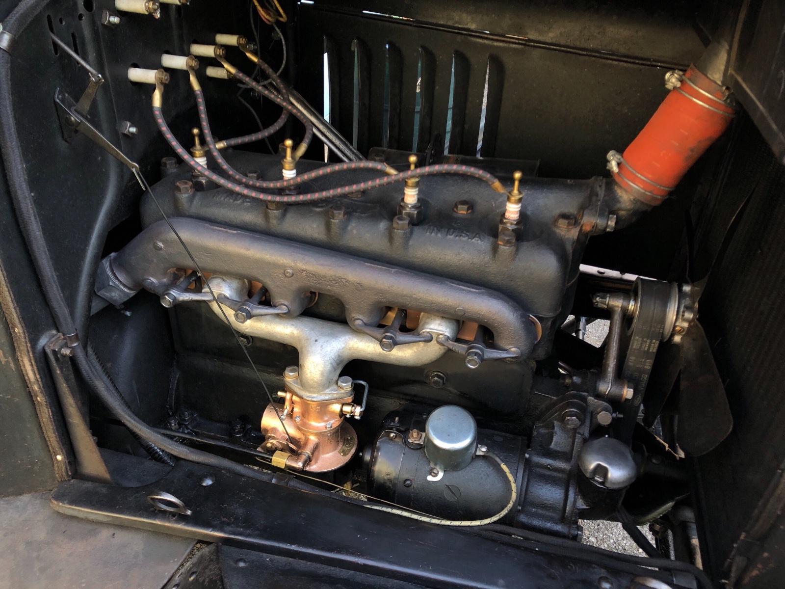

Here is the picture I took of the installation tonight. Thank goodness I went out there to take it.

Yes, I went through a checklist in my head and the float was high on the list. But this is the U&J that Stan Howe had just rebuilt a month ago. And when I gave the core to him it didn’t have a float so I’m assuming he would have used the new buoyant materials rather than the older hollow brass types.
I’m hoping it’s something like a bit of debris that got in there and found its way to the viton needle when I was installing the new gas line. Just went out this morning and am anxious to sweep up the gas sodden kitty litter.

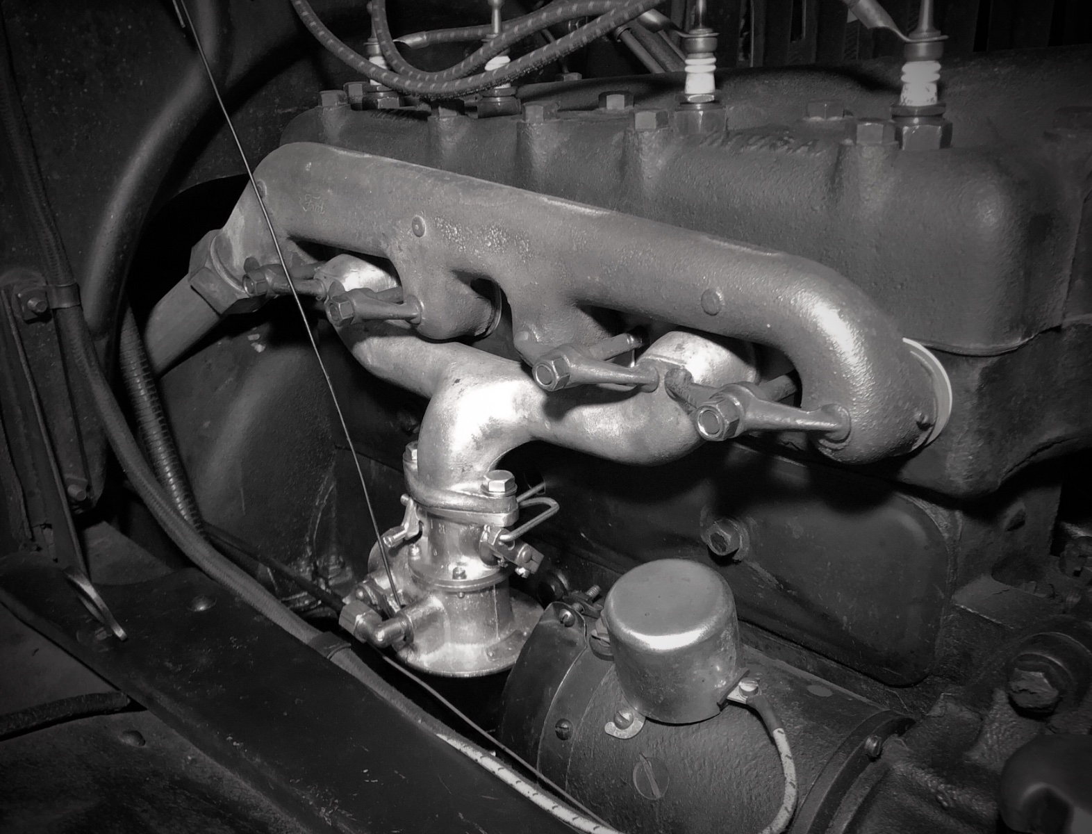

In the mean time .... here is s picture I took this morning.
