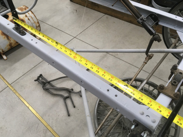

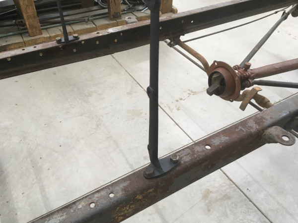

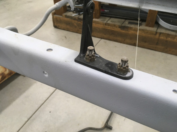

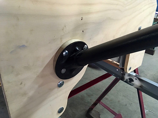

I don’t have the numbers except the face of the firewall is approx. 28 3/4” from the front of the frame rail. You should be able to figure it out from these pics.

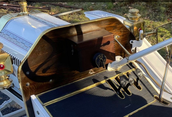

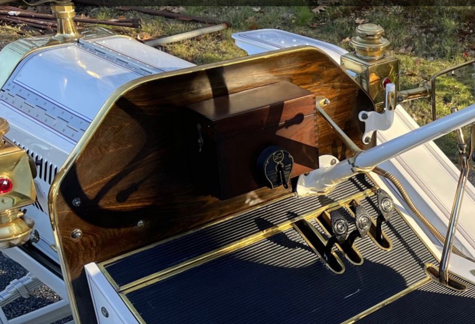

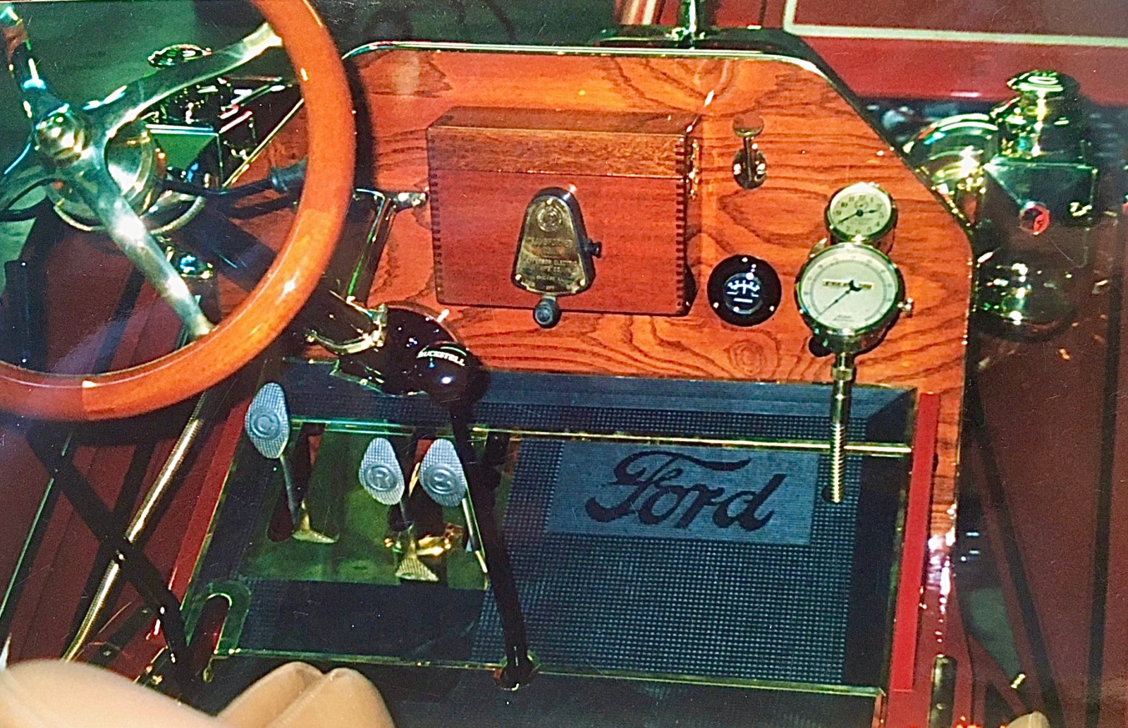

I found these two for coil box placement. You have to be able to get the nuts on the coil box mounting brackets under the hood former.

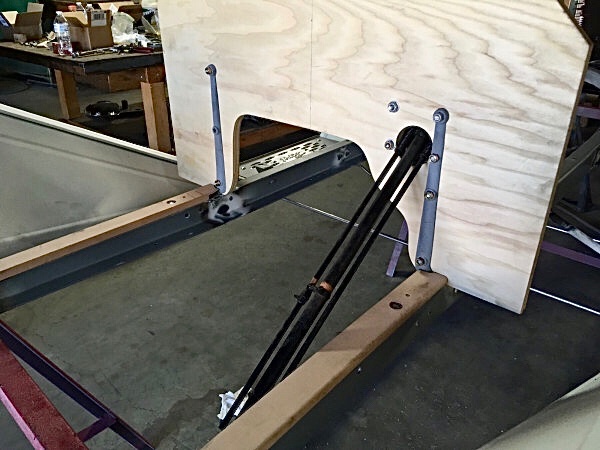

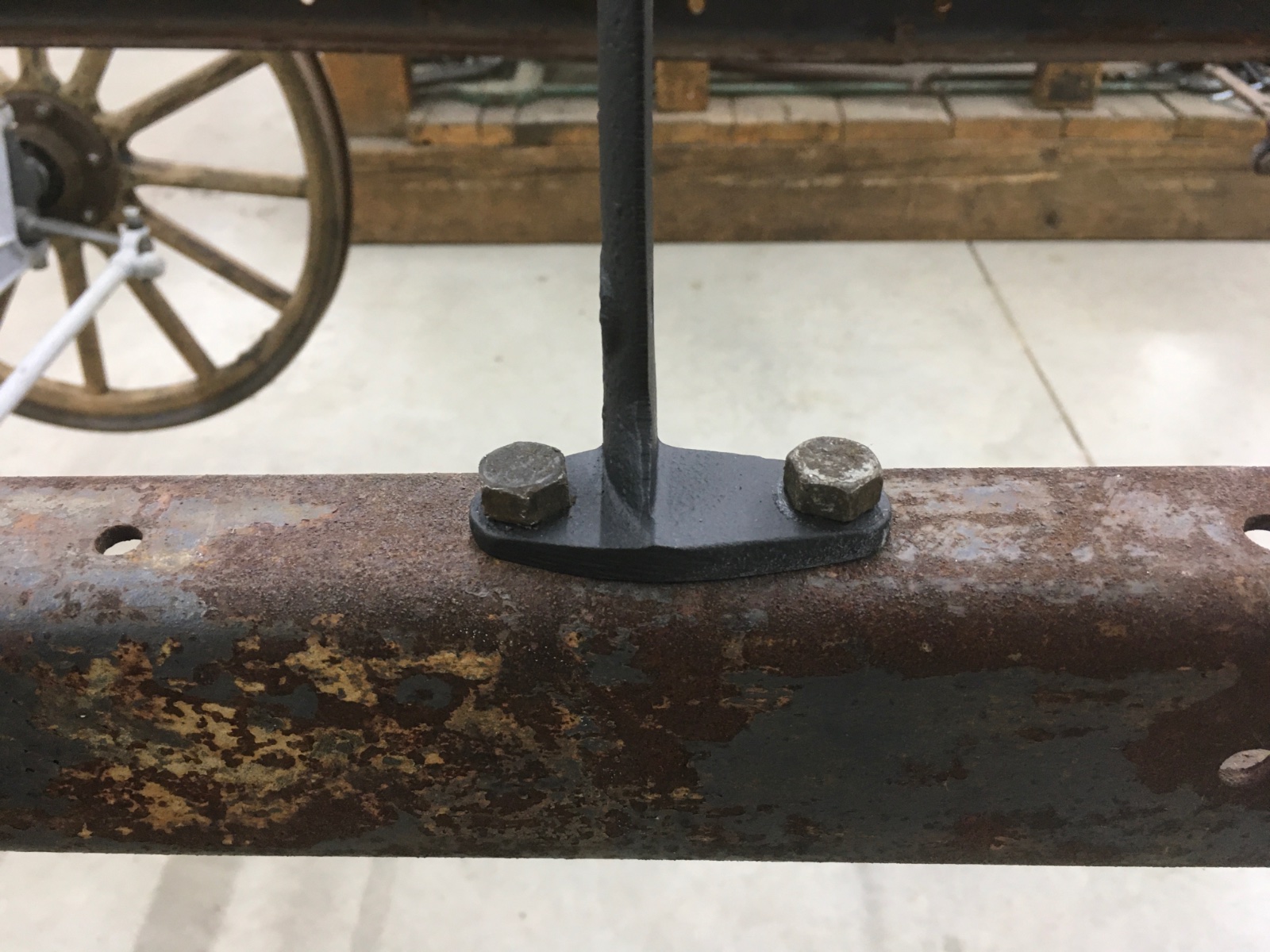

Building a brass speedster Looking for some insight.. In the photo of this post where assuming the firewall is moved back 2" from the 28 3/4" measurement reference and the steering column is bolted through the same bracket holes I'm struggling with 2 problems the frame tab on the bracket would be hitting the transmission support before I get the 2" back and the brackets would be so close to the starter would be impossible to remove starter bolt if needed ? in the pic there is no engine or transmission for reference
- Posts: 3859
- First Name: Tom
- Last Name: Rootlieb
Re: speedster firewall
The 2” firewall set back is actually 28 1/2”. These are torpedo firewall brackets.
With the 11-14 firewall brackets, you cut off the rear tab and move the front hole to the rear hole position.
You will notice in the top photo there is no tab sticking out the back to interfere with the engine pan ears. But the firewall will be right up against the pan ears.
You will have to notch away the edge of the firewall and possibly grind off the corner of the firewall bracket to gain access to the top outside screw that fastens the starter to the hogshead.

THANKS for the insight ! MUCH appreciated ! and what I was thinking
