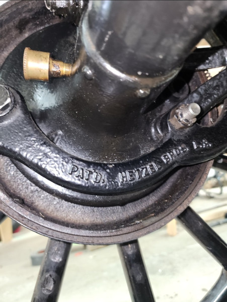

My car came with aux brakes installed they are "hetzel bros" and look similar to the old rocky mountains.
They are installed on large drums, but at some point someone gutted the parking/ emergency brake out of this car. I'm hoping to reinstall the missing brake hardware and get a functional emergency brake again.
The parking brake lever applys both the aux brakes firmly. Honestly the car holds very well with the aux brake, probably at least as good or better than the small drums. Either way I chock it anytime I park on even small slopes for peace of mind.
When I bought the car they had the service brake backed way off, and were just relying on the aux brake. I have sense adjusted it how I'd adjust rockies, where you adjust the ford brake as normal, then adjust the aux brake to come on half and inch of pedal travel or so before the ford brake. I had a car with the reproduction rockies on it and wouldn't trust them at all. Basically I viewed them as just a way to extend the service brake band life.

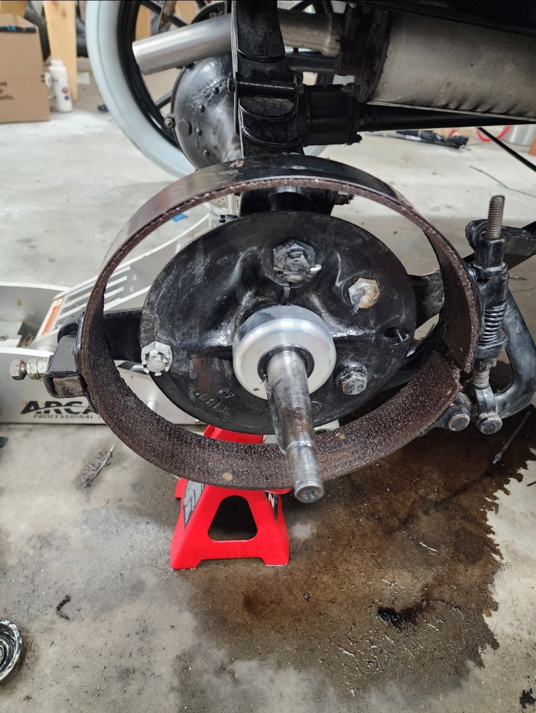

It would probably possible to install a small drum "nested" with the aux brake drum.
My concern is with the way they have the linkage setup it's going to be a big headache trying to balence out three brake systems.

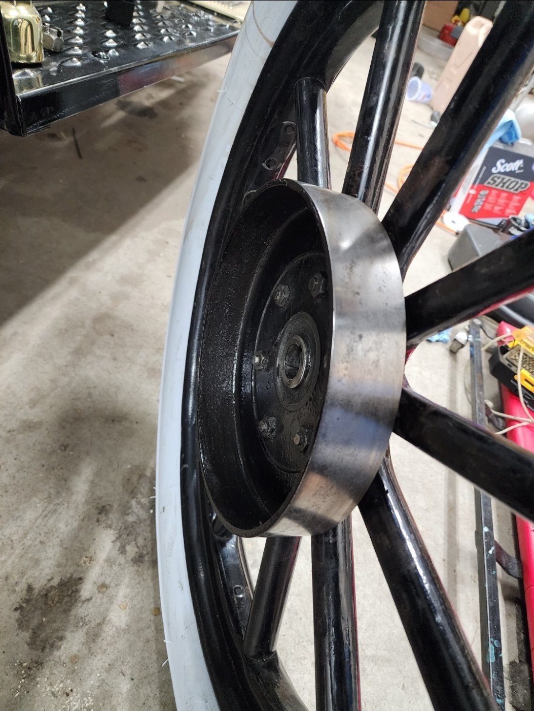

Your drum looks to be machined to take an original small drum. However, your most likely issue, & probably the reason there is no original parking brake drum, Is the extra thickness added which usually requires longer axles to clear. (or an axle stretch job on both sides) If the external band brakes work well especially in conjunction with your transmission brake, you should be ok. Those brakes with the center rear anchor should work very well in both forward & reverse application. I would personally put the lined parking brakes in. More braking systems the better. It will be a PITA.

I think you hit the nail on the head with why the small drum was removed, measuring the parts stackup I will definitely need longer axles.speedytinc wrote: ↑Tue Jul 09, 2024 8:10 amYour drum looks to be machined to take an original small drum. However, your most likely issue, & probably the reason there is no original parking brake drum, Is the extra thickness added which usually requires longer axles to clear. (or an axle stretch job on both sides) If the external band brakes work well especially in conjunction with your transmission brake, you should be ok. Those brakes with the center rear anchor should work very well in both forward & reverse application. I would personally put the lined parking brakes in. More braking systems the better. It will be a PITA.

Instead of longer axle shafts, why not machine down the lip of the the stock brake drum so it doesn't interfere with the axle housing backing plate? Likewise, machine down the stock brake shoe and brake cam so the width is narrower.

Sometimes a 1/16" longer axle isnt even enough. Hubs have a wide swing in the amount of wear.
I do an "axle stretch" on original axles as a mater of coarse to +.090"
1) The drum does not need to be trimmed. It will hang past the backing plate,
unless the axle & sleeve have severe wear, causing an off center situation.
2) The brake shoes can be narrowed. The lined shoes need a lot of trimming to fit up to 1/8" R/M brakes or not.
3) I dont recall the cam ever being a problem, but it could be trimmed if needed.
4) The brake shoe pivot bolt's narrow head can be ground shorter as needed & the iron seat on the shoe lowered also.
5) The biggest interference problem comes from the 6 hub bolt ends & nuts with the perch. The nuts are already a narrow jam nut.
I wouldnt & dont ground them shorter. The ends of the bolts can be ground a bit lower to just above flush with the nuts after peening.
A little green locktite also adds a bit of safety.
The end of the perch can be trimmed down to just above the cotter pin hole.
It is common to find this area already ground down from past rubbing.
I believe one could add a spacer washer outside the backing plate to the spring perch & take a corresponding amount
off the big perch nut base. Have not done this yet.
6) Let us not forget there must be clearance for the outer axle seal can to not rub/lock up the hub.
So far setting them as far as possible with a BFH has worked for me.
Machining extra clearance in the hub for the can is not practical for most, but possible.
@ this point changing the hub out for a better one might be an answer.
You can see why I try to prevent all this interference fixing by stretching the axles whenever possible.
You can also understand why many people add a thick shim(s) which can cause other problems down the road to make stuff fit in the now.
