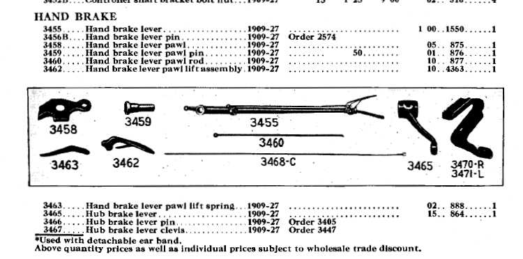

The parts manual refers to it as a "hand Brake". Functionally it is to be used both as "parking brake" and as a "clutch". In panic mode it could be used in conjunction with the transmission brake along with engine braking as an "emergency brake" just before you crash

The difference in nomenclature could be due to the "bible" having an updated section covering the improved models.Steve Jelf wrote: ↑Tue Jul 09, 2024 10:44 amThe Bible (shop manual) calls it emergency brake, or in some places just brake. My owner's manual (May, 1913) says hand lever and hub brake.
