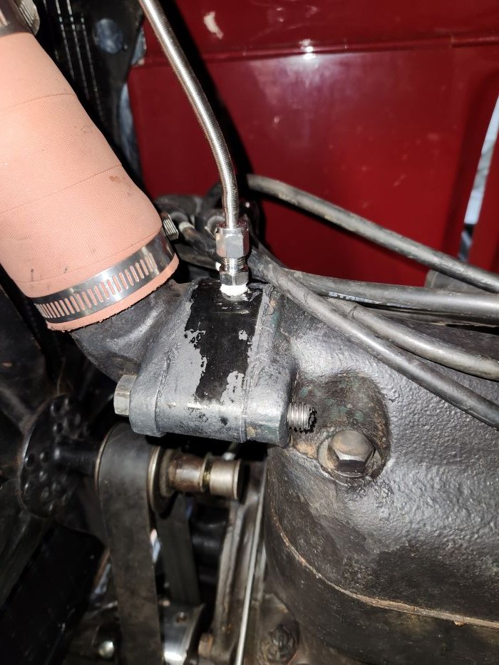

Greetings all,
I find myself looking for your advice once again.
My 22 T has fundamentally a fully rebuilt engine (new aluminum pistons, rings, and plastigauge rod and main journals) with a rebuilt carb, and a new BOSCH distributor, etc. She starts up quickly and runs smoothly but after about 20 minutes of driving I get a slight knock from the engine and it begins to loose power. In more than one occurrence its even stalled and is slow to crank for a few minute. I put a digital thermometer with a thermocouple inside the top radiator hose and the temperature stays around 195-200f - unless I'm going up a steep hill (in low) or at a high speed and she climbs to 210 - where I throttle back. I don't have any sort of tachometer to judge speed -
My carburetor bushings are not the greatest, and I suspect the mixture may go lean when warm due to bypass air.
For overheating my next steps are to 1) flush all, 2) put in a 50/50 mixture of glycol and water, and 3) strip the 'hi heat paint' I have on it now and then spray it with 'radiator paint' from Eastwood. If that doesn't improve it -I may switch to an electric fan ... and go from there. (a New radiator is beyond my budget) (note: no thermostat or water pump)
All that said, my biggest worry is the knock.
So, possibly expanding cylinders with lower compression? Expanding pistons with wrist pin knock? rods need to be checked and possibly taken up?
what else?
Thank you all again - I would never have gotten this car going without this forums help.

There is another thread about a "hot" engine. The author measured 214 degrees F at the top of the head. IF, that engine was at sea level, with just water in the system, it would have boiled as the boiling point of pure water at sea level is 212 degrees F. Add altitude, the boiling temp. goes DOWN. Here in Denver, at 5280 ft elevation, water boils about 201 degrees F. It takes an additional 10-15 minutes cook time to get to appropriate done temps. except for meats, the cook time is less as the water is boiled out quicker and the meat turns out dry if cooked for a recommended time. Thus, we have to keep antifreeze in the coolant year round, ensure our coolant systems are clean as possible, and radiators clear of leaves, cottonwood cotton, and the like. We have more episodes of boiling (gurgle) after we shut off the engine. I have yet to boil over even after a long, hard run, but it will gurgle. I know this engine has been rebuilt by a reputable man and has aluminum pistons in it.
I worked and taught on a nuclear submarine prototype propulsion and electric generation plant. This was the ONLY thermosiphon nuclear reactor at that time. It worked great. All made of Inconel (stainless steel) Quiet, excellent power profile, great coolant (water) flow. Most reactors rely on pumps to move the water. When the pumps quit, there is a potential for serious problems. With that thermosiphon reactor, if we lost pumps, we were still in fine shape. Our only limitation was 60% of full power. To go above 60%, we needed the extra flow provided by the pumps.
Addressing aluminum pistons: Do you think the pistons ADD or SUBTRACT from the amount of heat generated by the engine? I see no substantial difference between aluminum and cast iron pistons. While the aluminum pistons MAY conduct heat a bit better than cast iron, the heat would be transferred to the head, block, engine oil. The head and block would be a benefit while the oil would be a slight detriment as some of the heat in the oil would be lost to the air outside of the oil pan. I believe this small amount of "lost" heat would NOT affect the thermosiphon to any appreciable amount. I submit: How many T engines have aluminum pistons, today, and still have adequate cooling?

- Posts: 5148
Re: loss of power when hot
A few thoughts regarding your recent post.
A thermostat,( if thats what you mean) like a modern motor uses will restrict the open flow needed for a "thermosyphon" system. Unless its needed to slow the rapid flow created by a water pump, which you dont have.
If you find oil flow to the front is an issue, a high volume HH mounted oiler could help. The external oiler pick up is much higher (with too much flow @ times), providing an oil flow @ a steeper grade than even a large internal funnel.
When you short out #1 plug does the knock lessen? =#1 main problem.
If your rebuilder put in a regrind cam that REQUIRED a front thrust washer setup, but didnt, your knock could be coming from the lobe digging into the front cam bearing. I found/fixed this problem on a "professionally" rebuilt motor. You can see this thru the inspection cover. Evaluate the cam gears condition & tightness @ the same time. I hope your motor builder took into account your hill driving & put some serious oil slingers on.
Why do you claim you cant get to #1 main? It can be dropped & removed thru the dipper cover. You typically have to notch the pan a little bit to remove the 2 main bolts.
I have given you more possible places to check. It aint rocket science, I am confident you will figure it out.
Best of luck.

Hi John - Thanks for the reply-
Today I did pull the plug wires and no. 1 is definitely the source of the knock ... I should have mentioned this before but the knock frequency was in sync with a single piston power stroke ...
about the 'adapter' between the top outlet and head- (see image). I had it machined in China for $43.00 - fits great and I put a 3mm Type K thermocouple in it - and connected it to a small digital temp readout. So, no thermostat -
I will definitely look into a high volume HH mounted oiler ... every bit helps -
About pulling no. 1 main ??? I am confused on that one - from photos and the T Manual it looks like you need to split the bottom crank case from the main engine block? If I can get to no 1 main - GREAT! what did you mean though about "notch the pan a little bit to remove the 2 main bolts"... ???
