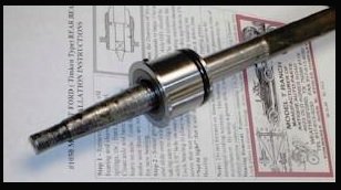

I believe these are not ball bearings, but rather timkin. They seem a bit pricey, but why not use the best technology available, especially if it doesn't affect the look of the car.

Mike, Timken is a brand of bearings. They make all sorts of bearings for a multitude of applications. I do not know what type of bering is used in that set-up. The carrier looks to be a separate piece, of thickness greater than the original sleeves if it has that O ring on the end. This may mean the bearing is a roller bearing, and that would be considerably shorter than the originals and most likely of lesser diameter rollers.

While I don't have one of these sets in my hand, it is clearly shorter than Hyatts and very likely much much stiffer. This is not a combination that leads me to believe axle breakage will be reduced. If you want a seal, put in a seal. I own 4 Model T's...if safety was my first priority, I would sell them, not butcher them. You're kidding yourself, anyway, if you think disk brakes make you safe on the road. It's a Model T...you're never really safe, and no accessory is going to change that...if that's an issue, you're sinply in the wrong hobby.
