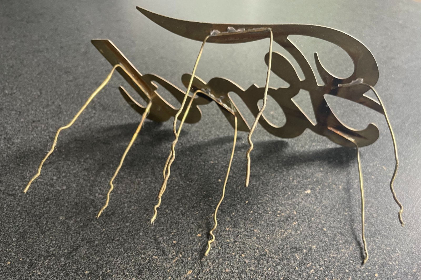

I have decided to add a little bling to my car and attach a brass "Ford" script and a small "1914" script to my radiator. There are two recommended ways of attaching the script. They say you can use brass wires to hold the script to the radiator or you can silver solder the brass script to bolts and run the bolts through the radiator. I was wondering if anyone had any advice or feedback on this issue.

When I did mine, I soldered brass wire sets onto the back of the brass script and ran the wires through the honeycomb radiator I had on the car. Worked well, but the above advice is good; use a small piece of wood for backing. Twisting the wire ends might damage fins.
