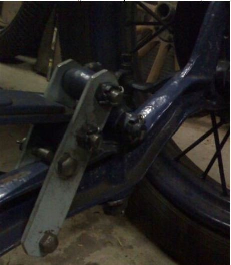

No photos Steve. It was a simple 1/8" plate with three holes for the mountings. Two were to fit the U spring shackle, the third was inboard and picked up the bolt which clamps the spring clip in place. Having mapped the holes, we trimmed the plate to shape and added a series of holes to make it look a bit sexier.

Here is Allan's bracket, his son Anthony posted a photo of it on the old forum.
- Attachments
- front spring shackle bracket.JPG (30.44 KiB) Viewed 3877 times
- Posts: 7292
Re: Speedster Steering Issue
Peter, I'd forgotten that iteration of the bracket. It worked well, but to my eye, on MY speedster, it looked a little to agricultural. So I made the one I described earlier because to me it looked better and performed just as well.

Steve, Peter's posting of that first bracket refreshed my 26 year old memory of the later model I made. There were two identical brackets to the set-up. The shackles were deleted and replaced with grade 5 bolts. the long end of the triangle was anchored by a longer spring clip bolt, the position of which can be varied to fit either the over spring bolt on early cars or the under spring bolt on later models.
I probably do have photos in one or other of the dead cell phones I can't bear to throw out, but I am not into cloud storage, indexing or cataloging.
Hope this helps.
Hope this helps.
