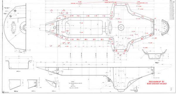

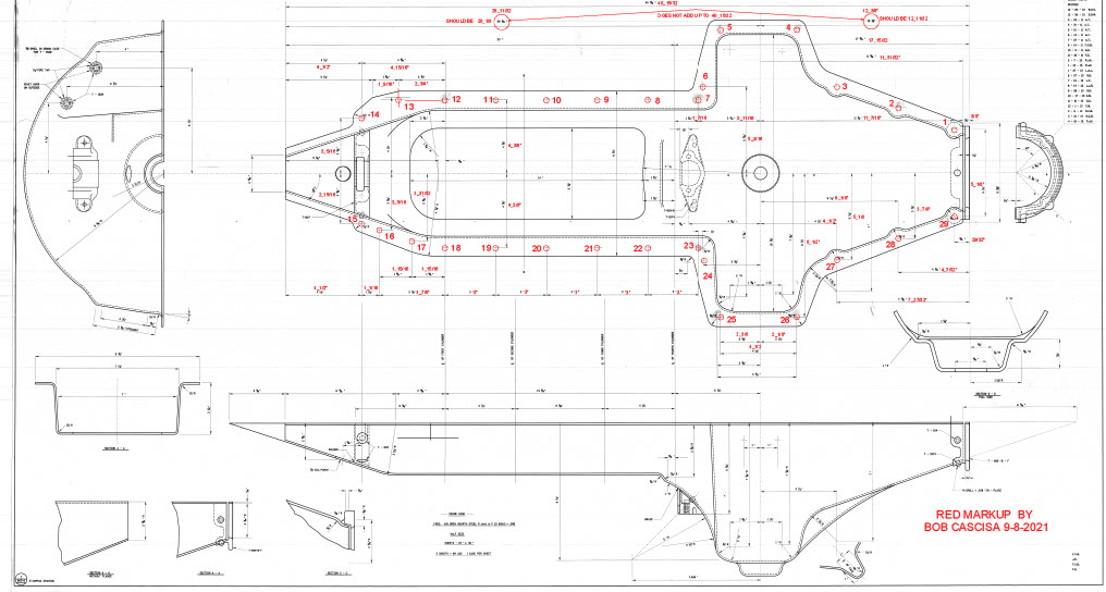

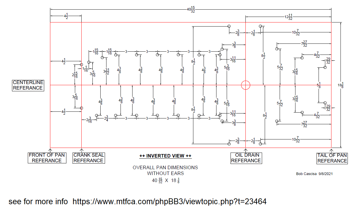

The link above has additional information and pictures and the PDF files
Here are file images in case you can't open a PDF file (click to enlarge). The PDF files would be better to use for printing

Thank you for the quick help. That's exactly what I saw once and it helps me. I am very happy for the help and the contributions here in the forum.
