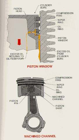

Were you looking for something like this https://courses.washington.edu/engr100/ ... 0Rings.htm
piston rings.png (189.43 KiB) Viewed 1783 times
