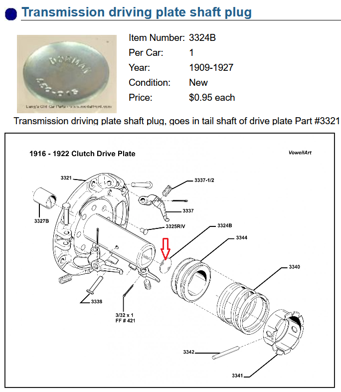

Motor oil can also migrate down past the soft plug in the driven plate.
- Posts: 1967
- Last Name: Tannehill
- Location: Hot Coffee, MS
- Board Member Since: 2002
Re: engine oil in rear end
Steve that’s a great point often overlooked. I’m not saying I’ve done this but a similar situation was happening on a friends T. His temporary solution was to loosen the rear axle to drop the driveshaft/tube out to inspect. He found 4th main was still decent, he used his shop light to look inside the tail shaft, after spraying brake cleaner in it he saw oil leaking out. Not wanting to pull the engine right away he took a large rubber cork formed it and drove it into the hole. That solved the issue. The temporary fix is still working a few years later. Ha
PS just so y’all know he got the cork at Lowe’s in their specialty section where you find odd automotive & furniture hardware, they even have knurled brass thumb nuts in various sizes.
Best John
Best John
- Posts: 5284
Thats a great fix for a missing steel plug. I am going to remember that if the situation comes up.JTT3 wrote: ↑Wed Jul 17, 2024 1:02 pmSteve that’s a great point often overlooked. I’m not saying I’ve done this but a similar situation was happening on a friends T. His temporary solution was to loosen the rear axle to drop the driveshaft/tube out to inspect. He found 4th main was still decent, he used his shop light to look inside the tail shaft, after spraying brake cleaner in it he saw oil leaking out. Not wanting to pull the engine right away he took a large rubber cork formed it and drove it into the hole. That solved the issue. The temporary fix is still working a few years later. Ha
Best John
However, in this case, getting progressively worse,(a missing plug wouldnt get worse quickly over time) it wouldnt fix OP's problem.

Do you know if you have plug?
- Posts: 7312
I do not use the concave plug in the output shaft. They can be cocked, and subsequently leak. Instead I use a cup type plug. 1" diameter, driven in square to the bore. They do not shift.
I have the exact same problem with my Fordor. This fall after the season's over I'm gonna try the above fix. Gonna plug it up somehow, rather than pulling the engine again! It's been out twice already...I don't wanna subscribe to the adage "3rd time's the charm"!speedytinc wrote: ↑Wed Jul 17, 2024 1:22 pmThats a great fix for a missing steel plug. I am going to remember that if the situation comes up.JTT3 wrote: ↑Wed Jul 17, 2024 1:02 pmSteve that’s a great point often overlooked. I’m not saying I’ve done this but a similar situation was happening on a friends T. His temporary solution was to loosen the rear axle to drop the driveshaft/tube out to inspect. He found 4th main was still decent, he used his shop light to look inside the tail shaft, after spraying brake cleaner in it he saw oil leaking out. Not wanting to pull the engine right away he took a large rubber cork formed it and drove it into the hole. That solved the issue. The temporary fix is still working a few years later. Ha
Best John
