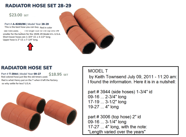

No, it's not what you think. Im not revisiting that topic again. but, want to offer something out to the group. I guess I have an aftermarket T radiator that came on my 27 Depot Hack. My hood shelves are a good 1" gap from the bottom edge of the hood sides and my hood hold downs are stretched to the limit, but do manage to clip on.
But, my upper radiator hose was too short for the replacement kits from the vendors. My upper hose, instead of the standard 2" diameter by 4 inches long is almost 8" long.
Long story short, I purchased 2" diameter black rubber hose and cut mine to length and it looks and works great. But, I had to purchase a 36" length from NAPA to get this hose. I see no need to put the remaining 28" on the shelf. So, if anyone else has the need for a slightly longer upper hose , if you cover postage, I will gladly cut to lenght what you need and give it to you.

I had posted this back then. For 1917-27 get a Model A hose set, trim to fit

That would have worked as well. but, only the 30/31 set would have given me the needed lenght for the upper hose. But, it would have worked as wel. Thanks for that info.

I bought a hose set from Lang's for my '27 in 2014. The upper radiator hose is six inches in length; it fit perfectly.

As I mentioned, my radiator is an aftermarket and appears to be higher than the standard Model T radiator, hence, the need for a longer hose. But, I have read previous years threads about other having a similar need. I am sure with thousands of hoses sold, the vendors have the correct length for the correct fitment.
