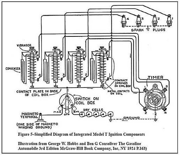

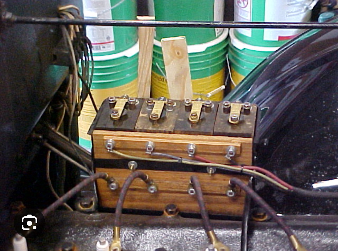

Sitting the driver seat, which coil box is #1?
It appears that with the #1 cylinder at TDC, the coil on the left is buzzing but it's connected to #4 cylinder?
Been looking for a drawing without much luck in the Recourses pages.
It's a sunny day here on the coast and wife want to go for a ride.
I'm trying to start it again after installing new generator and timing gears.
Something isn't right. I have fuel in the carb but not firing.
So I'm going through the ignition now.

Re: Coil numbering?
Courtesy of Randy Stevens, just FYI if your coil box is mounted on the engine 26/27 style it’s reverse of the picture of the earlier firewall mounted coil box.

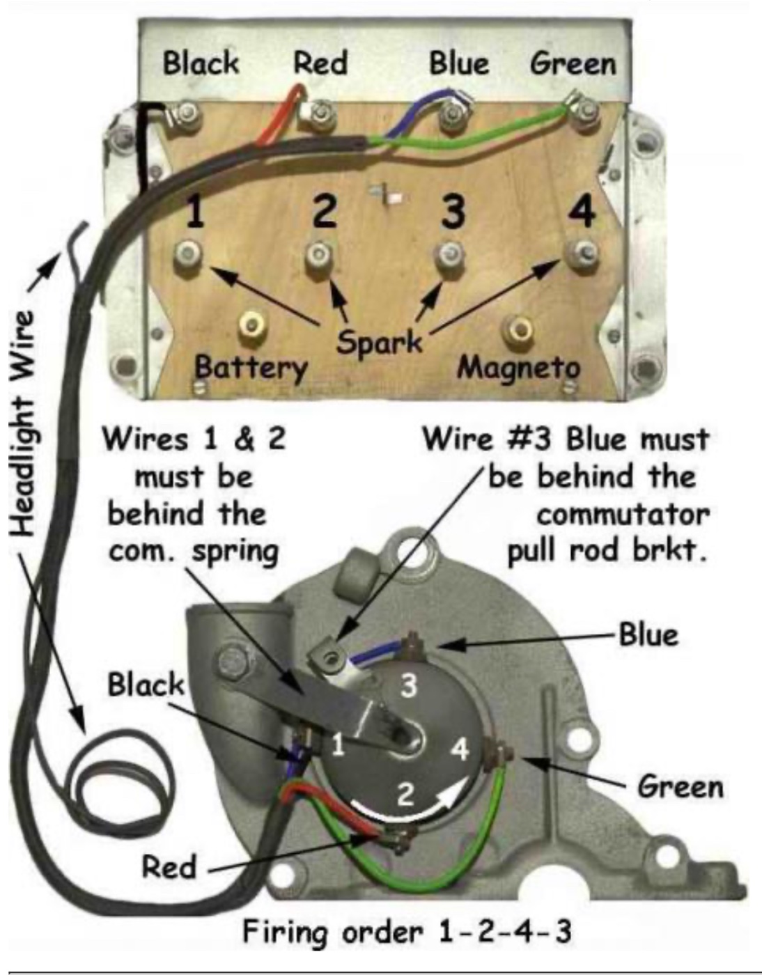

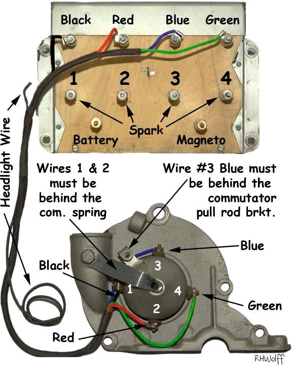

Re: Coil numbering?
This help?

Thanks to everyone for the information and drawings!
Pretty sure I got it figured out.
Edit:
I flopped the roller assembly under the timer cover, and it started on the first try!
Drove it down to the gas station, topped off the tank, drove wife, sister & neighbor around town.
I think I'm ready for the parade.
Thank you to every who helped.
