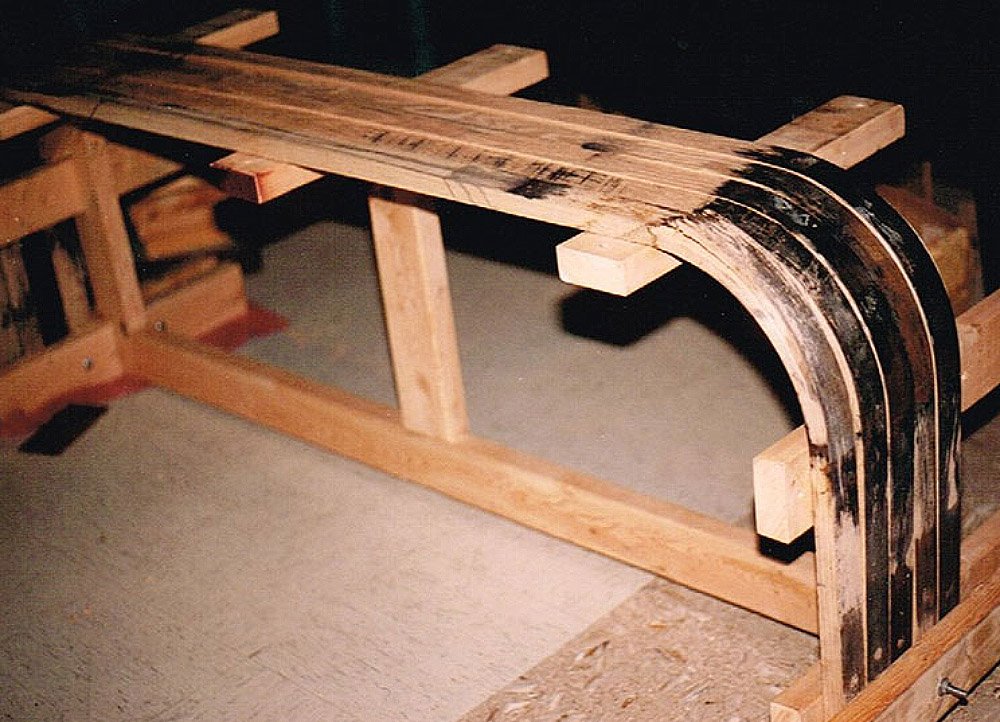

Bending 8 felloe sections 8 at a time is impressive. Note that the blanks were set between massive stops to hold them in place. This means the felloes are bent under compression. The outer diameter of the felloe is set by the stops. The inner diameter is reduced under compression. This means no break-out on the outer diameter. The guy in New Zealand who makes lovely wheels uses the same process, albeit, by boiling the timber blanks rather than steaming, and making them one at a time.

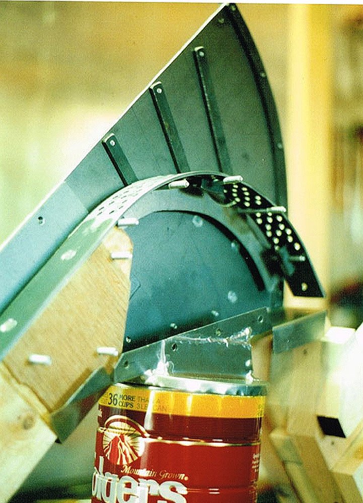

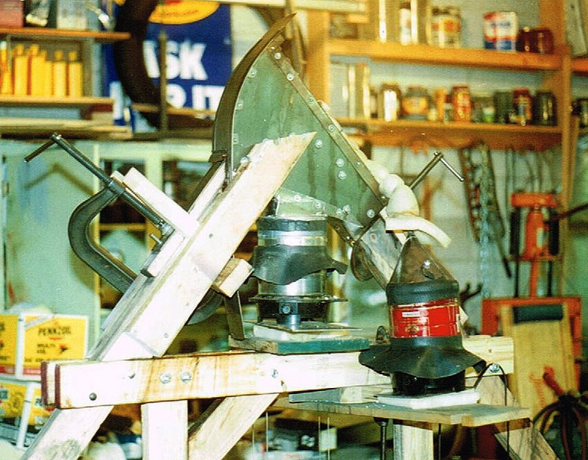

Regarding steam bending felloes: Bill Calimer has a similar set up at his wheelworks.
https://www.youtube.com/watch?v=r9EUfl6kNc4

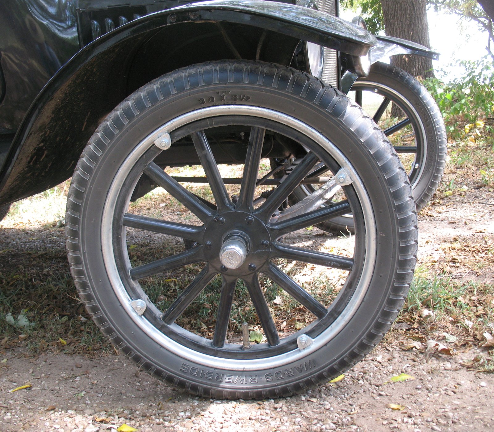

Cad [cadmium] plating is yellow. The Ford demountable rims were electro plated zinc. Silver metalised paint is a very close match to the original zinc plating.

John, silver paint (Oklahoma chrome) is often used on demountable rims to simulate zinc plating (galvanizing). I don't know where the "cad plating" superstition originated. That process was commercially adopted in the thirties after Model T production ended. The wheels shown in the film, no later than 1918, are non-demountable. Those rims were painted body color, like the rest of the wheel.
Non-demountable (1915): Rim painted body color.
Demountable (1923): Rim galvanized.

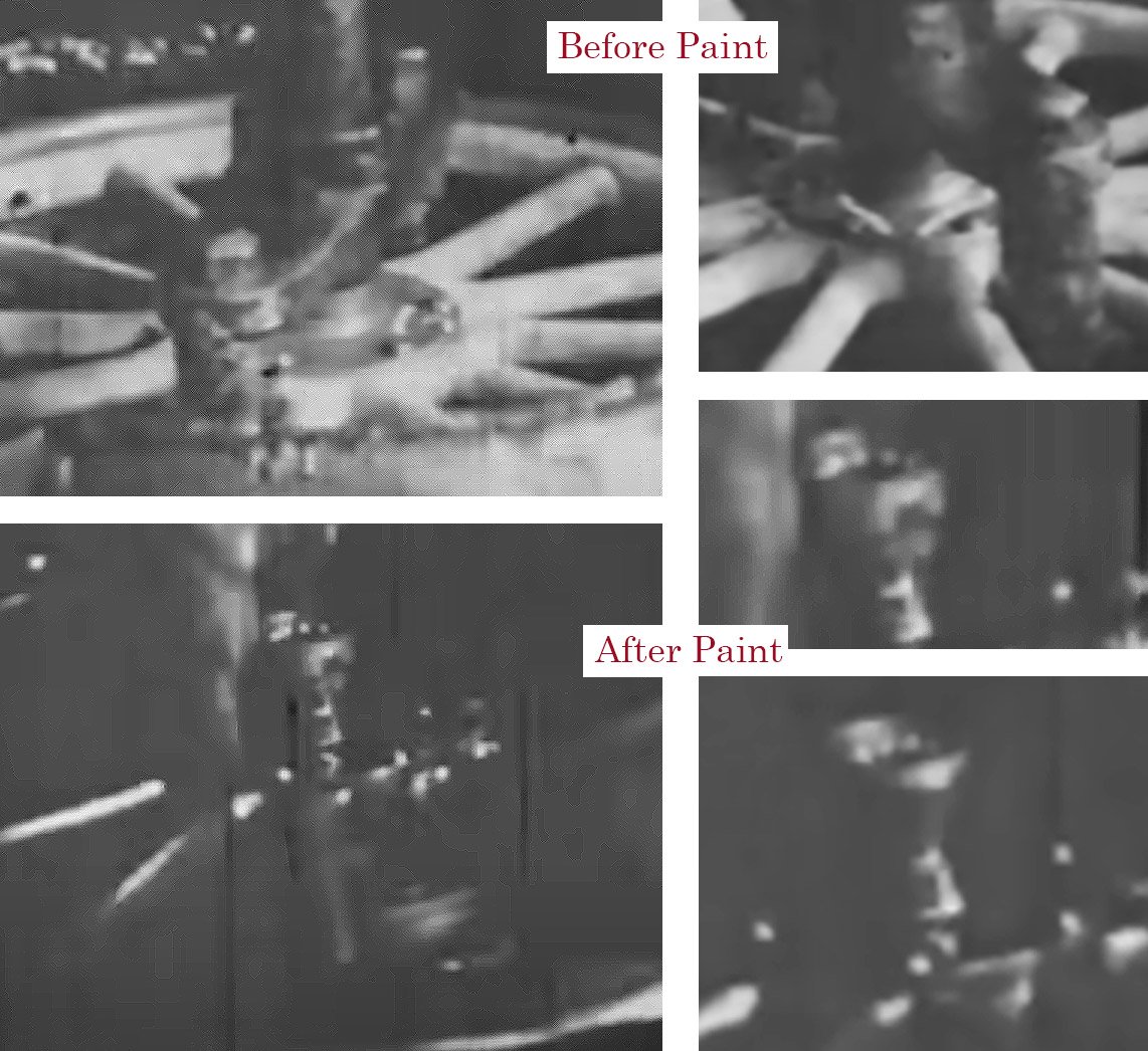

Did anyone else notice at about the 1:50 mark the last fellowe he puts in gets misloaded?

Relating to Steve's question about the date of the film, I noticed that the front hubs were the "machined" hubs that were used on 1915 and 1916 Fords. The threads for the hub cap are shorter than the early front hubs, so it is safe to say that this film was made around 1916 or possibly 1917. Also, as we restore our Fords, many of us take a great deal of time sanding and filling the wood spokes and felloes so as to get a beautiful, smooth finish. I think it would be more "correct" to just paint the wood and leave all the wood grain and imperfections. (Does "Original Smith" have any comments?) I hope this helps, Russ Furstnow
