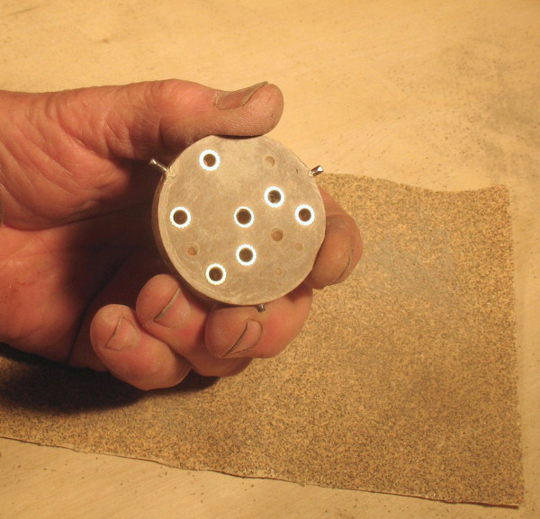

I don't know if Ben or anybody else is still rebuilding switches, but if a switch suffers from the common problem of a warped backing plate it's not hard to fix that yourself. Rubbing the plate on rough sandpaper does the trick. If that makes any of the stops too shallow, careful application of a drill bit can deepen them.

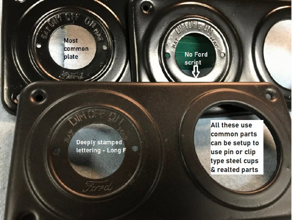

It will help to see the face & rear backing plate & why you feel you need it. I'll email you so you can send pictures or add them here. I'll can help you restore your switch or repair it for you.

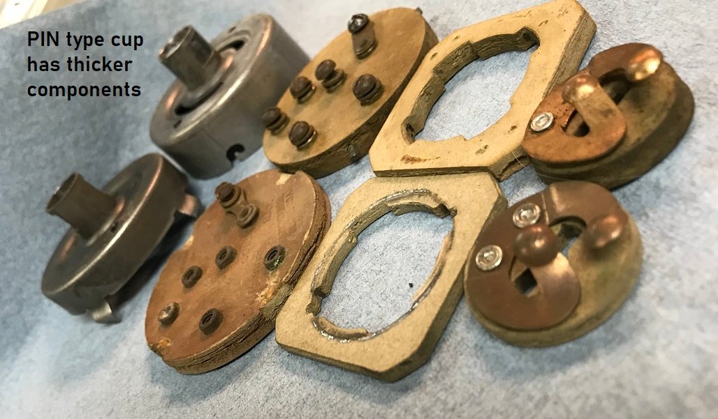

This a picture of the internal parts for the Clip & pin type assemblies
These plates usually have common parts.

Do you know if it's a pin or tab-over style ? Pin type much easier to work on. Not much to them unless the the key cylinder has issues.
