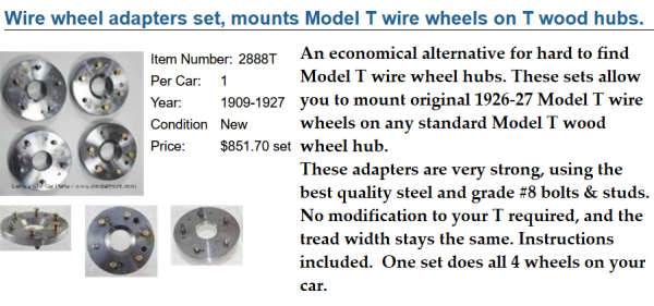

Choices involving time & money
1. Get a 1926/27 large drum rear axle housing, brake set and rebuild it with your exiting axles, bearings & differential etc
2. By a set of Wire Wheel Adapters & sell your 1926 hubs (wood wheels & tires) to offset the costs
currently listed Nice pair of front wire wheel hubs. No welded studs. Threads look great. Price is $300 for the pair plus domestic
estimate Rear set of hubs $200 -300+ depending on drum condition
3. Make a set of adapters
