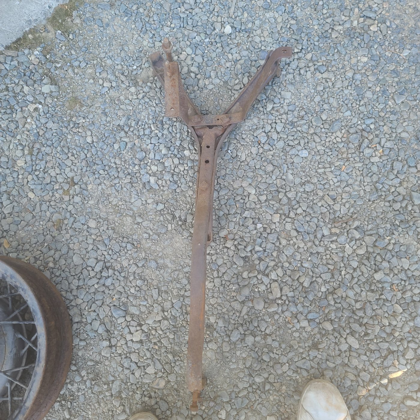

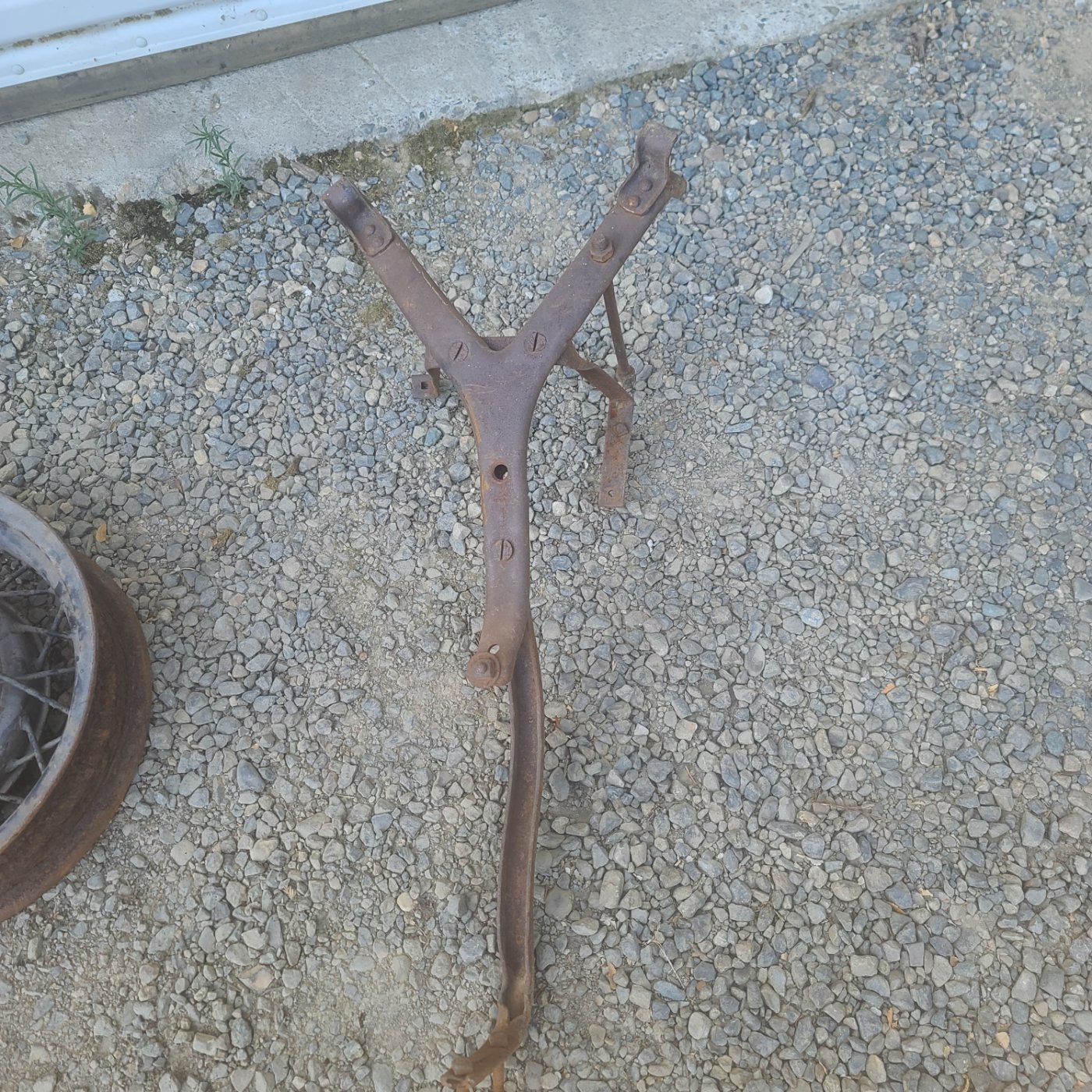

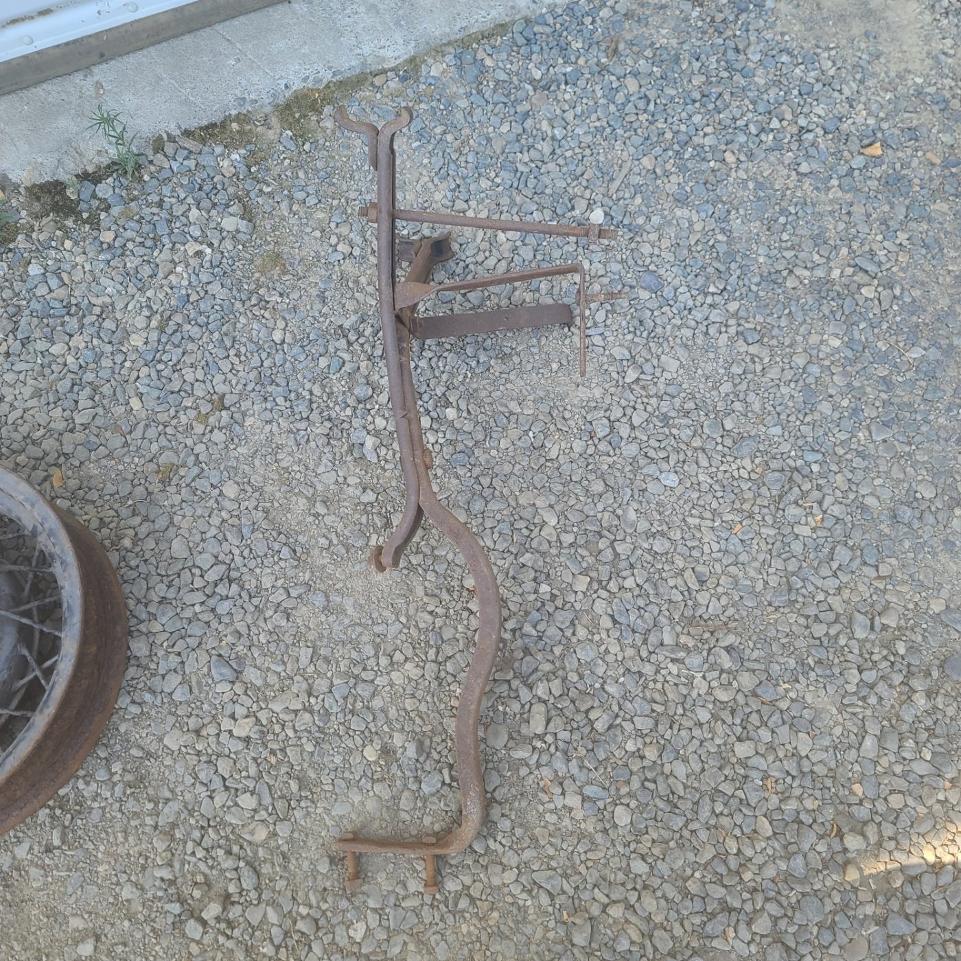

Can someone tell me what this model of Model T this spare tire carrier fits? Thanks. Neil

Modified ‘25 style for split rim by someone for a truck or hack. The lower leg to the running board, for side mount.

That lower leg possibly being a modified running board support bracket from a 20s frame.
