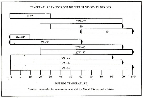

Use 10W-30 or, if you like single weight, SAE HD-30 (detergent). If you are going to do winter driving, you could use 5W-30.
The only non-detergent oil you are going to find are single weight such as SAE 30 or SAE 40.

There really is no "best" oil for your Model T. Its more a question of preference, and some oils containing friction reducers should probably be avoided. Any good quality multi-grade or straight grade (in warmer temps) will work fine. Yes, detergent oils are better than non-detergent oils particularly is you have a rebuilt engine with clean internals. Considering the lubricants used "back in the day" our cars are loving the stuff we feed them now regardless of brand.

As stated above any good detergent 10w30, 5w30, or something in that range is way better than what was available in Henry’s era. The house brand oil from the dollar store, Auto-zone or Walmart works just fine for me. And by the way using the screen oil filter that goes under the transmission cover door is a cheap investment. It really does work and an aftermarket item the Ford should have thought of! My opinion of course!

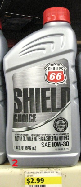

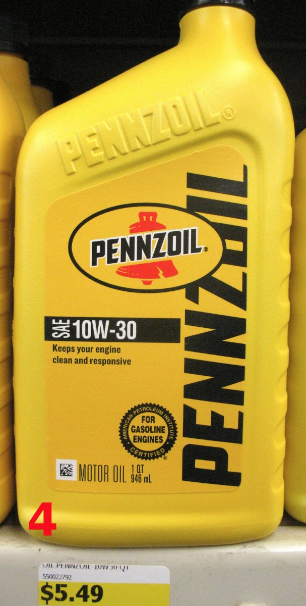

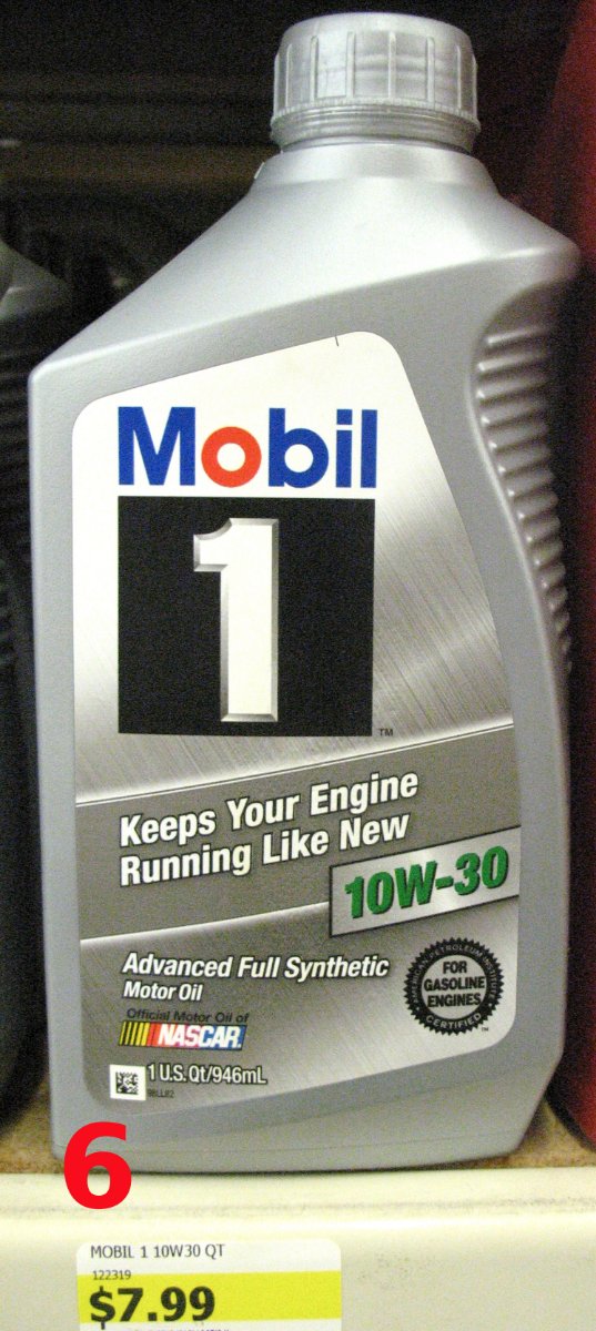

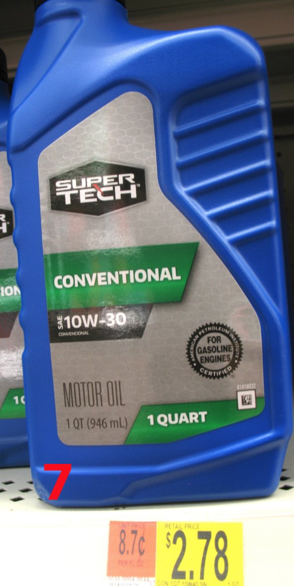

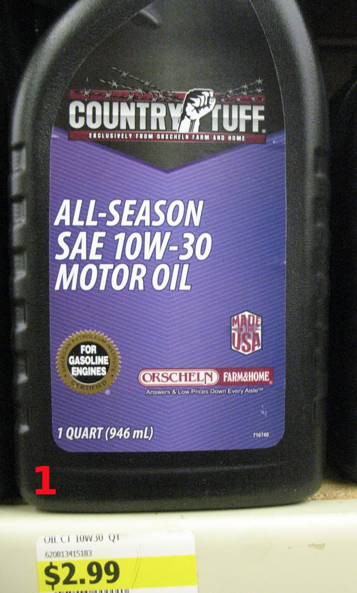

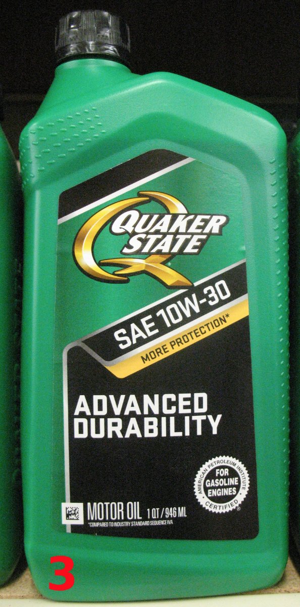

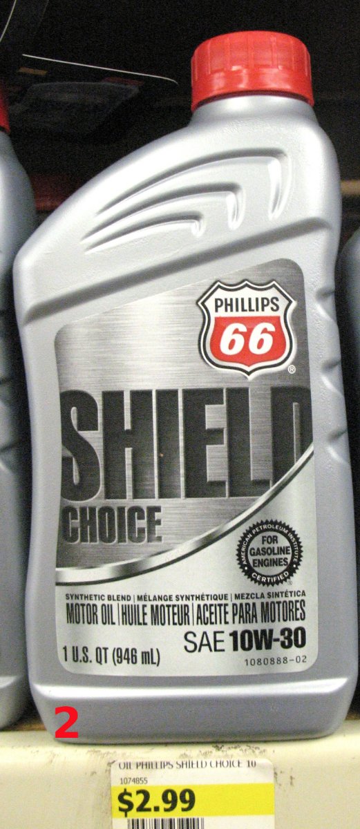

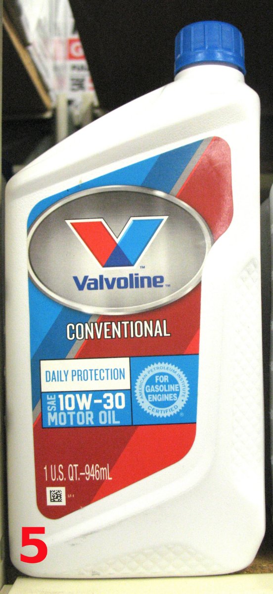

Let's go shopping. Just so we'll be comparing apples to apples, we'll restrict our choices to conventional 10W-30 motor oils. Here's are some we find at Walmart.
1 quart Chevron....................$4.42
1 quart Pennzoil....................$4.68
1 quart Quaker State.............$4.24
1 quart Valvoline...................$4.47
1 quart Super Tech................$2.78
These all have the API certification mark (Starburst) on the container. https://agriculture.mo.gov/weights/fuel ... icants.pdf
Which one is best?
Why is it better than the others?
Are any of them unacceptable? Why?
Which one is best?

- Posts: 7392
Re: Best oil, I’m almost afraid to ask...
As long as the oil meets the standard, I think you are fine.
I found some interesting info on house brands here: https://www.bobistheoilguy.com/forums/u ... Super_Tech_
I've always suspected the reason for the notable cost difference has to do with big advertising budgets or the lack thereof. Ray H in So Cal seems to agree:
"The only problem with SuperTech motor oil is that WalMart doesn't promote "image" by packaging it in macho designer bottles with hex-head caps, scent the product with extract of fruity candy, or spend lavishly on TV ads touting their motor oils' use at Le Mans, Indianapolis, the Pike's Peak Hill Climb, the annual Soap Box Derby, and as original factory lube for Schuco clockwork car repros, Cracker Jacks clicker toys, etc."
So far nobody has explained why an oil that meets the API standards is inferior to other oils which meet the API standards. Lots of folks imply that, but I'm waiting to see evidence that backs up the implication. I'm perfectly willing to buy one of the big name brands when empirical evidence persuades me of its superiority.

There are many classifications that make up "API standards". Each is for a specific use, so saying you use "motor oil that meets API standards" is meaningless unless it makes you sleep better, and I suppose there is value in that.
If I want to slip and fall down on a concrete floor, any oil will do...if I wish to protect my engine with some certainty, I use known oil with atributes I desire, in a viscosity of my choosing.

Scott, thanks for the excellent link. If I understand correctly what I read, it confirms what I thought: 1 The API sunburst shows that the oil has been rated by the American Petroleum Institute; 2 The API donut on the container tells the characteristics of that oil. I looked at oil on the shelves at a couple of local stores. Here's what I found.
- Posts: 7392
Based on the information provided by the API, which of these seven is best? Why? Is there any we shouldn't use? Why? If the API donut isn't enough, what criteria should we use in choosing an oil?

- Posts: 7392
Yes, I read that page when I looked at the previous link. Based on the donut info, I surmise that all the oils I checked would be OK, and that #2, #3, and #7 (SN PLUS) would be the best. Here are the containers bearing the seven donuts pictured above.
- Posts: 7392
I meant to include just conventional oils, but I see that this one is synthetic.

I can see where some might think if the price is low, then the product may be inferior due to the manufacturer cutting corners, etc. But let me play devil's advocate for a minute. If the price is high, why would someone assume the product is better? I've had good wine that was $4 a bottle and bad wine that was $25.
Charlie B in N.J.
- Posts: 782
- First Name: CHARLIE
- Last Name: BRANCA
- Location: Brick N.J.
- Board Member Since: 2010
I got my head handed to me a while back when I questioned "the cheapest I can find". There's a lot of guys out there that seem to enjoy experimenting with their T's. Engine oils, diff lubes, various coolant types, etc. Either their doing it or telling other's their doing it. I constantly ask when ever this comes up: do you do the same thing with your modern? If not why? 5W-30 to answer your question and not the cheapest either.
Hal
Hal - I can "relate"! Actually, changing the oil in a Model T is very quick and easy to do, as you don't even have an oil filter to bother with! The thing that makes the job time-consuming, and just plain awkward and miserable is,....what to do with the drain oil, right? My Dad used to use drain oil to hold down the dust problem on the gravel road that passed in front of the house before the road was finally paved years ago. Today however, that would be considered a "horrible" ecological "sin", but then I never could figure that one out, because really, what actually "IS" asphalt, right?
- Posts: 7392
If price is the best indication of quality, it's easy to decide which oil to use. Buy the one with the highest price.
- Posts: 7392
I dump it in a five gallon plastic jug. When the jug is full I take it to the local O'Reilly for recycling. I expect other parts outfits would take it too.....what to do with the drain oil...?
