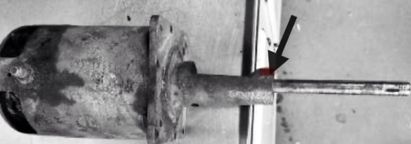

Perhaps a silly reply to the question.
But once removed a starter that had a good portion of the nose (arrow) ground away to satisfy such install.
Photo for illustration only.

There is no reason you cant grind a notch in an earlier field coil ring. Did it to the last starter conversion, also a 15.
The notch is there to clear the shaft.
The starter nose housing is not involved & needs no modification.
