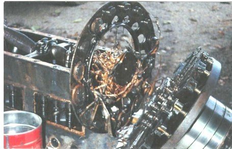

I strongly suggest youfix .042 endplay or your gonna have a problem that could run $5-7 thsound to fix.
See attached. Ron Patterson

It's already running that much and the only bad thing to happen was the loss of a magnet plate!Ron Patterson wrote: ↑Sat Jul 27, 2024 5:56 pmI strongly suggest youfix .042 endplay or your gonna have a problem that could run $5-7 thsound to fix.
See attached.

CW, you should not waste money on a lottery ticket. If you lost a magnet plate with no extra damage, you have already won the lottery!

.042" endplay and only a plate? you are absolutely correct
