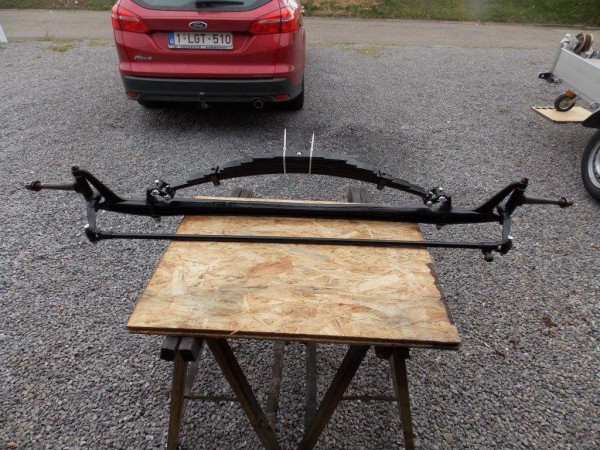

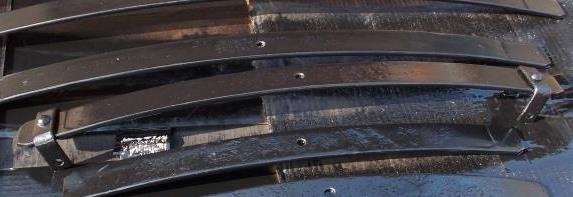

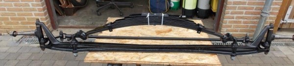

Here is a front spring with the same construction.
I rebuild the front axle and as the spring was solid I just installed the leaf as it was.
Andre
