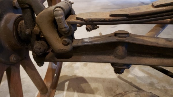

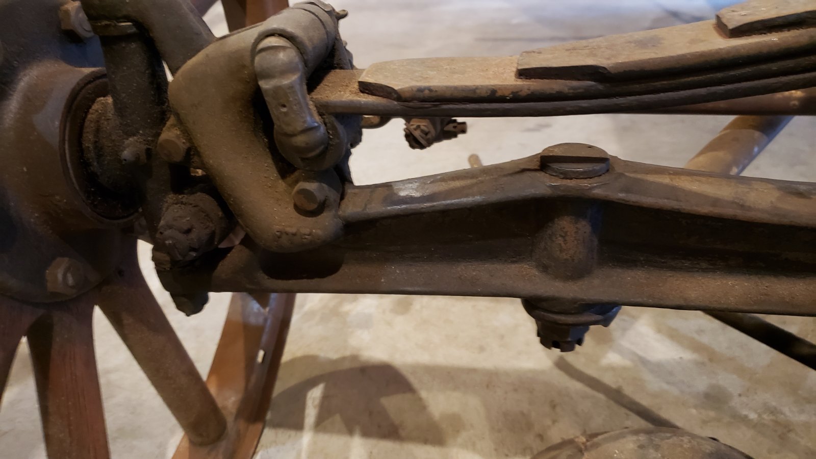

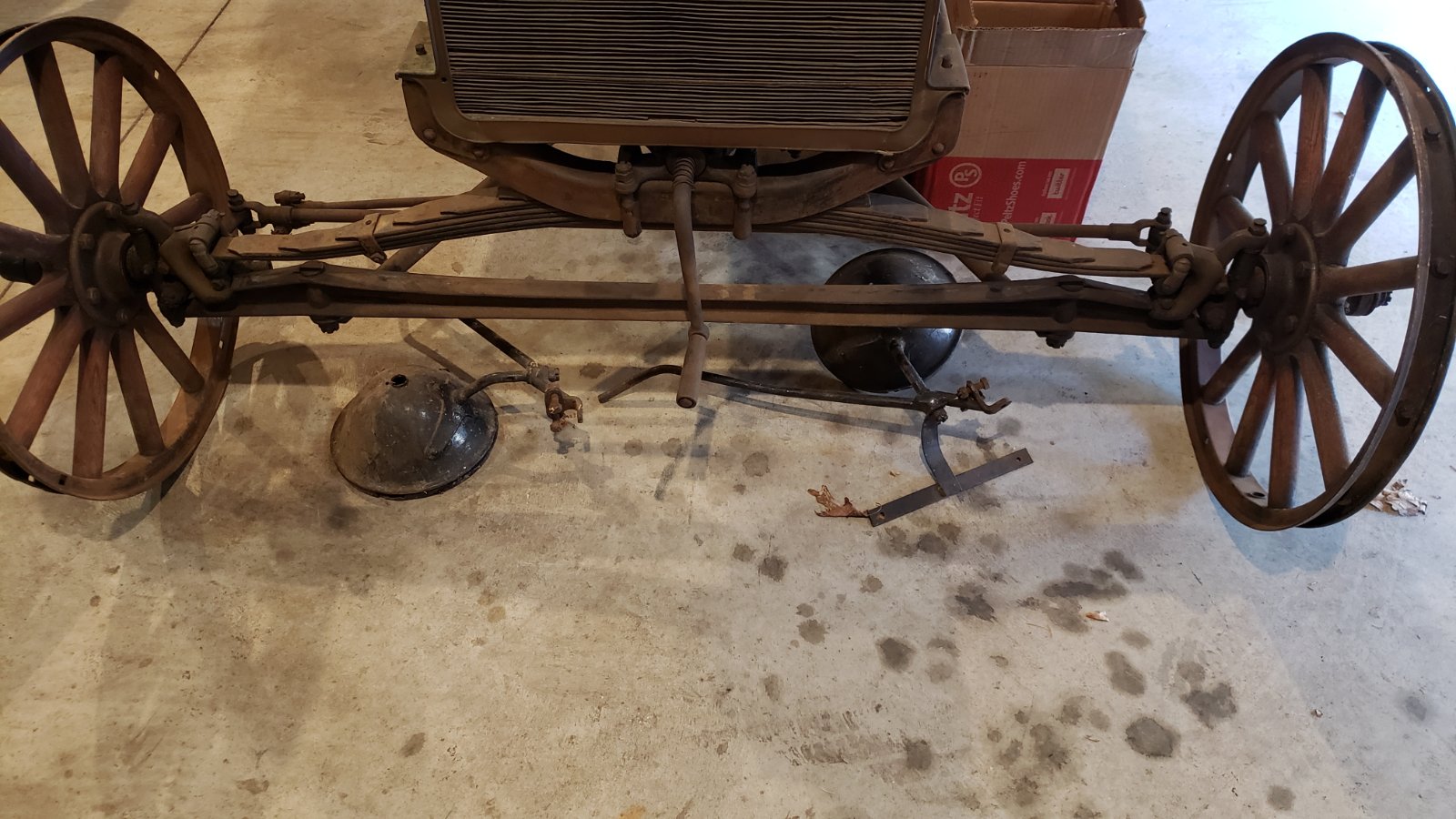

Can anyone tell me what parts need to be replaced to convert to a bottom mounted wishbone? Or am I better off just adding a wishbone support from one of the vendors?

Mechanically you'll need a different wishbone ((2733B) and nuts (3821B). Aesthetically you want different perches (3818B & 3819B). That's for just switching to the later wishbone.The accessory support is a good idea, but I'm not sure what extra parts it requires. I expect the parts dealers can answer that.

Is there any difference in the axles between top and bottom mount wishbone? The car is a 23 but has the older style wishbone. I’m starting to wonder how many cars went into the making of mine.

With a pre 1919, I would recommend an added brace to keep the car correct (not enough '17 to '18 Ts still have the right style as they have been changed out over the years.
However, anything after 1919 should have had the under axle wishbone, so I would recommend replacing with correct later parts. (How can you argue against stronger and safer when it is also more correct.
The only parts that need to be replaced are the perches, nuts, and wishbone itself. However, changing perches in the axle can be a tough, annoying, and often damaging project. I would recommend getting a later axle with good perches or an axle with no perches and install the later perches. Unless yours is really nice or already rebuilt, now would be a good time to rebuild it. If yours are really nice, you can use your spindles and peripheral pieces on your replacement axle.
The bonus is, that the earlier over axle wishbone and perches are considerably more valuable than comparable later pieces. And you may want to check if the axle itself might happen to be a Dodge Brothers stamping. The Horseless Carriage crowd goes crazy over those.

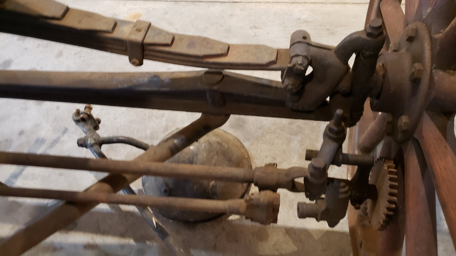

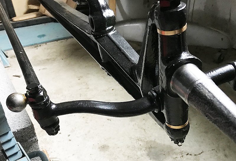

If you have the straight steering arms that go with the 1918 and earlier over axle wishbone you will need to change them to the later type offset arms
to clear your new under axle wishbone.

I quote Kmatt "if you have the straight steering arms that go with the 1918 and earlier over axle wishbone you will need to change them to the later type offset arms to clear your new under axle wishbone."

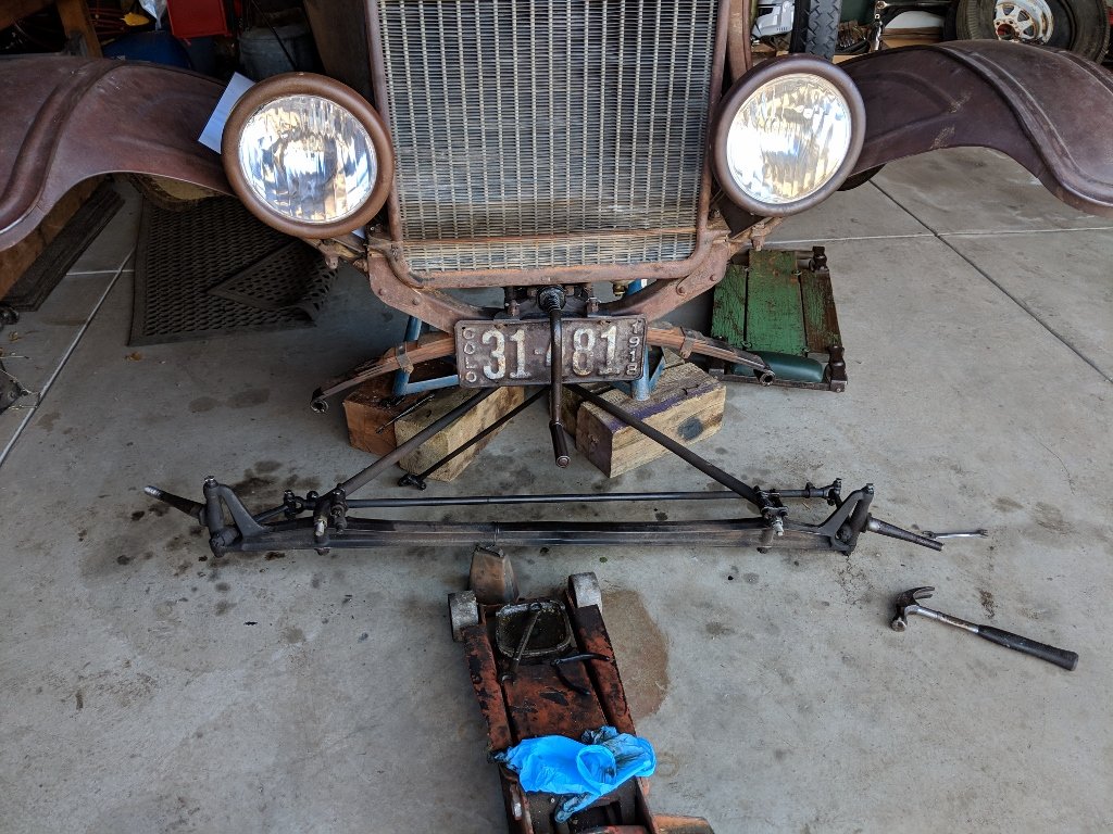

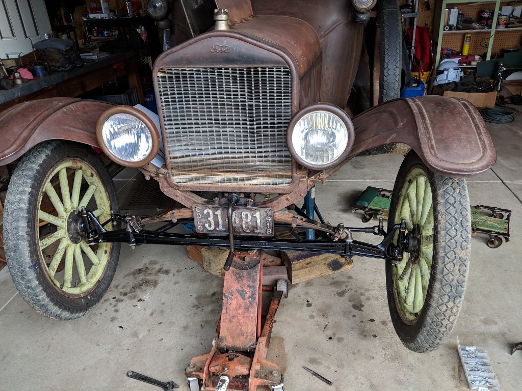

I have a 1917 with an over-axle wishbone. I've fabricated an auxiliary under-axle wishbone which I have yet to install (engine isn't back in yet either.) Do I need to install different steering arms? That's the first I've heard of anything like that.

NO you don't, the era accessory under axle wishbone brace meets up with the stock over axle wishbone in a way that it is not necessary to change the steering arms, in fact they were designed and used long before Ford's later design. I have a era accessory under axle wishbone brace on my 1916 express. When Ford designed the later under axle wishbone of 1919, because of the way it curves up to pan with very little bend to keep it as straight as possible they had to change the steering arms to the later type.

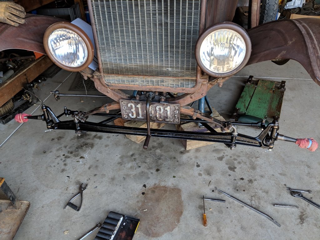

Thanks - I looked at my steering arms today and they are not the straight version as on earlier cars (see attached photo.) I think I'll be OK.
I got the idea to install an auxiliary wishbone after reading an account from the period of Henry Ford being thrown from a Model T not far from where I live when his speeding T his some soft sand and the axle knuckled under. Apparently it still took a couple of years for the wishbone to be changed as Henry had to use up the stock he had on hand. Obviously it was a known deficiency because people were adding under wishbones for years before the design changed.
