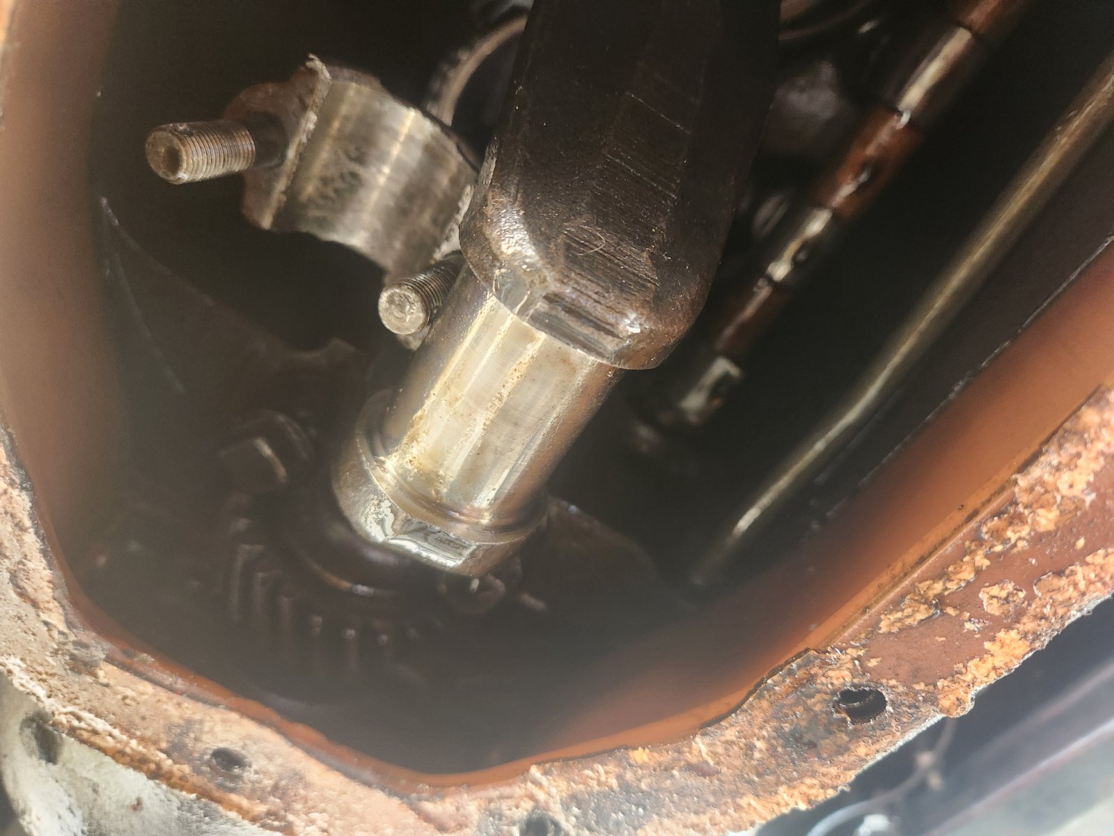

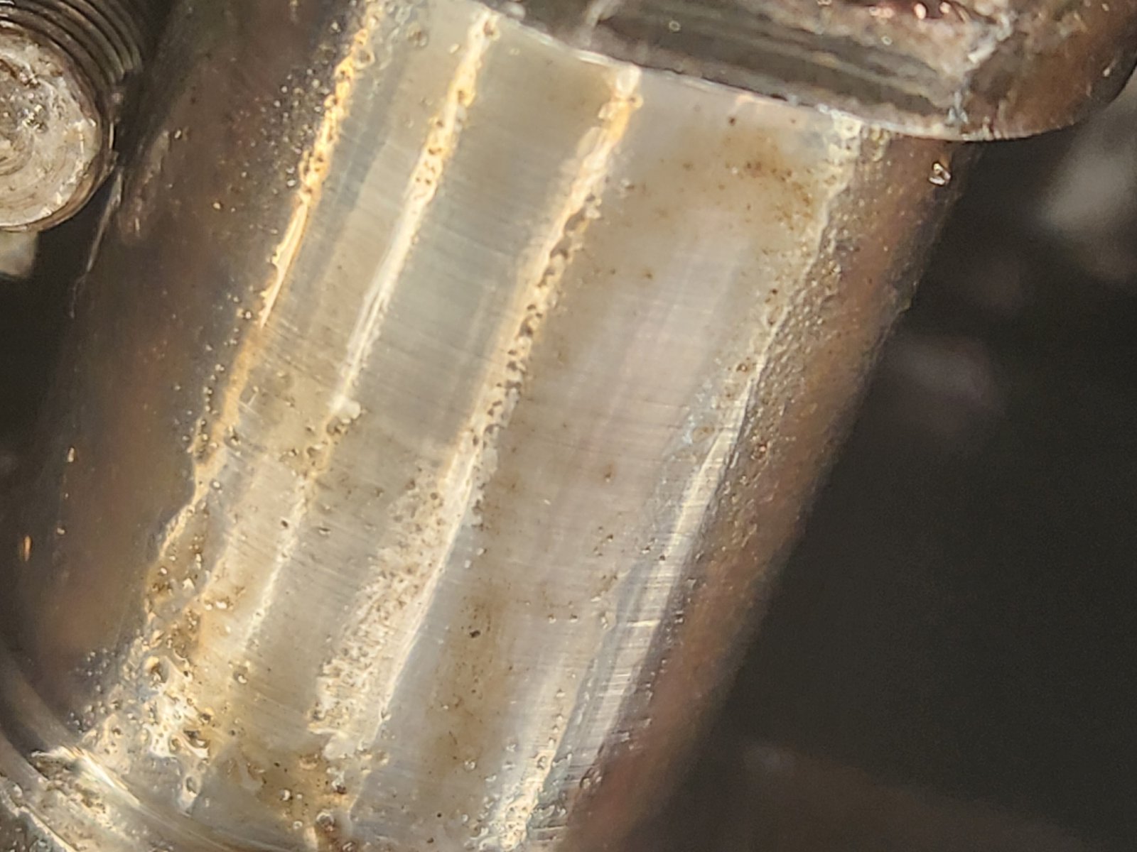

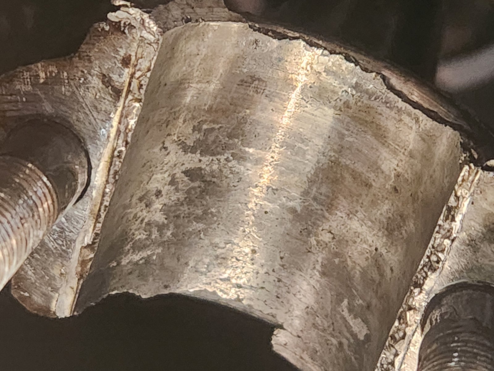

Ok so I took the inspection cover off, there were a few small chunks of Babbit in the dips (4 dip pan). I took the front rod cap off and it looked OK but the babbit in the rod itself was crumbling on the edges (see photographs), luckily the journal looks to be in good shape although I haven't measured for taper or out of round. I must also add that I fitted a mag post oiler and I try and run with a little more oil because of the hilly country. This car is also a daily driver and I put probably 300 miles on it this summer so I'm amazed that it held for so long. (maybe 45mph down the Truckee River was a little excessive but I'm 19 what can you expect lol)
Unfortunately, I'll have to wait until I trailer it out to Colorado where I have a proper garage to take the rods out and re-babbit them.

Well, that does not look so good. You've at least got rod troubles. Hopefully, not mains too.

How do the wrist pins feel? How loose was the rod on the crankshaft?

Joe,
The rod wasn't as loose as I expected it to be but it did have a tiny (could barely feel it) amount of vertical play and a nonzero amount of end play. also, the wrist pins seemed tight but the engine has .060 positions so I wouldn't be surprised if the little end is generally tighter. I think I'll just put it back together so I can get it onto the trailer and really tear into it in CO.

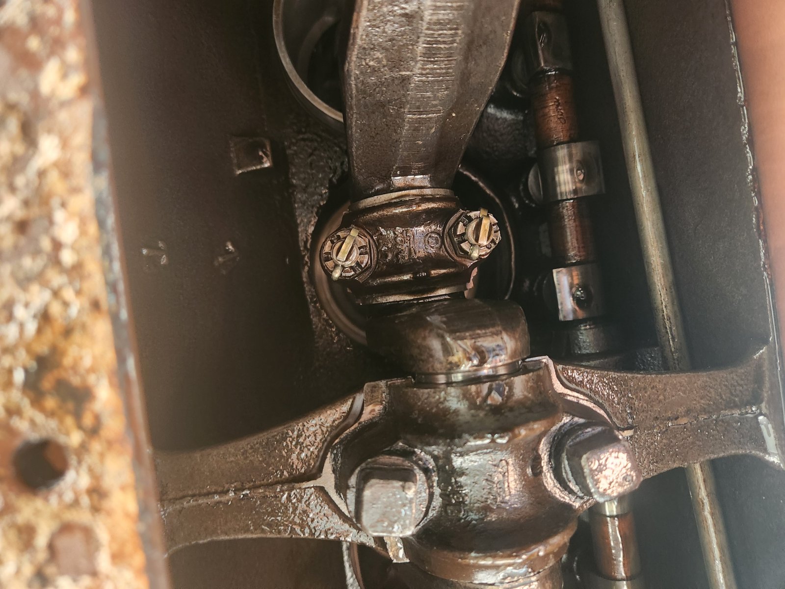

Well I found a new rod with good babbitt and after scrapping and fitting, it seems to have solved the problem (thank gosh for alloy pistons idk how you would get the bottom ring in otherwise!). Just for kicks I tried to tighten the other rods, but they locked the engine so I'm taking that as a win.

Good job John. Good idea to check the others while you had the bottom cover off. When I did the rod on my barn fresh buckboard, I took out the horseshoes around the pan and cleaned out a swag of crud and carbon at the same time.
We were having difficulty getting the bottom ring up the bore until a local diesel mechanic came by. He used the ring compressor we thought would never fit!
I love the way some of these none to exact fixes work. I did not want to disturb the patina on my old car, not even to take the head off. So we did what worked. I did measure the crank out of curiosity. It was smooth, a little oval and a little tapered. Given the rest of the motor is likely to be just as worn elsewhere, there was no point fritzing about something being a little less than perfect. When i first started the car after her 62 year slumber, she started and ran like a beaut. My son switched to mag on the dash and she didn't miss a beat. How good is that? Two days later while idling as I opened the workshop door, The generator came to life too, and still works, untouched, some 7 years later.
