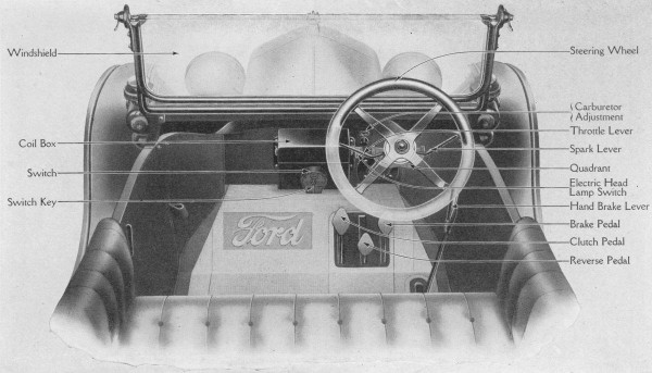

Roscoe Scheller’s book _ Me and the Model T_ contains an anecdote where Ford dealer Scheller and his crew move the handbrake lever from the left side to the center of the car for a one-armed right-handed customer who will only buy the car if they do that for him.
The fellow ended up being an enthusiastic repeat customer and Scheller made this modification on a number of Model T Fords for him.
Unfortunately, Scheller does not go into detail about the modification… So, how did he do it? Any guesses?
I myself am sort of in the same boat as that customer and would really appreciate having a centrally located handbrake lever.
Kelly

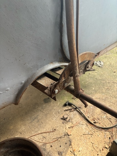

I know this isn’t the middle but I had to relocate the handbrake lever to the outside for my speedster I’m building. You can move the lever anywhere on the shaft then make a bracket to hold the quadrant.
KellyJons
Posts: 59
Joined: Sun Apr 30, 2023 11:07 pm
First Name: Kelly
Last Name: Jons
Location: Chardon, OH
Re: Moving the handbrake to the middle
Post by KellyJons » Sat Aug 03, 2024 11:26 am
Brilliant! Thank you, Corey.

I don’t have Sheller’s book in front of me (loaned it to a friend), but I seem to recall that he said this was a quick and easy modification to make. Corey may be on the right track… if you can easily move the handbrake lever to any location on the shaft, move it to where you want it, fix it in place, cut a new slot in the floorboard, and then come up with a way to deal with the ratchet quadrant with your left foot.
