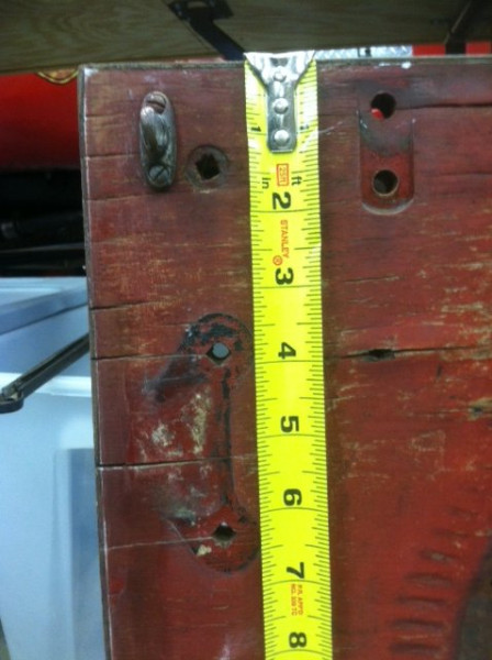

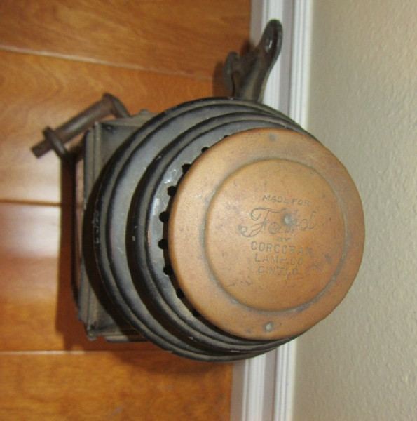

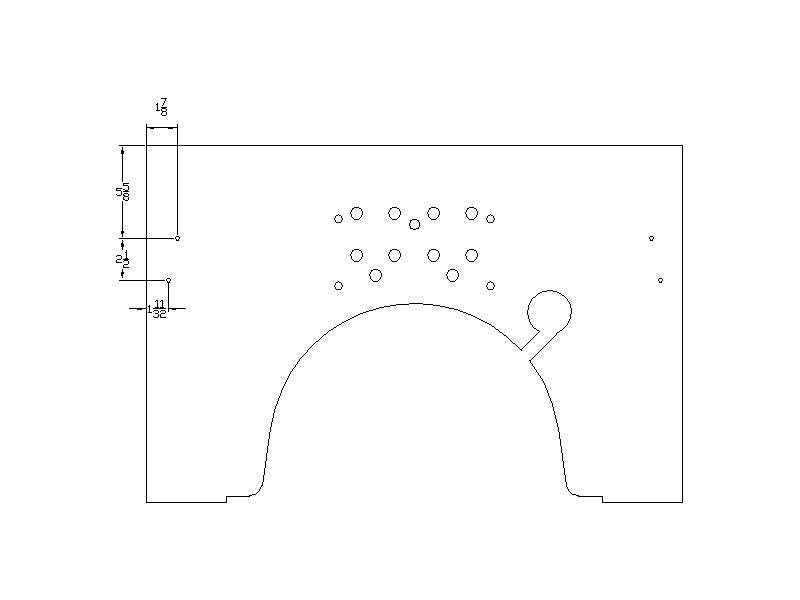

I assume there are no side lamp brackets on your car.....
If you don't want to change your firewall, or drill more holes in it, check the location
of the side lamp holes.
Your firewall side lamp mounting hole locations will indicate "integral bracket", or the
earlier "separate bracket". Would be my kind of luck to get a "pair" of the wrong ones!
If the two mounting holes are lined up vertical over each other with the top hole about
3-7/8" from the top edge of the dashboard, it was for the integral bracket lamps all the
suppliers made and the two holes are higher on the firewall. The firewall photo was from
an original firewall drilled for the integral bracket on a "August 1914" car.
The firewall drawing shows the earlier location style separate bracket stab mount. I have
attached a "integral bracket" Corcoran side lamp showing the top.

Thanks very much! My car was made in October of 1914, so I assume by then they were just using whatever parts they had on hand to finish cars, before they started the 1915 run with the cowl dash they used in 1915.
I did not have the original dash board, so cannot say how the holes were drilled, but I will plan on making it per the drawings you show, if I can find some Corcoran side lights. I have a fresh dash that is undrilled for the mounts, so I can put the holes in that I need, once I find a set.
As the other posters noted, there could have been any brand of sidelights on the car, depending on what the assemblers happened to reach for when they were picking up a set of lamps to install on the car. I doubt the assemblers even had the luxury of checking what lamps they were putting on. as the cars slid by them.
Thank you for the drawings and pictures! I may not get it perfect, but I would like to be as close to the correct configuration as I can get. I have time to search for the lamps, and will hit the swap meets at Famoso and Duncan next year. I do have other lamps that are mostly black, until I can actually find ones that are more correct. My headlights are black, but with brass skullcaps on them, and brass lens rings only. I assume the sidelights and tail-light would also be mostly black as well, since they were ending the reign of brass parts on FORD cars.
