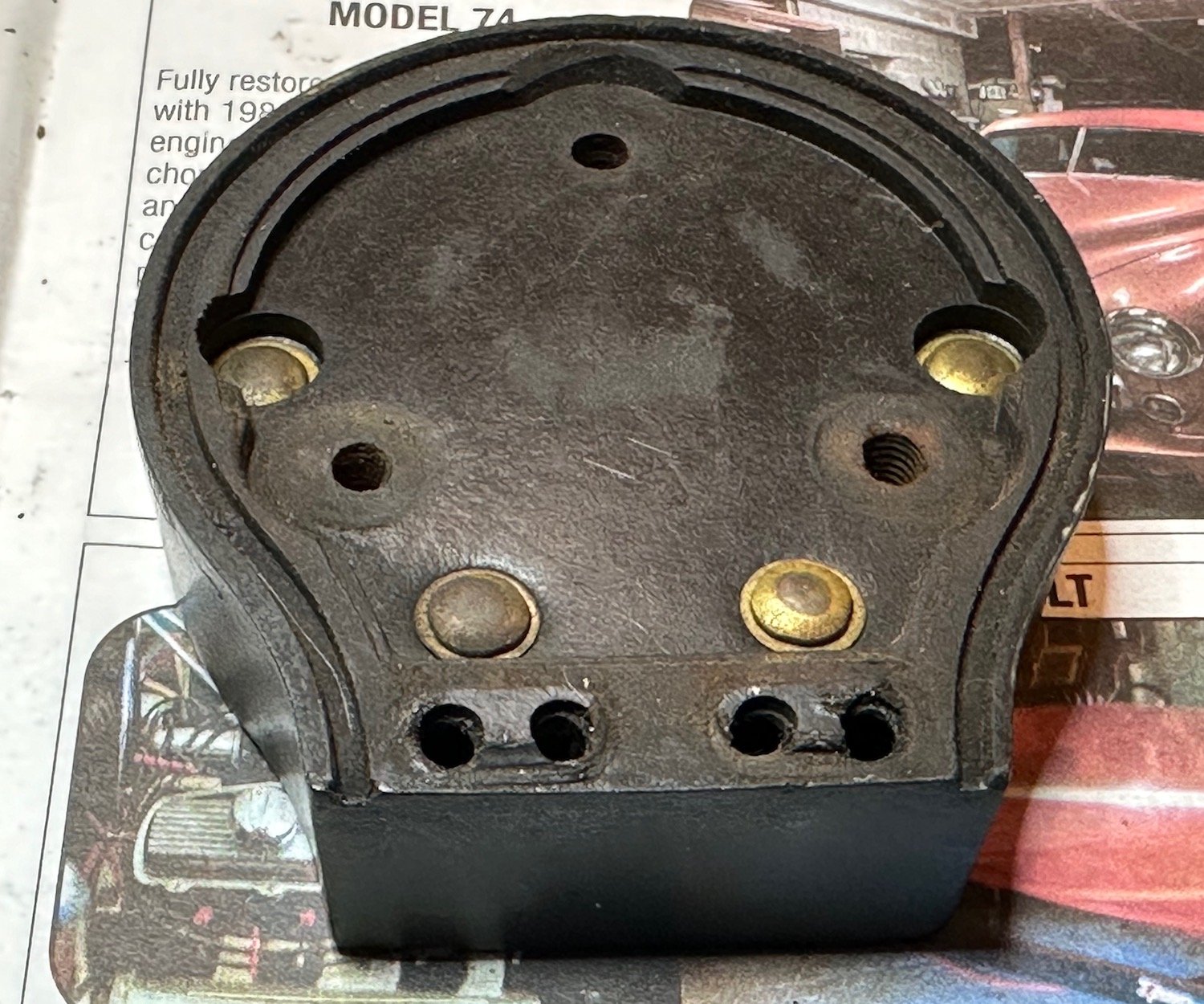

A couple of weeks ago I had prepared the '14 Touring for another test drive. I had done all sorts of tinkering and wanted to get another flush through the cooling system. It was completely ready to go, oil cups filled and I was looking forward to the outing. It would not start. It ALWAYS starts, but not today. The '18 motor turned over on the starter but no fire, not even a pop.
My schedule was full and "Ole Rough & Ready," the '23 Runabout was pressed into service to go to that car show in a neighboring town the following weekend.

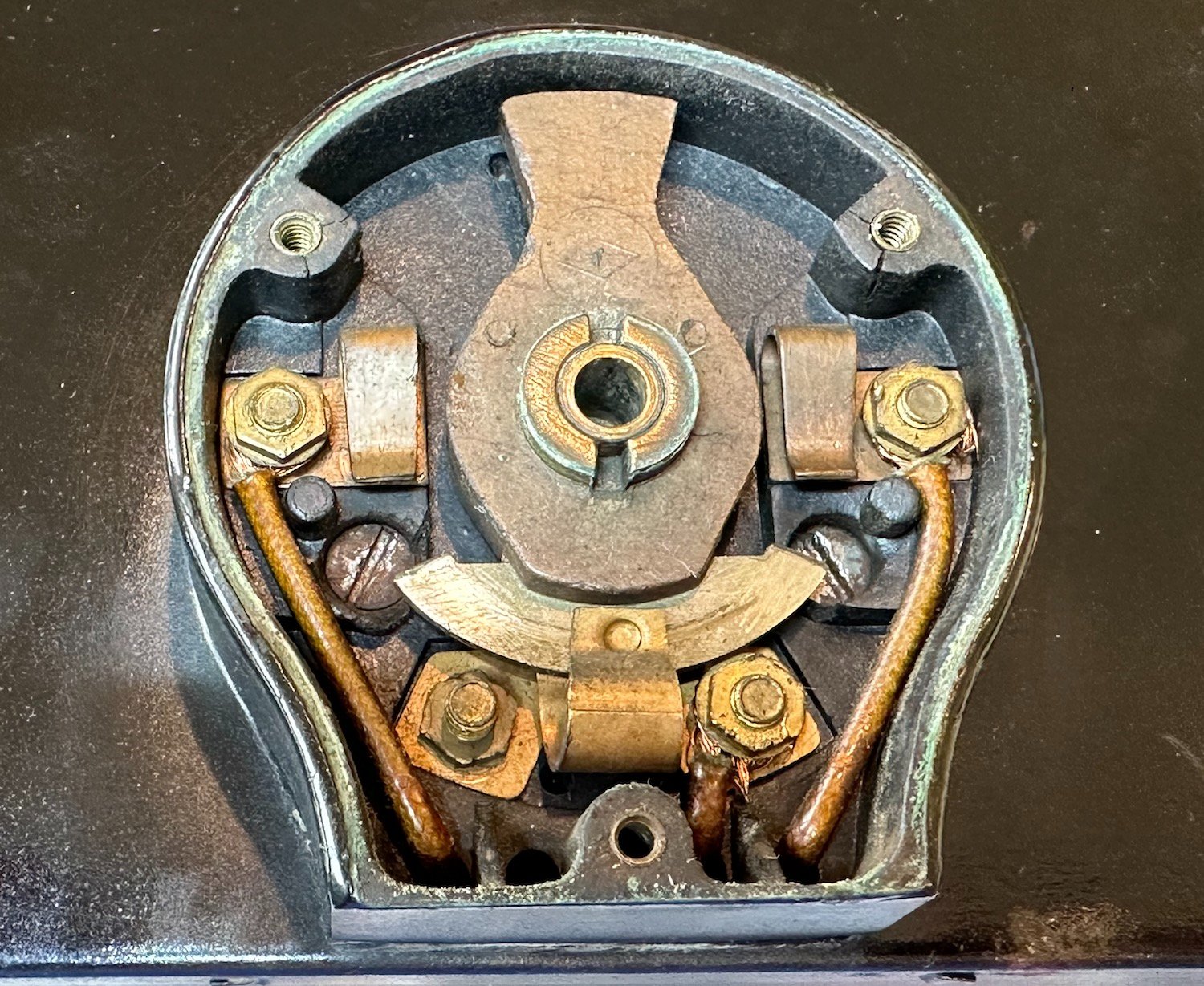

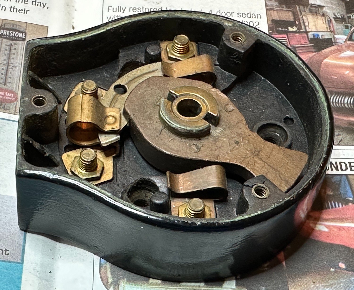

This past weekend I pulled the coil box out of the '14 and had a look at the switch. It all looks OK to me. It moves easily and seems to have good mechanical contacts as far as I can see. I'm not sure how to use the meter to check electrical connections, it probably has a continuity check someplace but I don't know how to set it for that. I can check battery voltage so possibly a battery might be used to check it that way.
What can be done now while it is apart to make sure it is in good shape for the next 110 years?

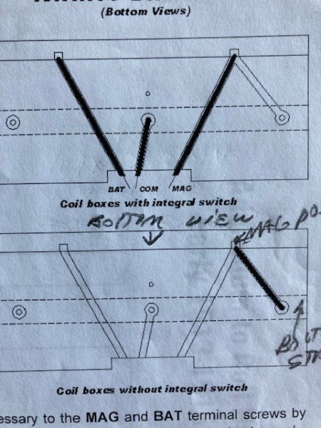

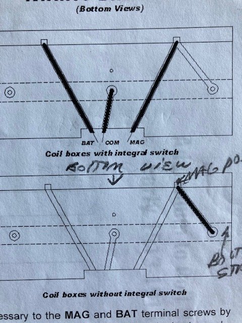

Paul, you probably know all of this stuff but this is the coil box wiring diagram I used on a Fun Projects rebuild. Found it useful for the continuity checks. Ignore my notes on the diagram that how I work when I do this stuff.

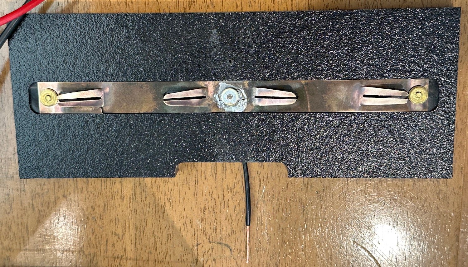

You can test the switch without opening it. With the switch turned to BAT touch one lead of your tester to the battery terminal on the back of the box and the other lead to the power strip across the inside bottom of the box. If current flows between those points, you're good to go. Switch to MAG. Do the same test between the magneto terminal and the strip. Current getting through? Yes? Fine. With the switch set to OFF do the same two tests. No current getting through? Switch OK.

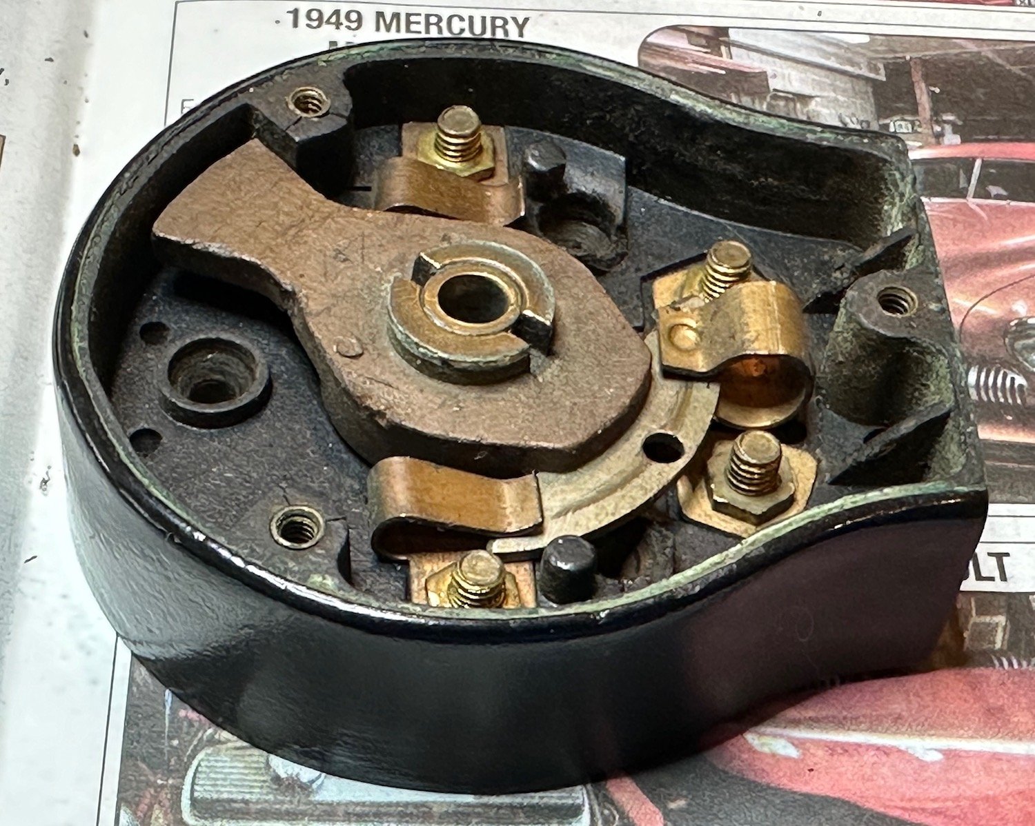

You may wish to put in a new white rubber strip on the back side. I don't know if Lang's has them or not? We used to get them from McMaster Carr.

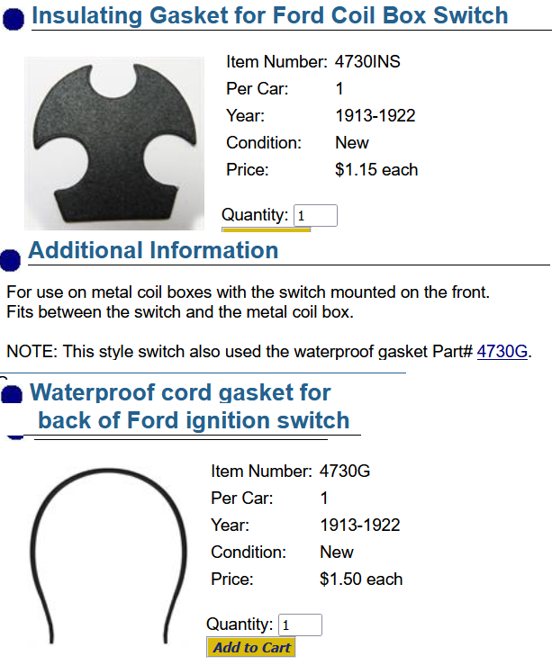

Lang's has it but author of post may not. Shows only 4730GOriginal Smith wrote: ↑Tue Aug 06, 2024 1:00 pmYou may wish to put in a new white rubber strip on the back side. I don't know if Lang's has them or not? We used to get them from McMaster Carr.

Not knowing how to test the circuits I decided to take it apart & look at things. There is a mechanical part to electrical systems & my eyes might spot a loose terminal, frayed wire or broken or weak spring. I found nothing like that, it all looks sweet.

Thanks also for the gasket info. The paper gasket is there and in good shape but the arced flexible one was missing & I had no idea about it. I'll see if I can get one on order.

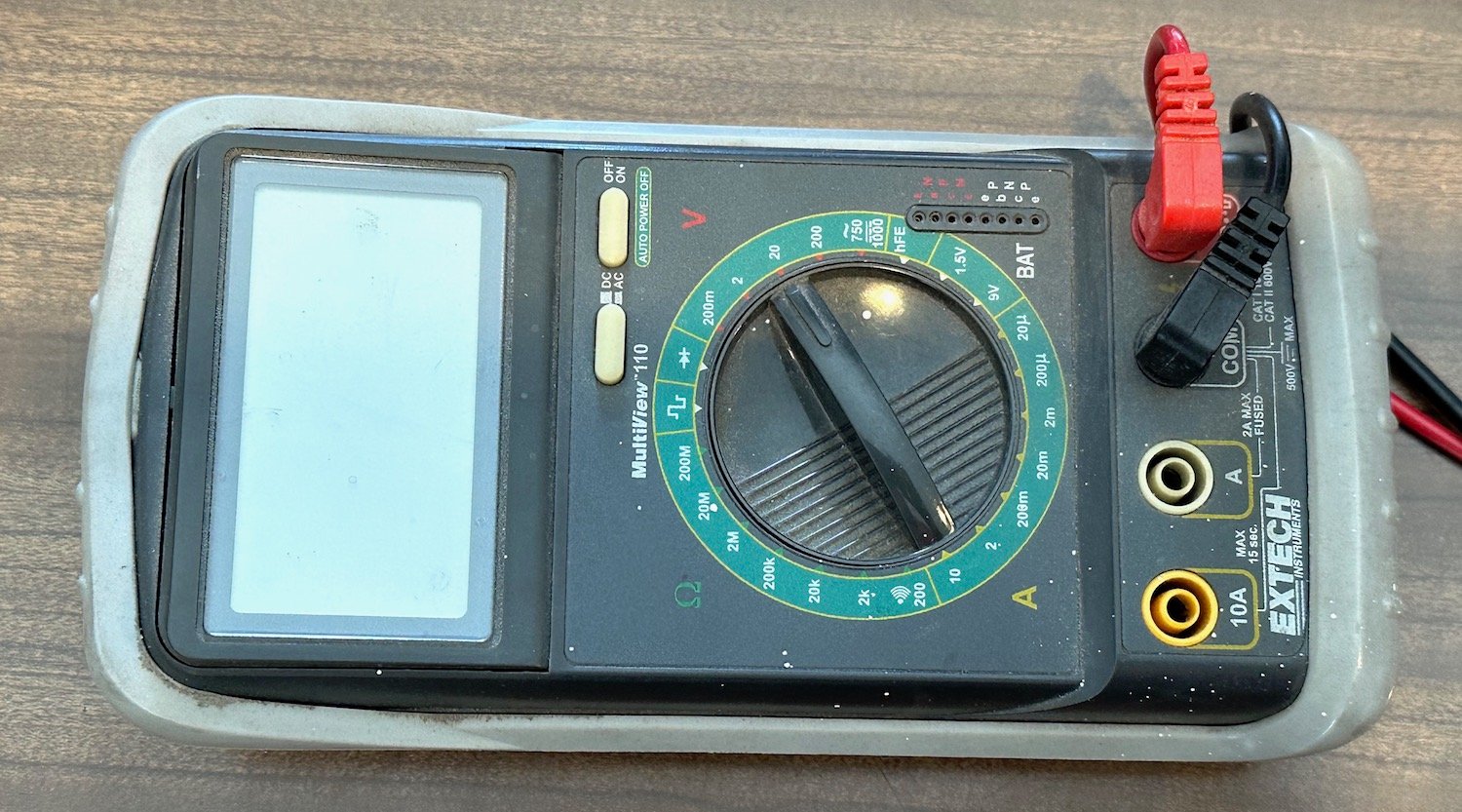

For continuity, set your dial here. The meter will give an audible "beep" for a circuit with continuity.

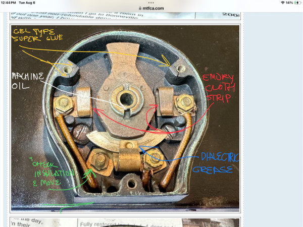

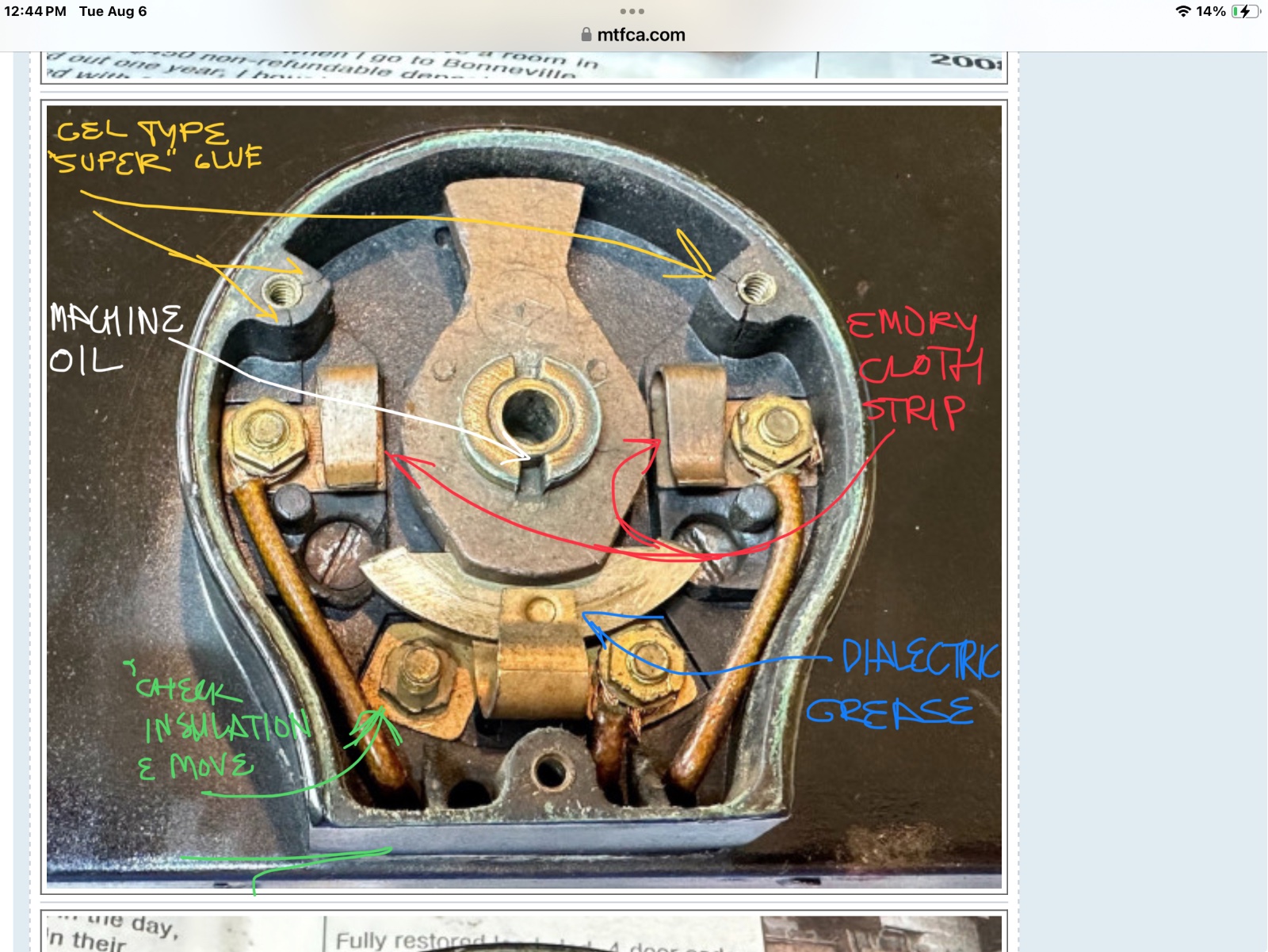

Those are beautiful mechanisms and it seems like yours is in very good shape and already very clean. As per your initial post though, I labeled and described what I would do to any type of switch like it from the same period.
With extremely judicious use of these products and an extremely gentle approach to the repairs it will be usable far into the future. Apply the tiniest amount of glue and wipe off any excess and plug the holes with something to ensure no glue makes it into the threads. Let it sit overnight. Use less than a drop of oil on the rotating assembly with a probe and wipe it off thoroughly after some rotation either way. Polish the brass face and use just a thin strip of emery cloth to polish the inside of the folded contacts. Swab with alcohol or other cleaner that leaves no residue. Put the tiniest drop of grease on the slider and wipe off any excess. The new paper gasket will likely benefit from some light sanding with an emory board as any ill fitment could crack the covers when tightened. Double check that the wire cover is intact and no contact is being made where there’s rubbing. Clean the threaded inserts with a swab and some penetrating oil and remove any excess. Remove, clean and re-tighten to snug all the fasteners and then “send it”. Any disagreements with this advise or more specific treatment would be most educational as I’ve never actually owned a coil box switch like this. Just basic service methods for continued use of any mechanism of its age as I learned it, hope this helps. -Chris in Boulder

Thanks Jerry for your advice on setting the meter. With it, I was able to test the new coil box bottom and then the switch itself. I'll keep that meter on the workbench to test the coil box build as it goes and then when ready to install test the bottom strip with the BAT & MAG posts as Steve suggested.
Chris, thanks for the tips on improving the switch. The wires will be the new 18 gauge ones supplied in the plastic wood kit. The cracks in the mounting screw bosses looked dangerous and I'll be glad to reinforce them.
