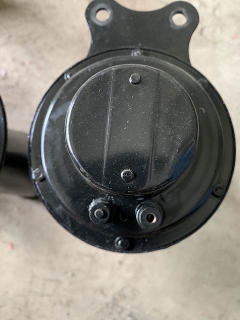

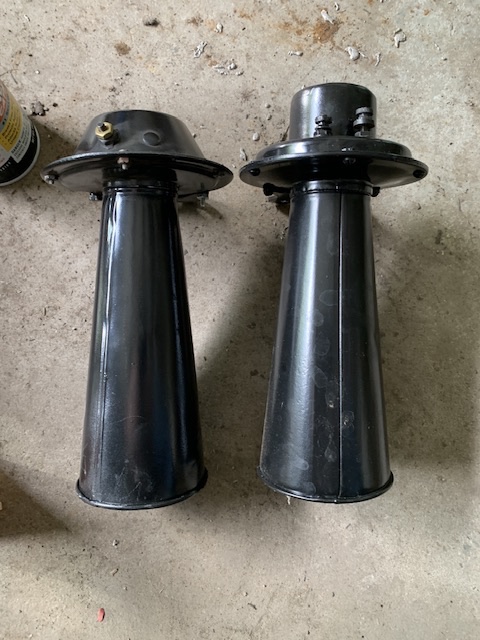

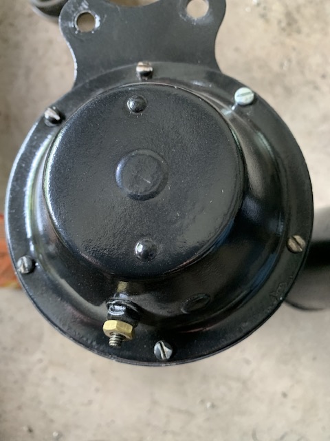

If a horn only has 1 terminal it be most likely a battery horn ?
I have two horns. One has 1 terminal the other has 2.
I know the 2 terminal horn is mag, so the other is battery?
How about 6 volt horn on 12 volts?

From your pictures of the two horns, I would say that they are both mag horns because of the motor housing shapes. The battery horn would have a longer motor housing. The two wire horn was for a wood firewall car and the one wire horn was for a metal firewall car that was sold new as a non-starter car because the metalfire wall to T frame made the ground connection.

Thanks for info. I may just change my 16 to a later battery hour. Mag will only work with engine running. Dan

If there's an adjusting screw in the center of the diaphragm it's a mag horn.
