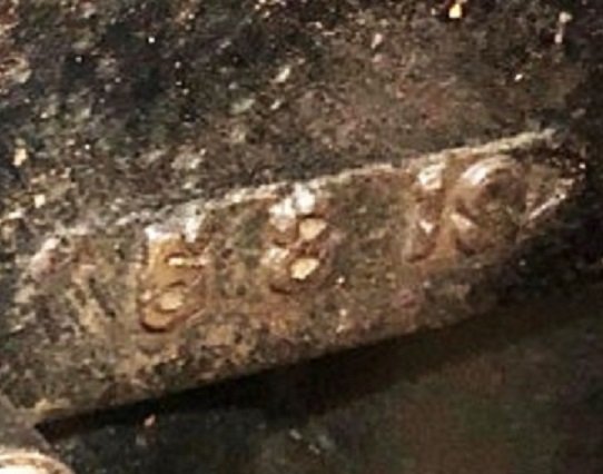

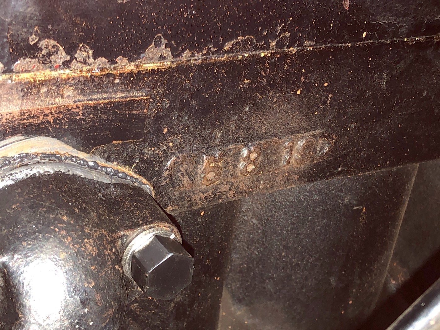

Gee, I'm not going to argue with it. There is no discernable serial number but the casting numbers sure look like it says 18. Is this wrong?

I see an opening, like a 9.

Post a photo of the carburetor side - easy enough to verify a starter block OR not !

Wow! May 8, 1919. Exactly 74 years to the day before I got married. And I turned 74 last Sunday. Serendipity!!
Posts: 3743
Last Name: Wrenn
Re: Updated website : Starters, generators and Voltage Regulators
Post by TWrenn » Fri Aug 23, 2024 5:43 pm
speedytinc wrote:
Fri Aug 23, 2024 4:57 pm
5-8-19. May 8, 1919
Yep. Almost clear as a bell actually!

I could be a 9, but if so, its a poorly designed 9. The car has a generator. Too bad there is no serial number that I can make out.

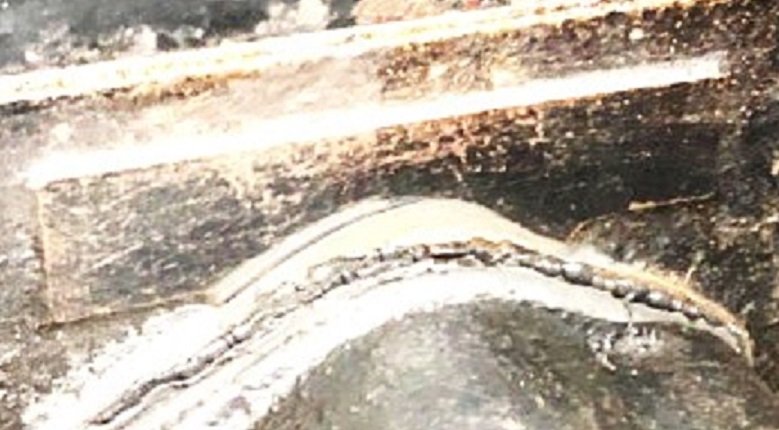

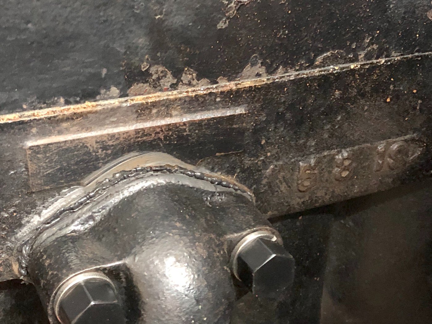

From the photo of the block it would appear that the original engine number has been machined off. The mating surface of the side outlet appears proud of the engine number boss, rather than on the same plane as usual. Neat work to do the machining around the side outlet.

A closer look
